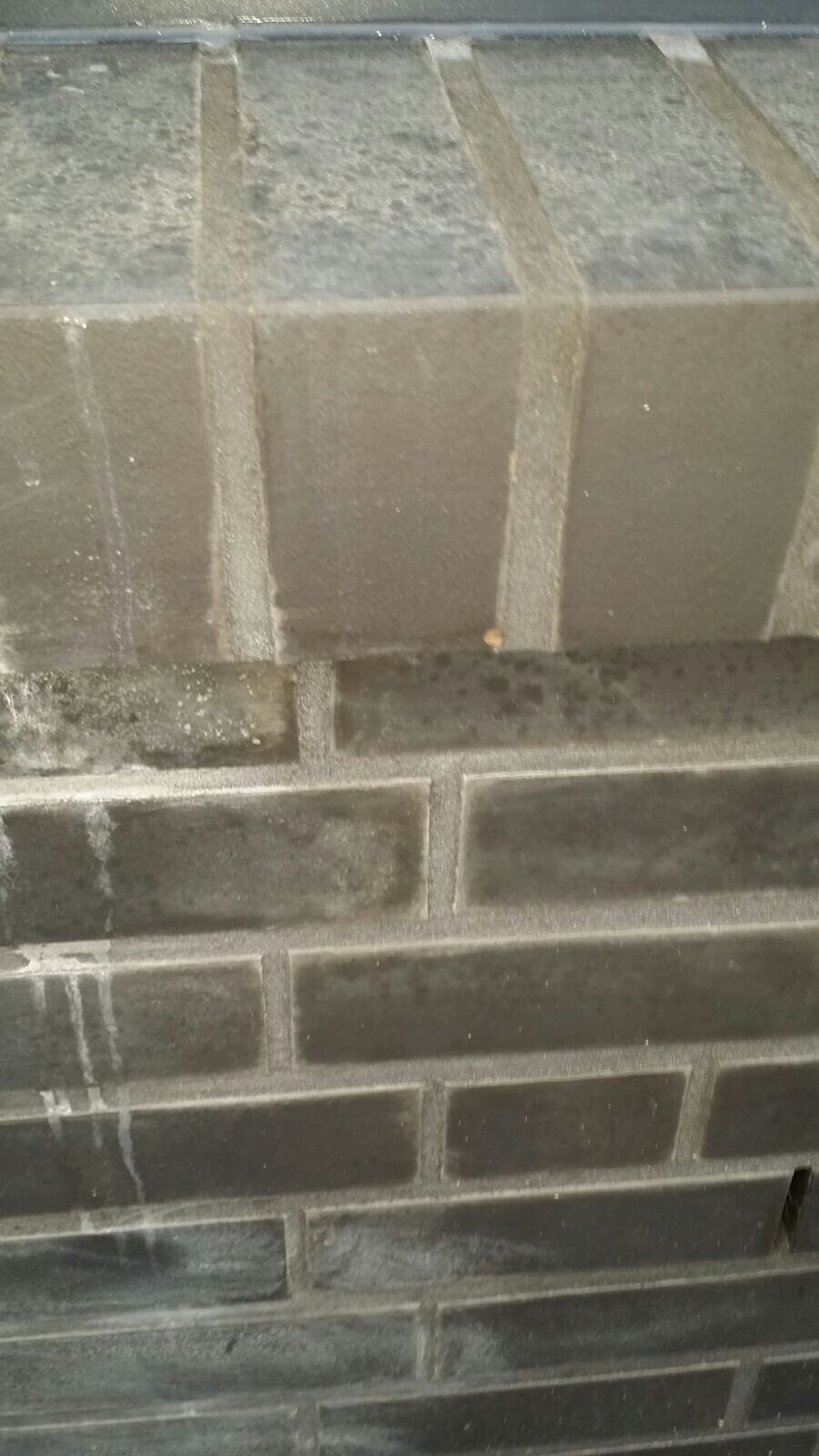

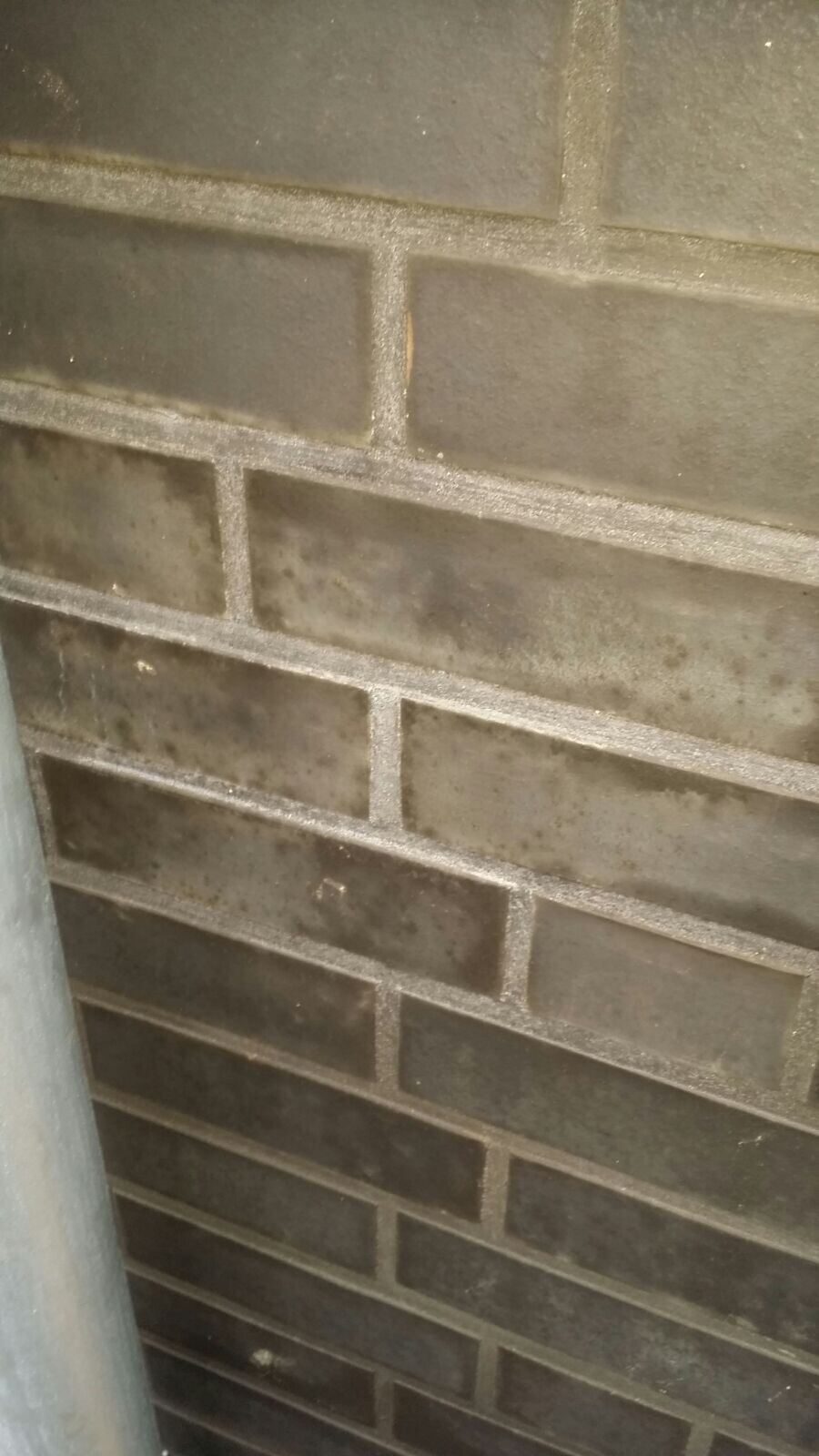

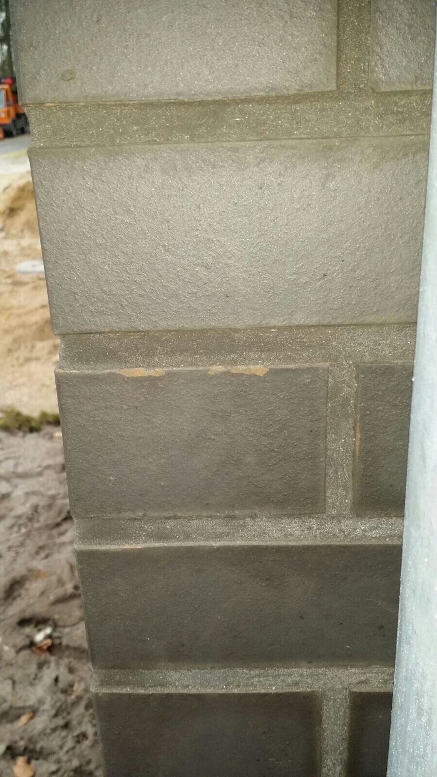

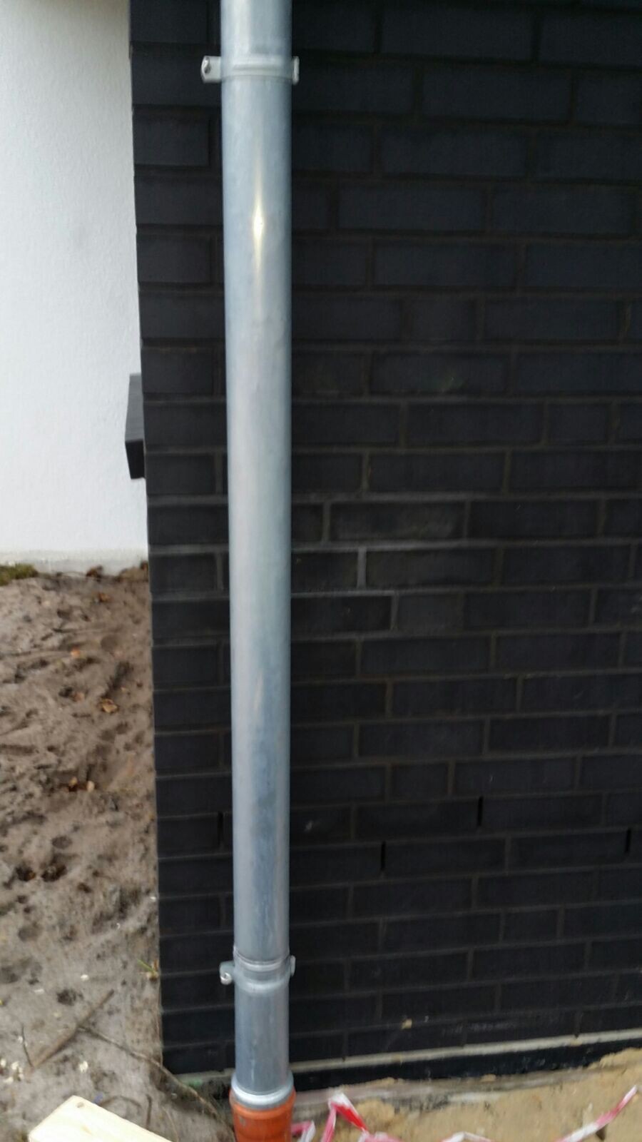

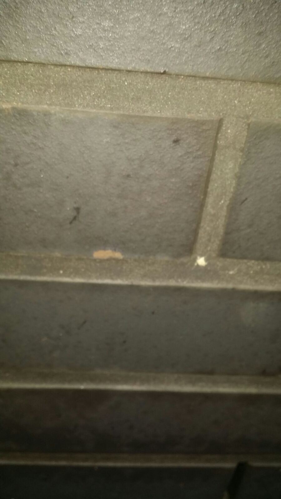

Good evening,
We are currently building and not yet living in the house. Now our house has experienced its first frost, and when I was at the site yesterday, I was shocked. The black coating on the bricks is flaking off all over the house. We have Röben bricks, Portland model. This can’t be true. Why is this happening, and especially, it certainly can’t stay like this.
Also, I noticed a strange spot. What could that be?
We just had an inspector visit, unfortunately before this happened. Every visit from the inspector costs us €600 plus €360 for a report. Of course, we would consider calling them again, but maybe someone here has an idea. Pictures are attached.
Thank you very much!

tomtom798 Jan 2017 20:50
Well, I would say cheap facing bricks! Colored on the surface but not fully colored through. It’s the same with paving bricks.
I’m curious to see how this will be resolved.

tomtom799 Jan 2017 09:04
What can I say, cheap does not always mean affordable.
You have a problem here; these are the chips and flakes that become visible. I have no idea if this happens with all facing bricks. Maybe some professionals will chime in and give you some advice.
