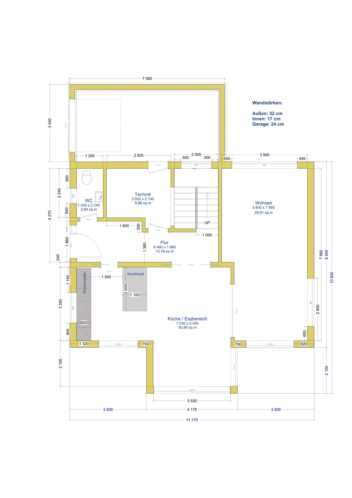

The house is intended to be used as a weekend/holiday home, so that both we (a young family) and our parents can stay there, or up to 8 people (including children) at times. Therefore, there are 3 bedrooms with two sleeping places each, plus a sofa bed in the living room. However, this sofa bed is expected to be used only occasionally.
It must be noted that the house needs to be partly built into a slope. For this reason, the southeast corner features correspondingly tall windows. We think this south-facing wall is well suited for the living area, for example for TV placement.
Plot size: 790 sqm (8,500 sq ft)
Slope: west-facing slope
Site coverage ratio: 0.4
Floor area ratio: 0.8
Building envelope, building line and boundary: existing, the project fits within
Edge development: no statement
Number of parking spaces: 1
Number of floors: 1.5
Roof type: gable roof
Architectural style:
Orientation:
Maximum height / limits: none
Owners’ Requirements
Architectural style, roof type, building type: modern cottage style
Basement, floors: no basement, 1.5 floors, upper floor with 150 cm (59 inches) knee wall measured from the finished floor level
Number of people, age: 2 adults, 2 children
Space requirements on ground and upper floors:
Office: family use or home office? family use / leisure
Overnight guests per year: average 4, maximum 8
Open or closed floor plan:
Conservative or modern construction: mixed
Open kitchen, island: with kitchen island
Number of dining seats: 10-12 (large table)
Fireplace: yes
Music / stereo wall: no
Balcony, roof terrace: both (south balcony and west terrace)
Garage, carport: garage
Other wishes / special features / daily routine, also explaining why certain things are included or excluded:
Who designed it: own design
What do you like most? Why? The sanitary areas are compactly stacked and located next to the utility room, also situated in the northeast corner. Spacious combination of kitchen, dining, and living area. Good use of space under the stairs. Bedrooms upstairs are nicely sized. A compact sauna fits in well.
What do you dislike? Why? Perhaps the hallway on the ground floor is a bit narrow? Utility room a little small?
Estimated price according to architect/planner: -
Personal budget including fittings: -
If you had to give up something, which details or design features
-could you live without:
-could you not do without:
Why did the design turn out this way? For example:
Standard design from the planner? We tried to consider everything so that it pleases us
A mixture of many examples from different magazines...
In your opinion, what makes it particularly good or bad?

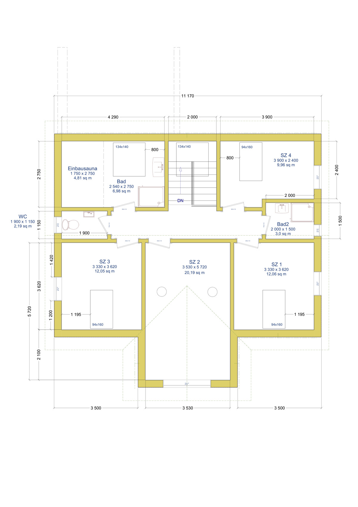

The circles in the upper floor plan represent Velux skylights.
The house will be built with an exposed roof truss.
The front door is located on the north side, the balcony on the south side.

I agree: smaller bedrooms with their own shower and toilet, so there is still a room left for a sauna with an additional shower. A nice common area for everyone. I would try to create another bedroom downstairs for the parents, who might not be able to use the stairs anymore at some point.
Hello, I have designed new floor plans again.
We now have a second small shower bathroom upstairs, and the toilet is separate. As a result, there is no longer a shower downstairs. The utility room is also larger, which makes a lot of sense. Additionally, we have added a 4th bedroom upstairs.
I would like to keep the sauna on the upper floor.
What do you think?
What do you think?
