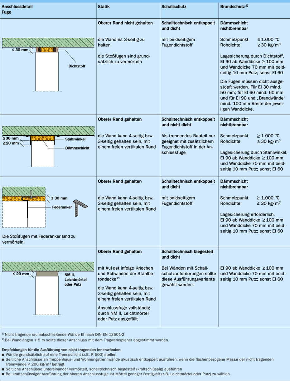

WilderSueden schrieb:
Probably non-load-bearing. To make sure the wall doesn’t accidentally become load-bearing, it is either fully built only after the slab is poured, or the top course is left out and added later.
Sorry, but you rarely see such nonsense... just had to point it out. But it was funny.
WilderSueden
7 Aug 2023 22:27
I don’t know how the work was done on your construction site. But a non-load-bearing wall must not be fully built when the ceiling is installed because it should not extend all the way up to the ceiling.
Technical drawing of a wall connection with joint, sealant, and insulation
