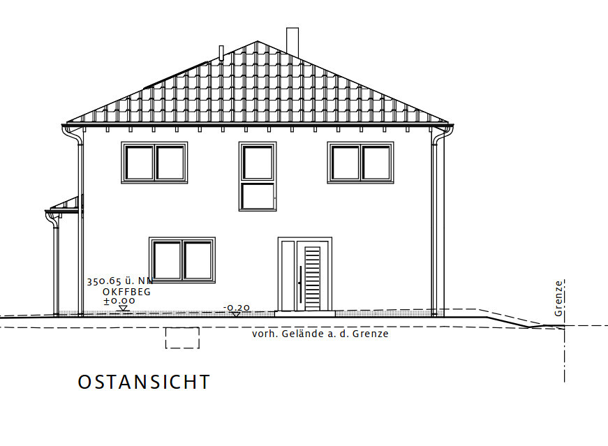

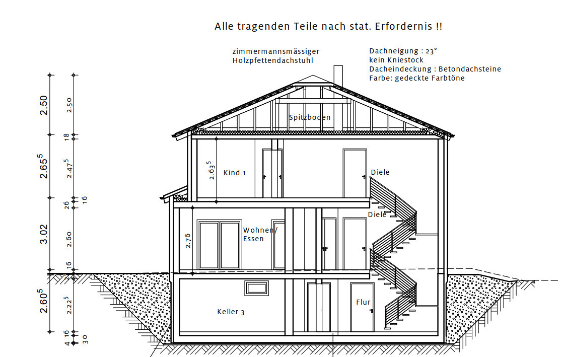

Hello, 25° might be a bit too much; we have 23° and I’ve attached the cross-section. A steeper roof would look somewhat too “tower-like.”
Andreas

@andimann thanks for the clear and informative details :-)
