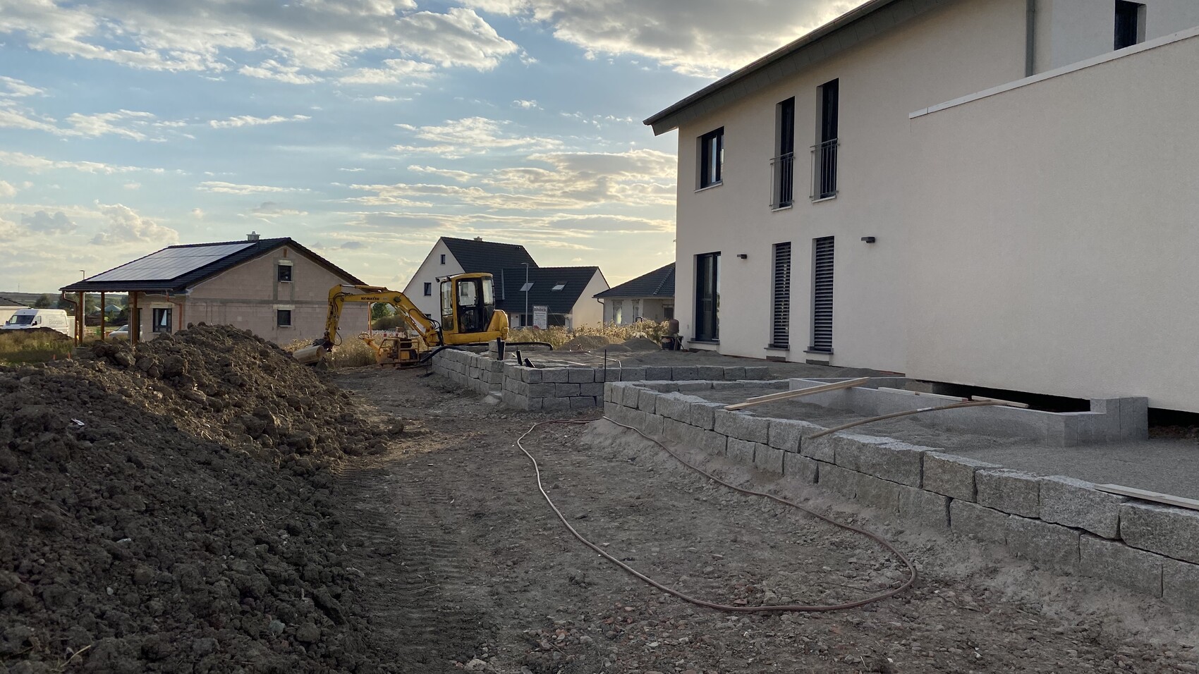

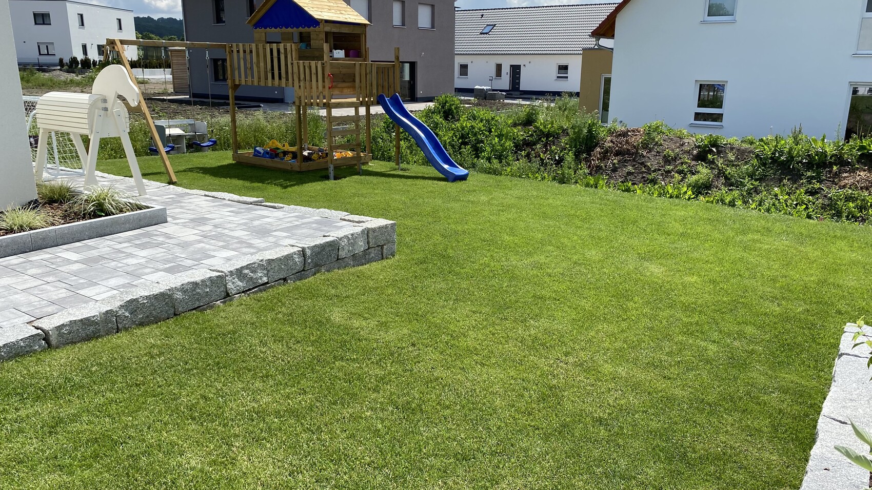

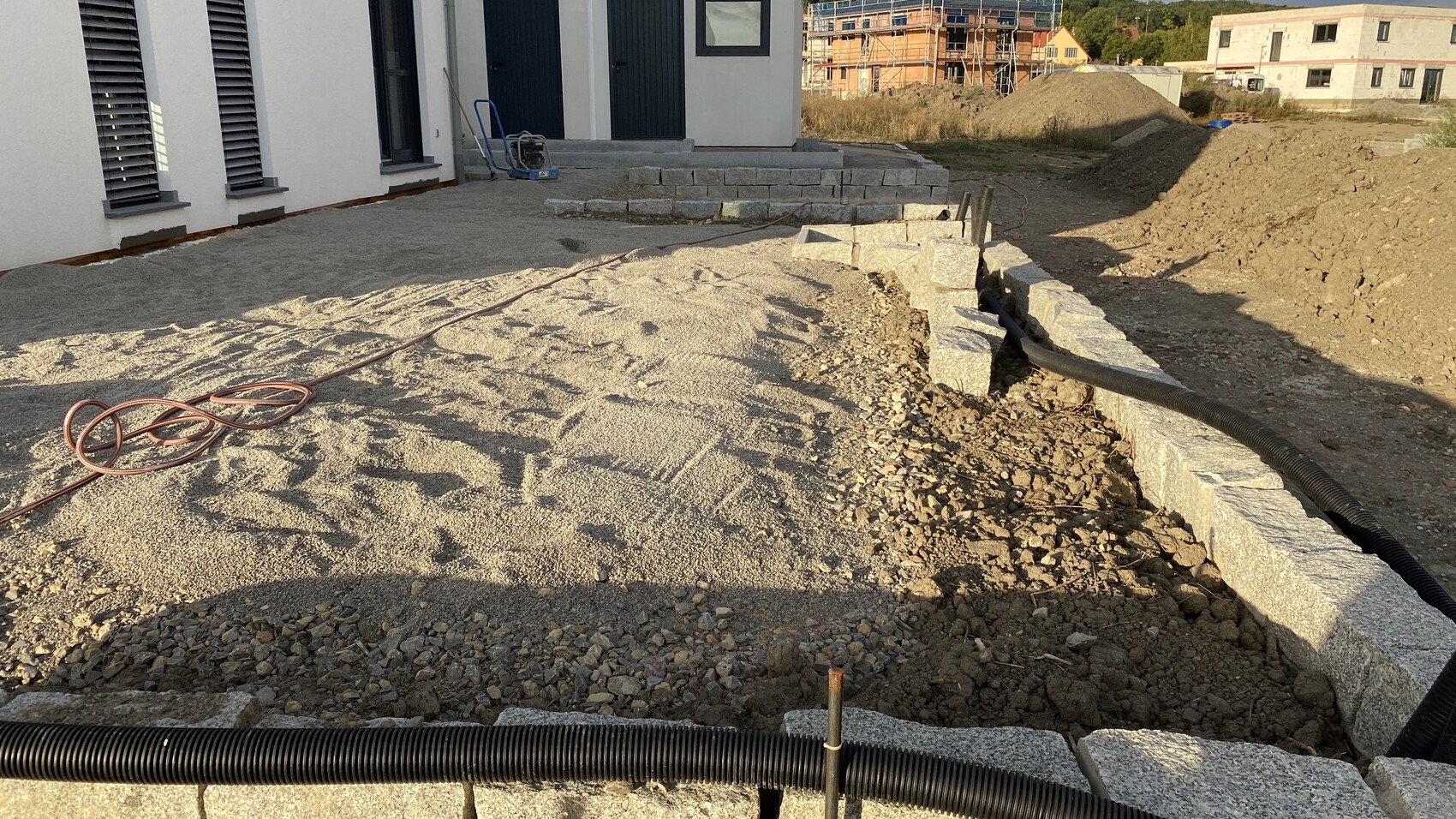

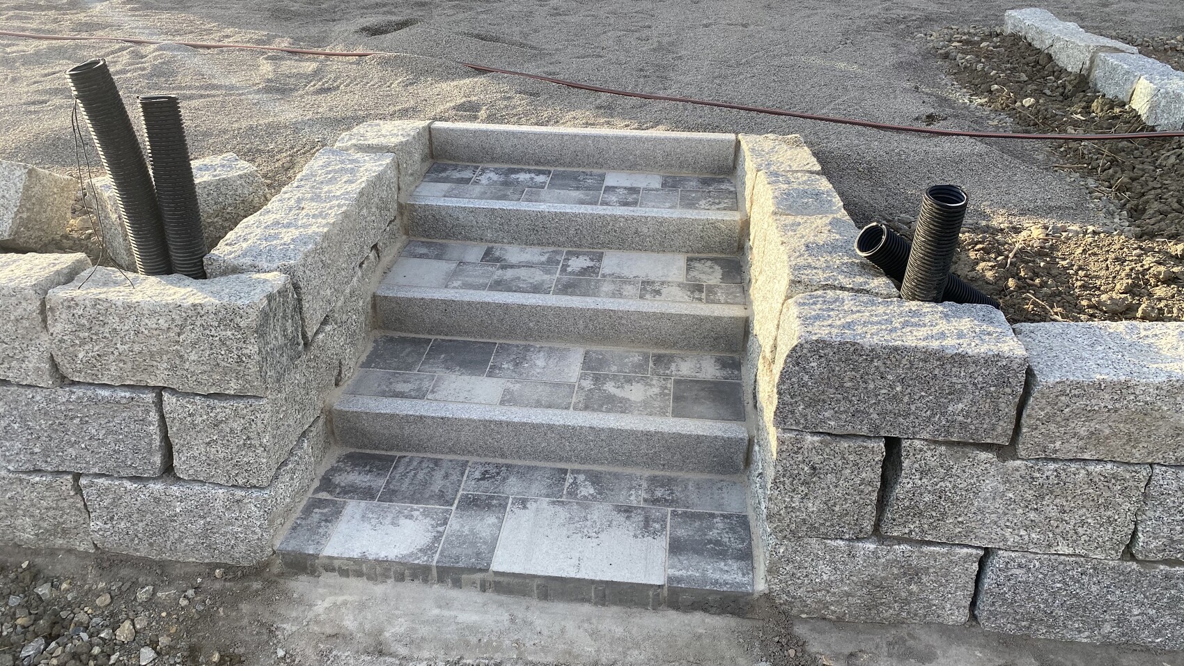

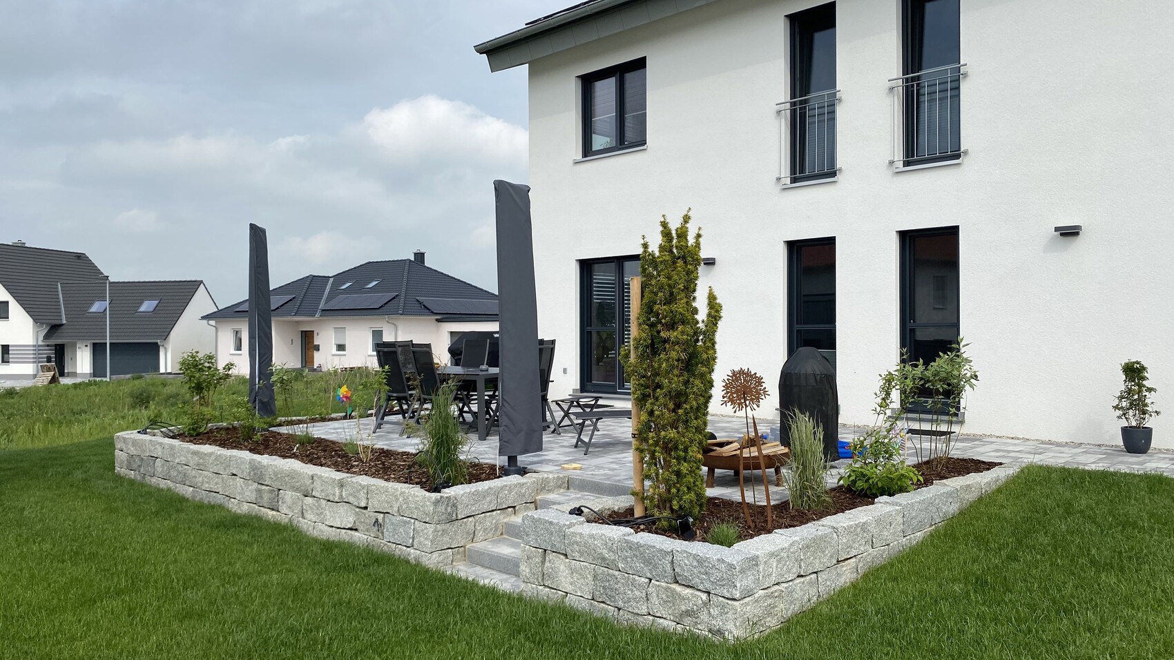

borderpuschl29 Jun 2021 14:48H
hausbauer2129 Jun 2021 20:02Looks great…
Where did you position the foundation? At the outer edge of the terrace?
How did you cover the formwork blocks?
Nice-Nofret schrieb:
will continue to settle, Hello Nice-Nofred
If it is properly compacted, there will be no settlement.
Steven
hausbauer212 Jul 2021 14:00Did you fill the wall from behind with concrete, or did you simply put in gravel and compact it?
