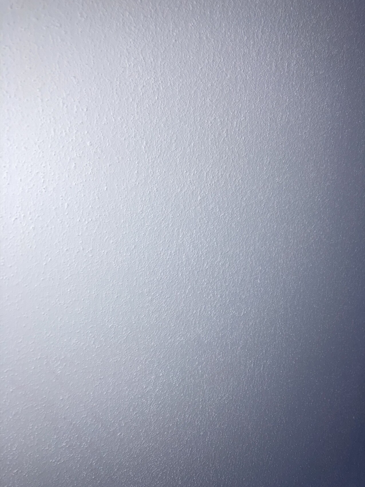

This is the result after one pass; we actually don’t want much more texture than this 😀 By the way, this is the fine

Then you have to paint – full coverage can’t be achieved with just one coat. A second coat won’t give you more texture either, only a more even texture (which is especially noticeable with medium or coarse finishes).
