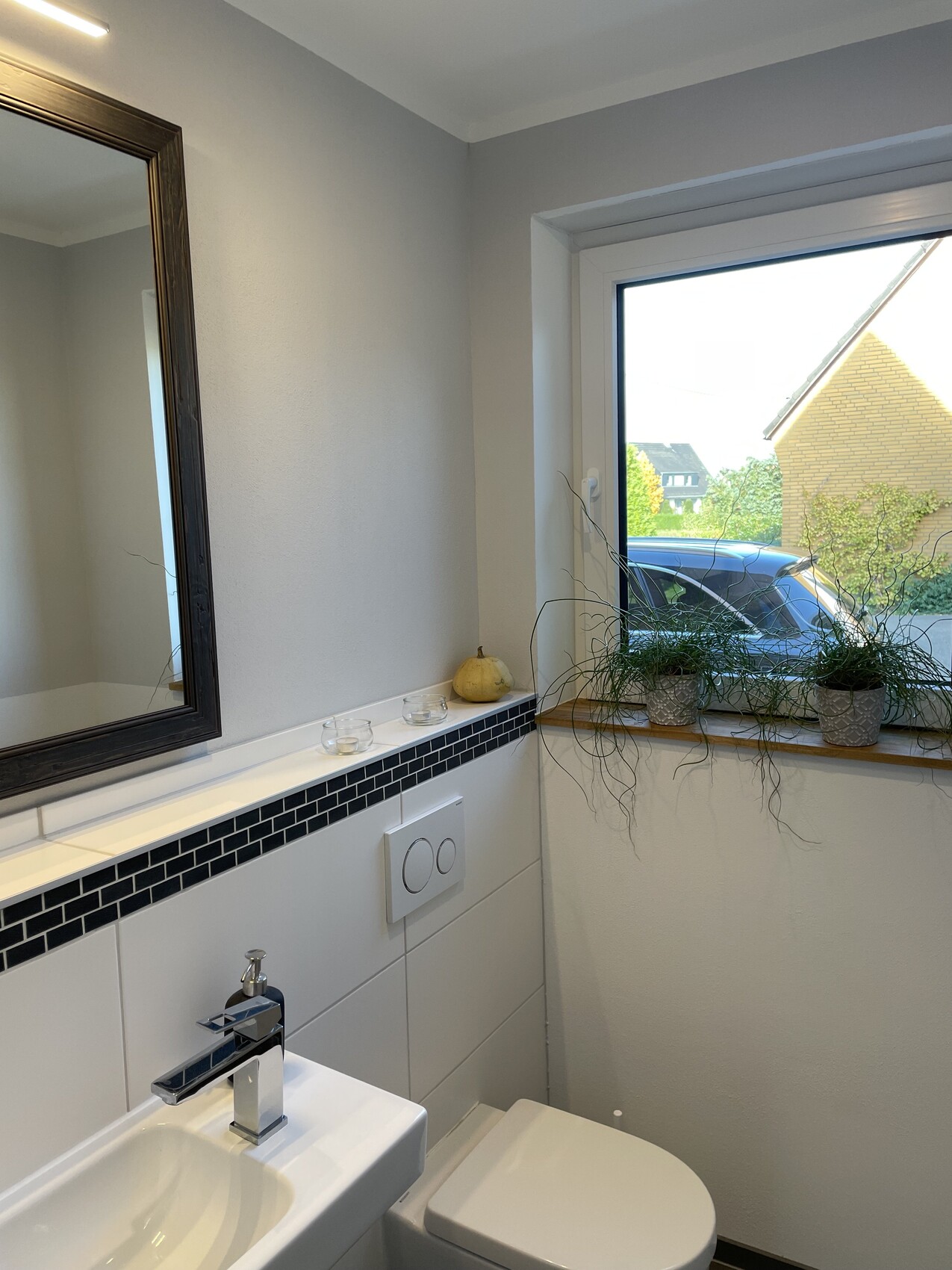

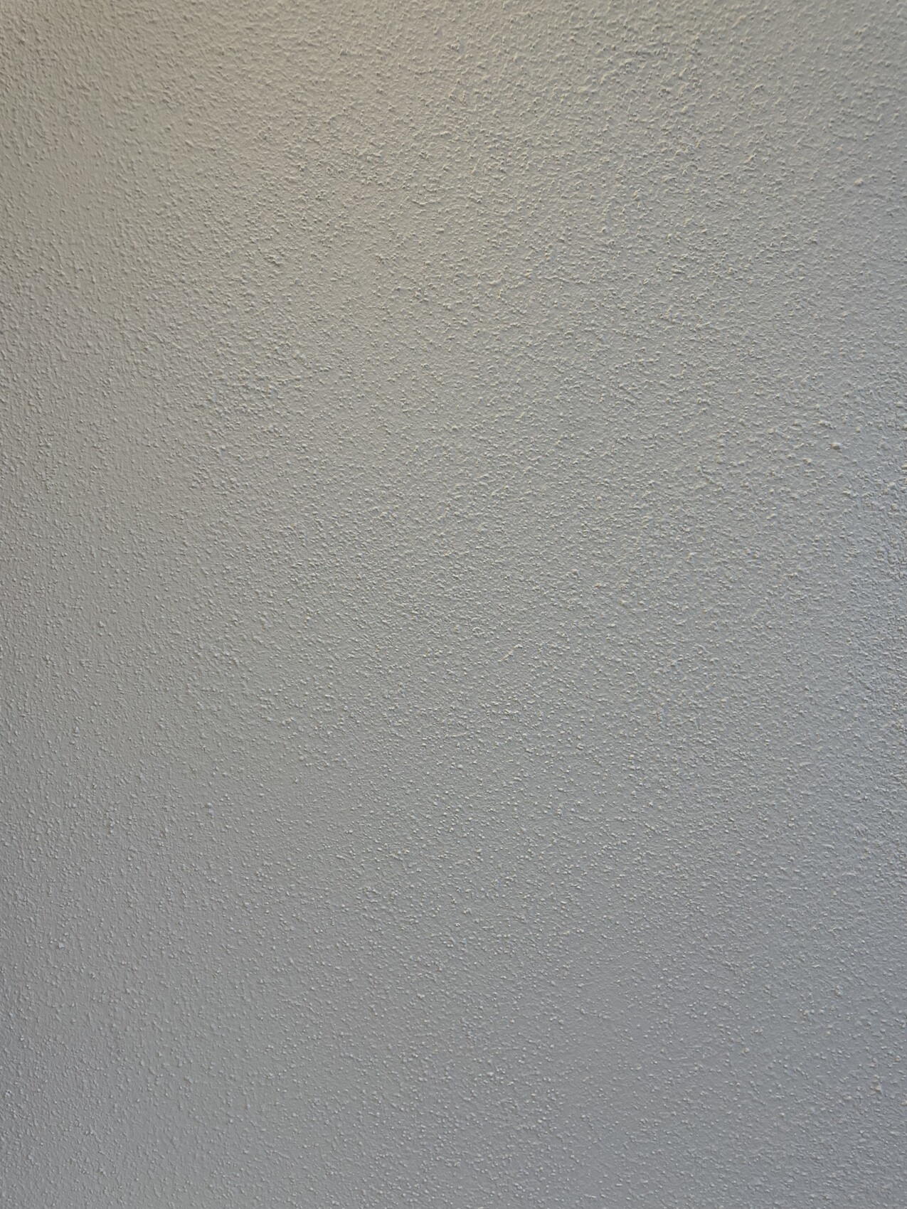

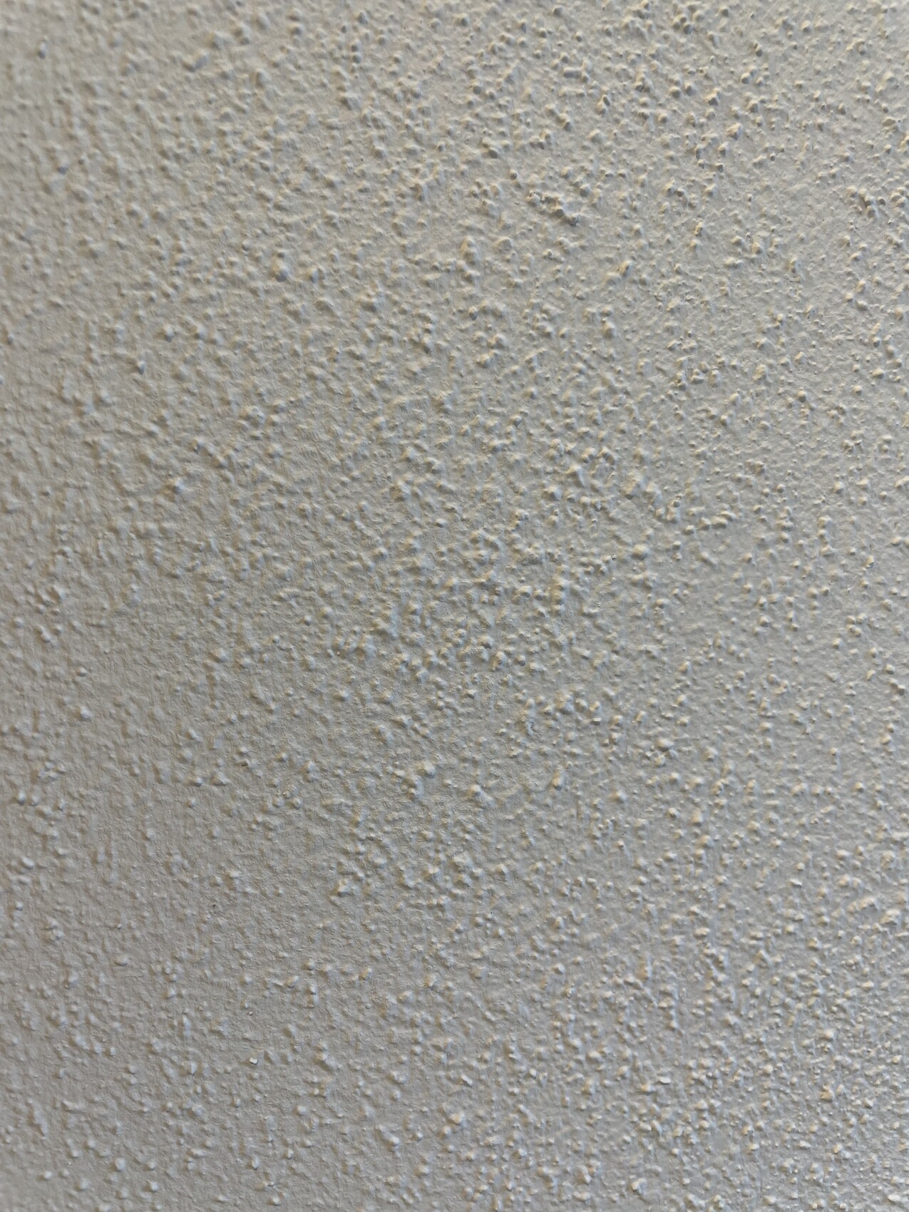

Ok, great, thanks! I’ll go ahead and order 10 buckets. Could you maybe share a picture of the medium one? We are deciding between fine and medium. Thanks a lot.
SaniererNRW123
26 Oct 2022 11:02
Bauenaberwie schrieb:
Could you maybe take a picture of the medium texture? We’re deciding between fine and medium. Many thanks.
This is how it looks in my case. Overview photo, about 7cm (3 inches) from the wall, about 30cm (12 inches) from the wall.
Small bathroom with sink, toilet, mirror; windowsill with two plants and a pumpkin.
Close-up of a light gray wall surface with fine texture.
Close-up of a rough cream-colored plaster wall with irregular elevations.
