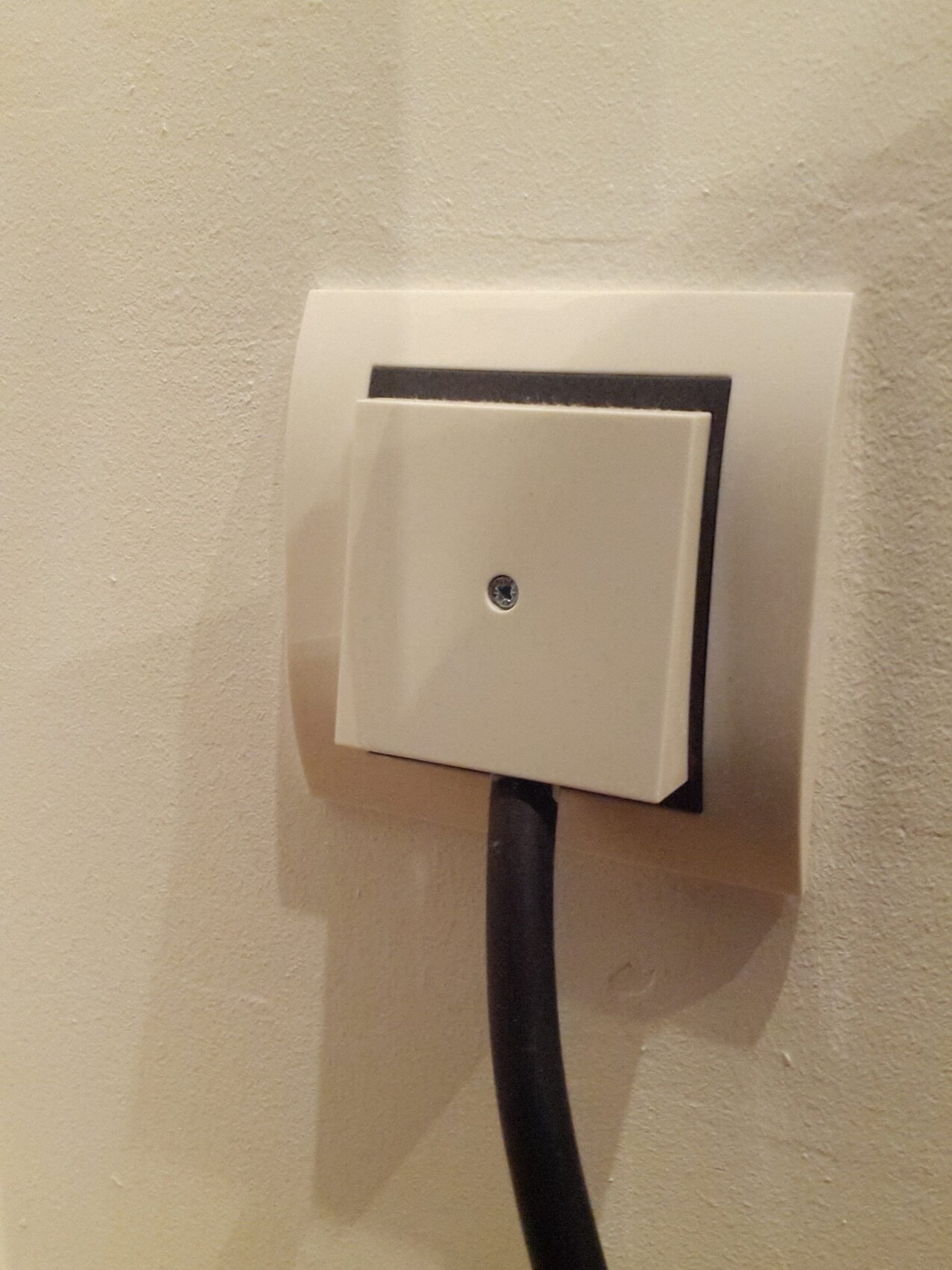

Weitling09 schrieb:
Thanks for the picture. What are these types of outlets called? Good question, it’s from the Gira switch range. It’s a recessed outlet pointing downwards; for example, you could also install LAN sockets there. Unfortunately, I don’t have the exact article number from the electrician.
