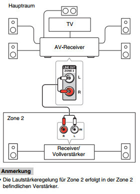

When I look at 2-zone receivers (for example Onkyo TX-NR525 or Yamaha RXV577), I sometimes see RCA outputs for Zone 2!? What do I do with those?

When I look at 2-zone receivers (for example Onkyo TX-NR525 or Yamaha RXV577), I sometimes see RCA outputs for Zone 2!? What do I do with those? In the area between receiver/wall or speaker/wall, I would skip using connectors. Have the necessary speaker cables installed and simple wall outlet boxes mounted. Then the speaker cable comes out of a wall box and goes straight to the receiver and to the speaker. In the dining area, you can opt for a type that accepts banana plugs (if you only want speakers temporarily placed there, otherwise like in the living room).
Zone 2 = requires a second amplifier or power amplifier (see the TX-NR525 user manual).
Alternatively, you can choose an amplifier with more power outputs. Then you have 5.1 in the living room, and the last two power outputs in the dining area – but nothing remains for outdoors. For three zones, it gets even more complex and costly.

I wasn’t aware that a second amplifier would be needed for Zone 2, that’s unfortunate and actually a dealbreaker! I only wanted small wall speakers in the dining area.
How about Yamaha’s “Zone B”? Would regular speaker cables be sufficient there?
