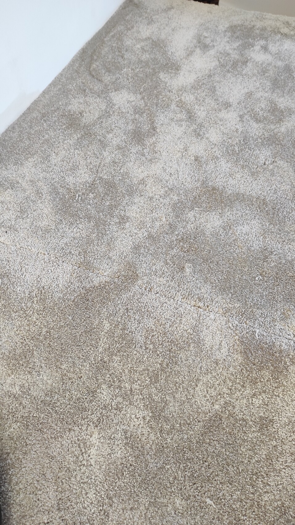

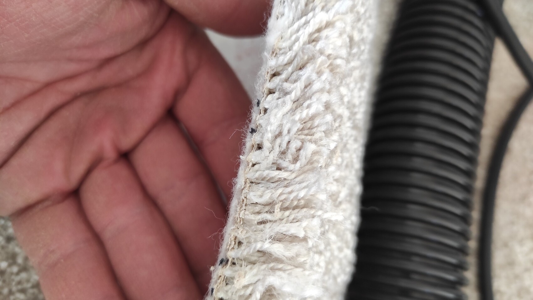

I uploaded some pictures of the carpet.
Close-up of a white carpet edge with fibers, hand on the left, black spiral cable conduit on the right.
Close-up of a beige carpet floor with fluffy fibers.

I would definitely advise against using edge reinforcement on high-pile carpet! The term "making things worse by trying to improve them" would certainly apply here. If both textile floor coverings are installed in the same direction according to the manufacturing grain, the long pile can be easily brushed over the edges without problems. But edge reinforcement? Please, no! It won’t achieve the result you’re hoping for.
Regards, KlaRa
