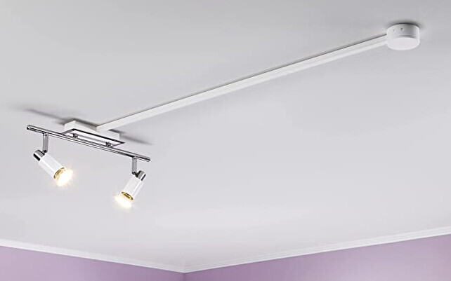

There are small plastic cable ducts that run along the ceiling. These are less noticeable if both the ceiling and the duct are white.
With suspended ceilings, it’s easier to reposition the cables, but with concrete ceilings, this type of solution is probably your only option.
Modern ceiling light with two spotlights on a track, white ceiling, purple wall.

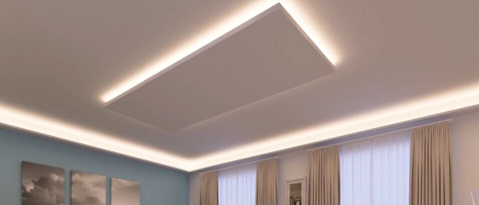

Installing a coving that covers the entire area from the outlet to the desired lamp position (and possibly symmetrically on the other sides of the room) might be less work than fully lowering the ceiling and can serve as additional indirect lighting.
For example, something like this:
Modern living space with rectangular ceiling light, LED lighting along the edge and blue wall accent.

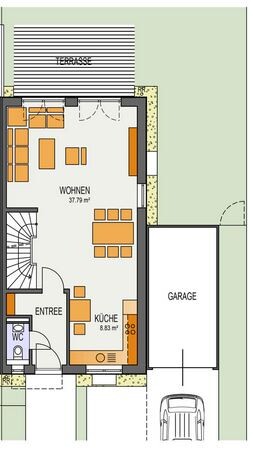

My question would be: do you think this would fit into our floor plan?
2D floor plan of a house with living room, kitchen, entrance area, and garage.

I don’t understand the question. A suspended ceiling is a matter of ceiling height, not floor area.
