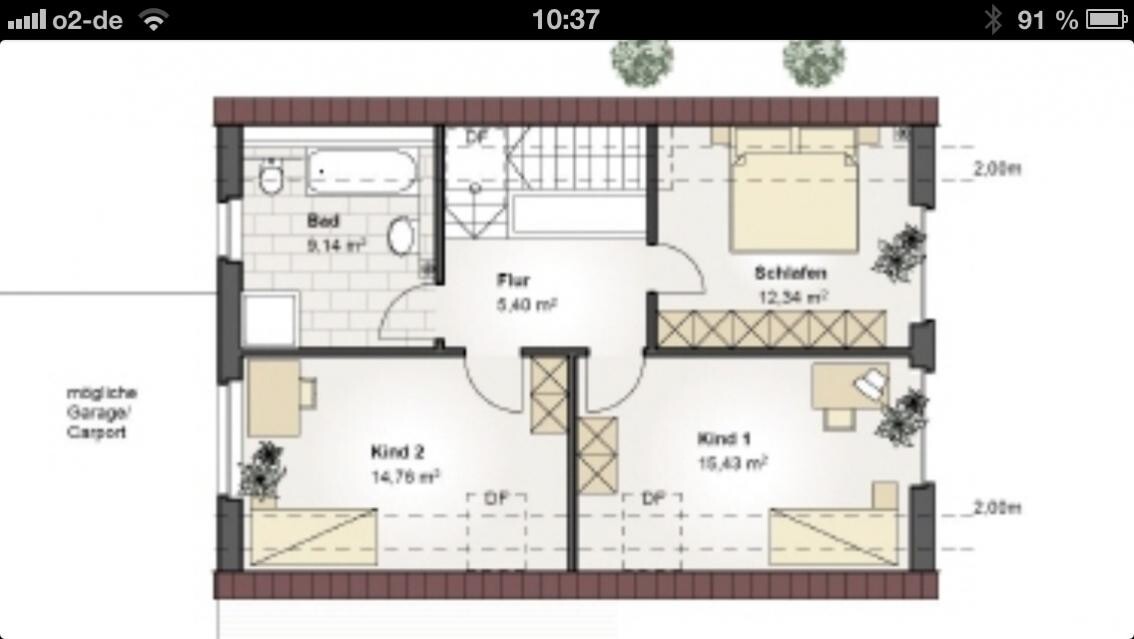

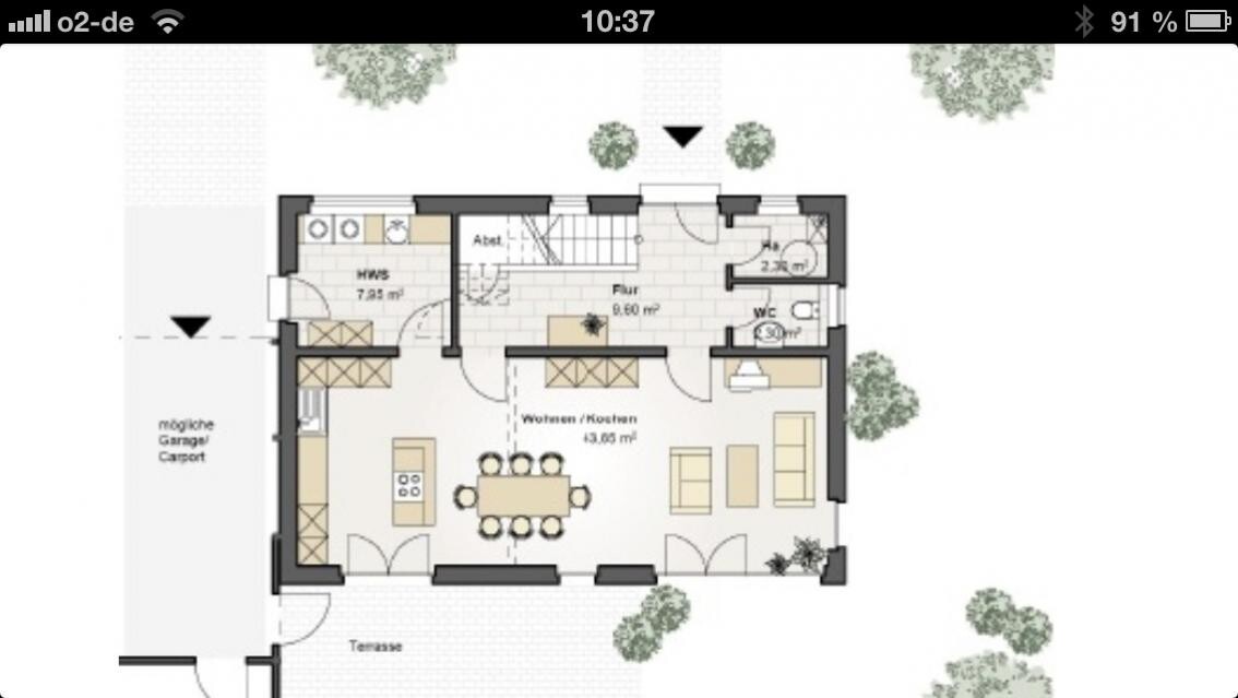

Hello, we are about to build a house. This is a proposal from the architects on how we could do it. We will build with a basement, so the utility room on the ground floor will be removed and relocated to the basement. The entrance area will be mirrored so that the office is on the right instead of on the left as it currently is in the floor plan. There will be a lockable door from the carport into a pantry, which then leads into the kitchen. Also, the guest toilet will be located on the left side of the floor plan. I hope you can understand what I mean. We want to separate the kitchen from the living room with a large sliding door. There will still be a passage from the hallway to the kitchen. Do you see any suggestions for improvement? What could be done better? What would you have done differently? Sorry that I don’t have the exact floor plan according to my ideas to share—I don’t have one on hand at the moment.
It would be great if you could share your opinions.
