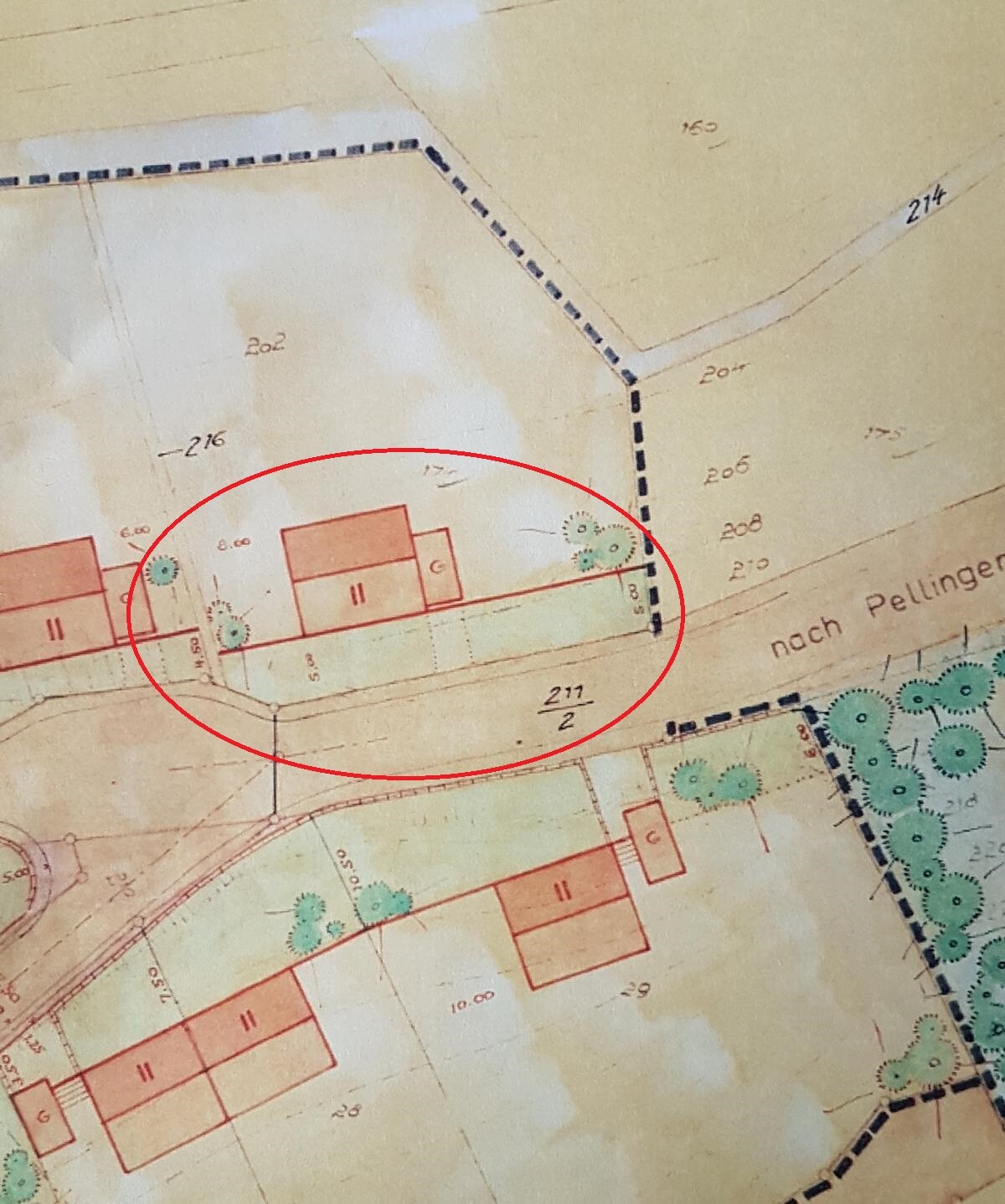

We recently purchased a building plot and now want to construct the largest possible multi-family house on it. It is an old development area, but there is a zoning plan with only a few regulations. The terrain slopes downwards from the street. As I interpret it, the two full stories apply to the street front, but due to the slope, there could be more floors toward the garden side—or am I reading the plan wrong? I think so because the building mass is divided in the middle, marked with a different color, and the symbol for the maximum number of full stories only appears on the half facing the street.

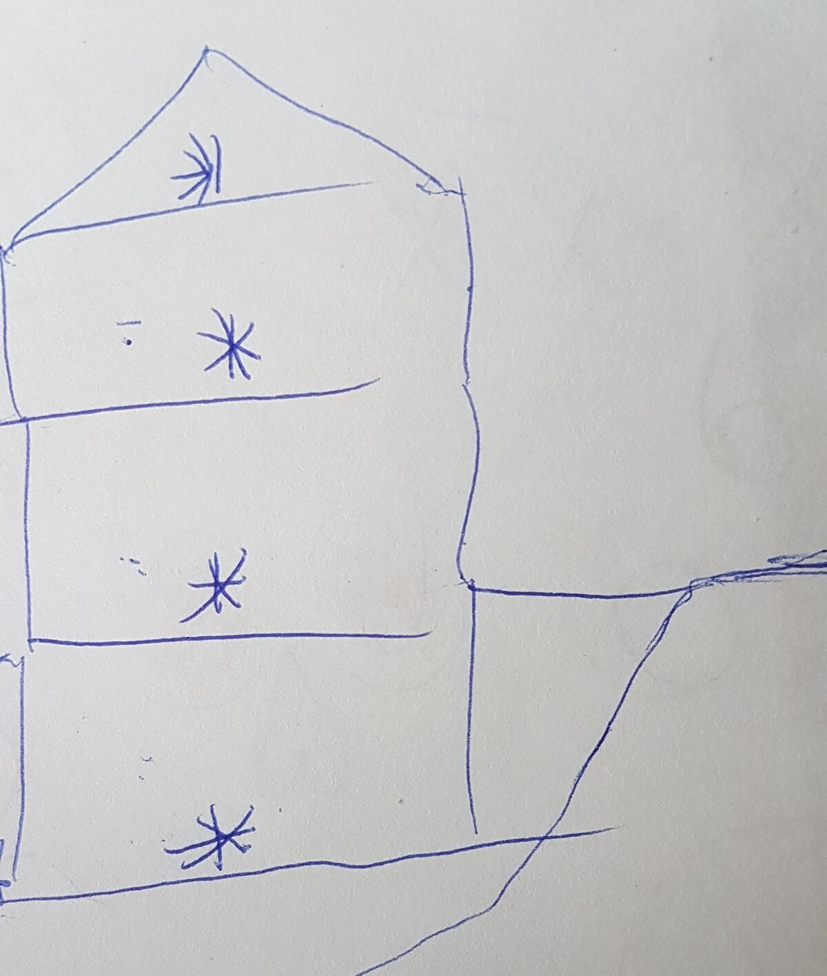

So, just as a very rough sketch, I have a question for you whether something like the rough drawing could be possible based on the zoning plan.
And regarding the 8 meters (26 feet) on the left side of the building—does this mean I need to maintain an 8-meter (26 feet) setback to the neighbor’s boundary with the residential building?

As I understand it, the 2 full floors refer to the street view, and due to the slope, there might be more floors towards the garden side, or am I misinterpreting the plan? For a correct interpretation, the legend of the zoning plan (B-plan) would be very helpful. The depiction of the building structures was usually included as a non-binding development suggestion in the plan at that time. The centerline is intended to indicate or define the ridge direction (see legend or written regulations). The full floor count applies to the entire building, not just parts of it, and is regulated by the regional building code. Whether the currently valid building code or the one in effect when the zoning plan was established is applicable is debated among experts. The prevailing view is the "static" interpretation, meaning the building code valid at the date of the zoning plan applies.

So just as a rough sketch, I wanted to ask whether something like this rough drawing could be possible in relation to the zoning plan. Unfortunately, your rough sketch cannot be clearly interpreted. How is the terrain supposed to be arranged? What is beneath your lowest floor? According to the current regional building code, you must excavate the basement so that on average it protrudes less than 1.40 m (4.6 feet) above ground level. For example, if you plan a basement height of 2.80 m (9.2 feet) on the garden side, the terrain profile in the side view should not fall below the diagonal line.

And regarding the 8 m (26 feet) to the left of the building, does this mean I should maintain an 8 m (26 feet) distance from the neighbor’s property line with the residential building? That’s how I would interpret it. But discuss this with the authorities to find out whether the old zoning plan is still being enforced. They will also provide you with the correct interpretations of the plan’s symbols.
