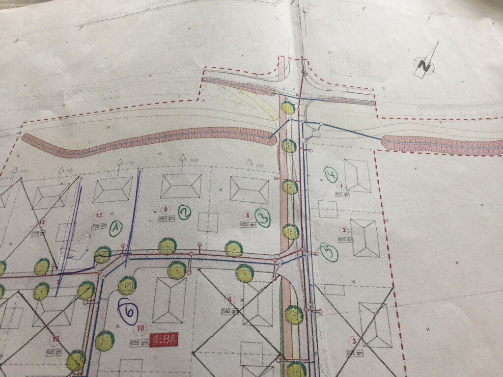

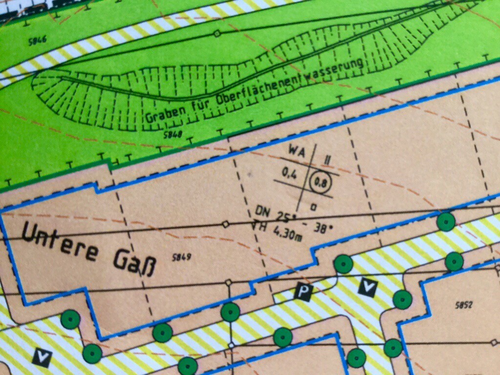

Building is a hot topic for us right now, as we were assigned a plot of land two weeks ago through a lottery process. We have now reserved it. The notary appointment is in July. I have attached two files. Our plot is number 12, with 720sqm (7,750 sq ft), or the plot where the building data is noted.

Site coverage ratio: 0.4
Floor area ratio: 0.8
Building envelope and boundaries: see plan
2 floors allowed
Roof pitch: between 25 and 38 degrees allowed
Style: open design
Orientation: usual orientation, living-dining room facing west, entrance possibly east
Maximum eaves height: 4.30m (14 ft)

- Regarding the orientation of the house: are we free to rotate the house as we wish? Since the plot faces south, would we have to place the house right at the rear boundary of the plot, which would mean a long driveway to the garage?

- Regarding the orientation of the house: are we free to rotate the house however we want?What does the zoning plan or building permit say? Often, it is required to keep the building line. Sometimes, the roof slopes or gables have to face specific directions. If nothing is specified there, you can also position the house at an angle. Distances of regulated 3 meters (10 feet) from neighbors or the building envelope must be observed.
kiki_79 schrieb:
Since the plot faces south, we would have to place the house all the way at the back boundary, which means a long driveway to the garage, right?A south-facing orientation means that the street/driveway would be to the north. Without a site plan, that seems a bit contradictory in your case. The best approach is to take the site plan and transfer it onto graph paper including possible neighboring properties. Sketch a potential house in pencil. Garage, driveway, terrace... you will need an eraser and can try many different options. Consider a waste bin area, play area, sun orientation, kitchen garden (herbs near the house), existing trees, etc. You are still in the planning phase. Little by little, you will get closer to your plan. If you like, you can also share your developed plan here.

- Which house types are possible with a wall plate height of only 4.30 meters (14 feet)? Does that rule out the townhouse/villa?Yes, that is ruled out. Therefore, you should avoid getting too fixated on a particular building style and/or work with an architect whose job is to combine the client’s wishes with the zoning plan.
Is there a dimensioned version of the plan as well?
Is the blue line meant to represent the building boundary within which you are allowed to build, considering the neighboring properties (3m (10 feet) distance or garage on the boundary)?
I would rather imagine a somewhat elongated house placed relatively far to the east here. Just a first spontaneous idea.
Roof style: The other drawing mainly shows hipped roofs. You will need to check on site what types and orientations are permitted.

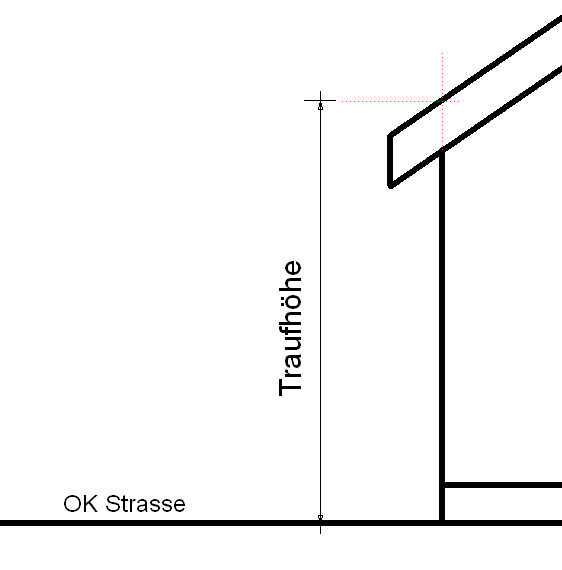

Eaves height:
430 cm (14 ft) is therefore not very large.

Hey kbt09,
Thanks for your help! I’m assuming we have to build within the blue line, so that would be the boundary. Unfortunately, the plan doesn’t show any dimensions, but we calculated that the plot is about 23m (75 feet) wide and 31m (102 feet) long.
I would also prefer to place the house closer to the right corner, but the question is how it will be allowed to be oriented later on, and which type of house would be suitable. I’m also a bit concerned that the neighbor on the left might block a lot of sunlight with their house.
Although at a 4.30m (14 feet) eaves height, no house will be very tall anyway, right?

kiki_79 schrieb:
Unfortunately, the plan does not include measurements, but we have calculated that the plot must be 23m (75 feet) wide and 31m (102 feet) long.I still don’t know which plot it is, but you can try drawing your dimensions and then place the house and other elements.
The blue line will mark the building boundary.
Yesterday, I saw a house positioned at an angle. I think it looks good; unfortunately, few people are that creative and give their plots diagonals or sharp corners. Although these can add a lot of dynamism to a property. I believe many keep their garages aligned with the plot boundary, so they stick to this line.
Usually, it also looks better from the street when you face the gable directly.
A long, narrow plot oriented east/middle... with the garage at the front, possibly positioned perpendicular to the driveway on the east side, is also worth considering – it creates shade and privacy while allowing for a pergola.
