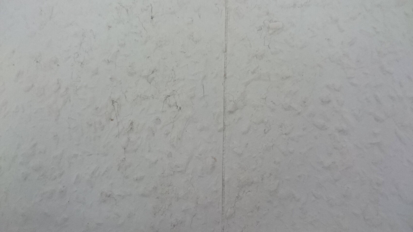

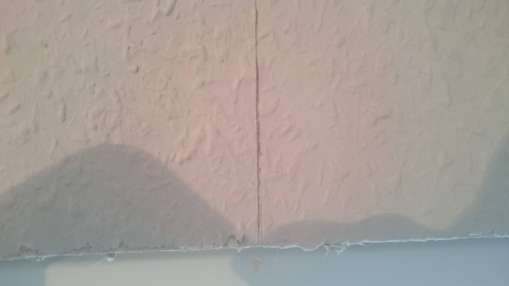

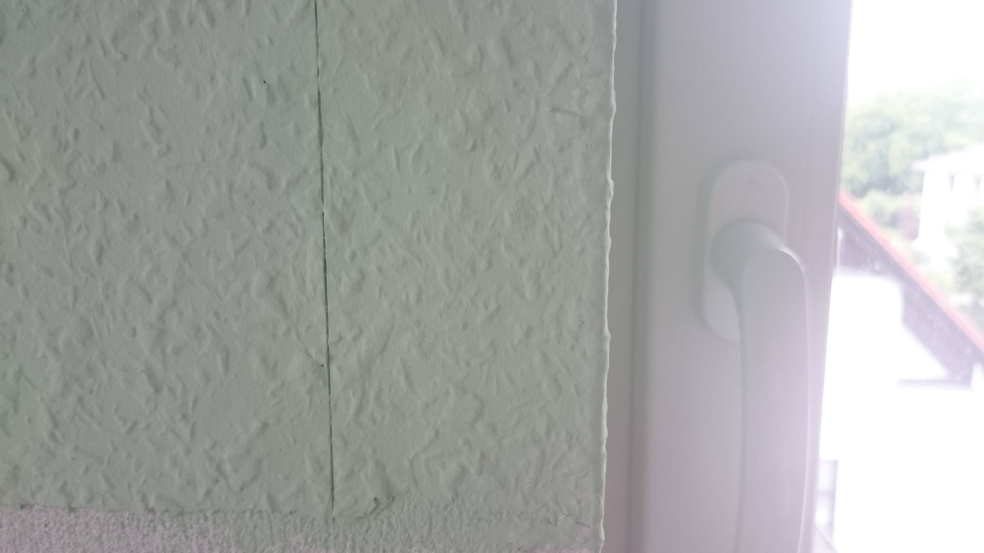

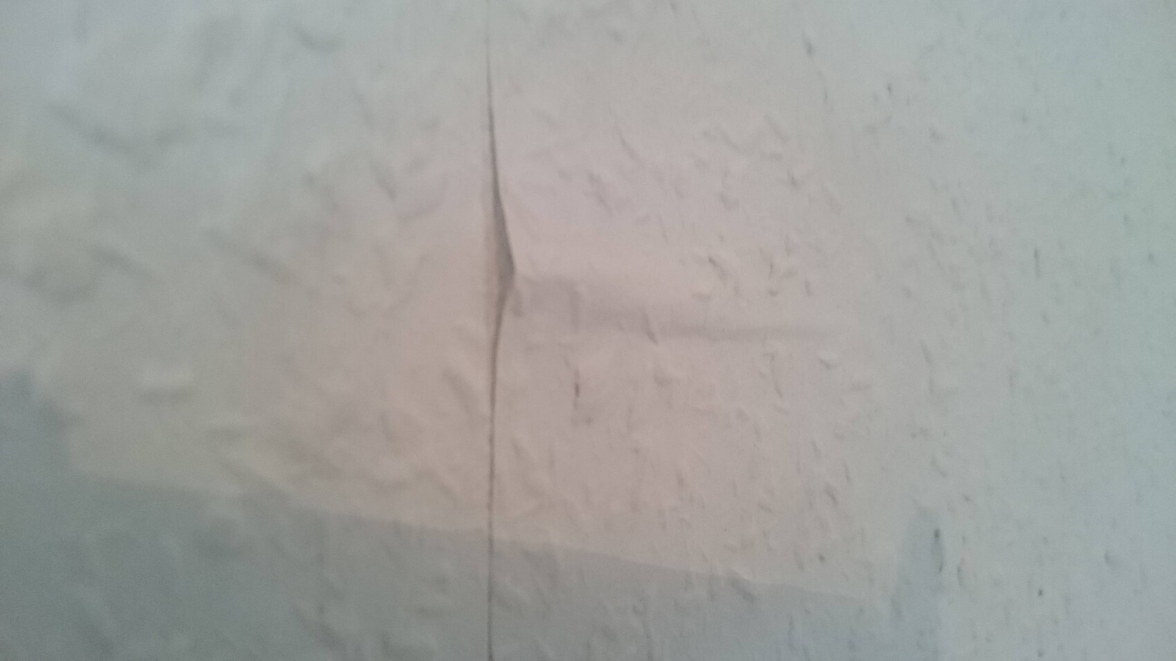

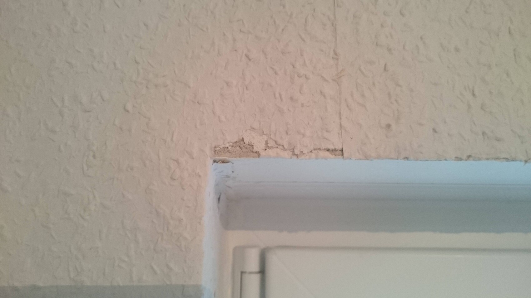

we had our walls wallpapered by a painting company because we did not feel confident doing it ourselves. However, we are not satisfied with the final result at all; we probably could have done it just as well on our own. We did not choose the cheapest option, nor the most expensive—the quote was 5.95 euros per m² (5.95 euros per 10.8 square feet), which was mid-range.
Already painted by us:
Not painted yet:
Additional defects:
On one occasion, too much wallpaper was cut off at the bottom, so there was a gap above the skirting board. They simply glued more wallpaper on afterwards.
Would you accept this? Is this professional workmanship?
I would be very grateful for your feedback!

underfree15 Jul 2015 13:21Hello,
the painter was here today and painted one wall himself. While he was painting, when everything was still wet, he said, "See, nothing is visible." He said I used too little paint and/or the paint is cheap and new textured wallpaper needs to be painted twice anyway. Now that it’s dry, the seams are visible again. On the other wall that had already been painted, he applied a second coat today. It was the same situation again. When it was wet, it looked good, but now that it’s dry, you can see everything again. For me, the only option left seems to be to wallpaper everything again. Or am I being too critical about the seams? I only know it as something where you don’t see anything or hardly anything, and that’s how I wanted it.
Good luck, Katrin

Did you agree that the seams should not be visible at all? Or did you just assume ("I only know it that way") that they wouldn’t be noticeable?
To assess this properly, you would definitely need to upload more photos here. However, I don’t find slightly visible seams that unusual. It can certainly be done better, but due to common practice, perfect workmanship is rarely achieved. It always depends on what can typically be expected unless specific agreements have been made.
Arni1957 schrieb:
Hello Katrin,
Properly done = a clear no.
Please request a correction of defects and do not accept this work as is.
