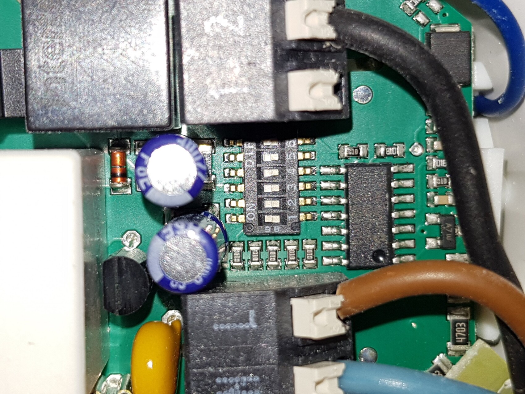

In our guest bathroom, we have a Helios M1/100 F exhaust fan. However, it is running continuously, which it shouldn’t. I looked at the manual and compared it with the current wiring. I believe it is incorrect. The fan is connected to N/L and terminal 2.
According to the manual, terminal 2 is for manual operation. Shouldn’t it be connected to terminal 1 instead?
Nordlys schrieb:
Our construction supervisor recommended running continuous operation during the first year to better dehumidify the house; after that, the wiring can be switched.The year ends in November 😀 so from terminal 2 to terminal 1
