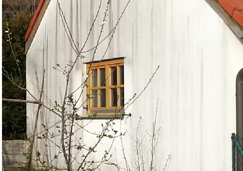

The neighbor’s garage is built on our boundary line, and in the boundary wall there is a window facing our property, which was neither approved nor registered in the land register. This is a standard wooden window that opens. At one time, there were shutters installed that extended onto our property, but now only the brackets remain, which still protrude about 15 centimeters (6 inches) onto our land.
As far as I know, this kind of window should generally meet fire resistance class F90—but I don’t really care; that’s for their fire insurance to sort out.
The protruding shutter brackets bother us because you can catch on them—they’re simply in the way. Also, after a few incidents, we would prefer that this window cannot be opened and that the neighbors can’t look into our yard there (we actually want to create our main terrace in that area).

Here is a picture (from long ago – instead of the little trees, our garden furniture is now there *g*), so you can get an idea:
If you look closely, you can see the brackets (we will just leave the fact that the windowsill also protrudes onto our property as it is).
