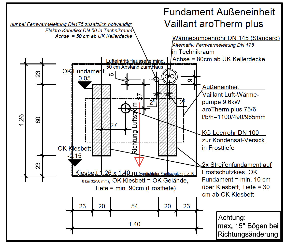

These are the specifications we received for the foundation to be constructed on site:
Installation plan: Vaillant aroTherm plus outdoor and foundation installation, gravel bed, dimensions.

Good evening, I just received the response from my heating engineer. After checking, he wrote that there is no objection to filling with stones like in a drip strip up to the top edge of the concrete base. Alright, I will proceed that way.
