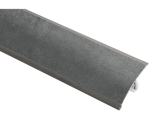

This wall finishing strip will be used:
Gray metal profile with sliding rail at the end, rectangular cross-section for interior finishing applications
Unfortunately, it is not clear from the measurements at which height the width of the niche was taken, so I will probably visit the site tomorrow and measure it myself before relying on the 3068mm (10 ft 1 in).

That definitely makes sense. Niches are often not the same width at the front and back.
Check the profile to see how many millimeters (inches) it can span so that the screws still grip firmly in the panel.
