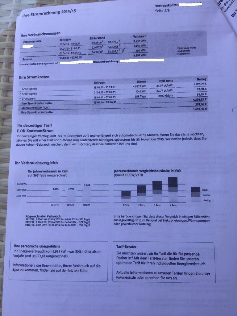

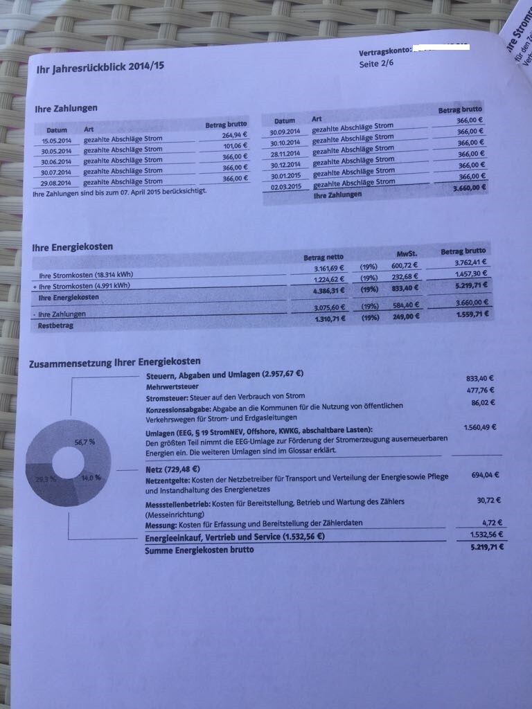

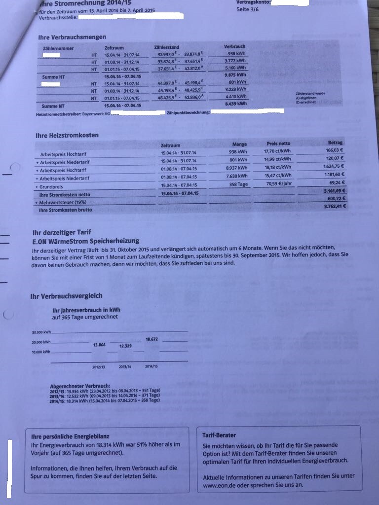

A sauna consumes quite a bit, but that alone doesn’t explain it. As mentioned before, just the electricity used for heating could keep the entire house and hot water heated year-round with an electric fan heater. That’s extremely inefficient.
If you hadn’t mentioned a heat pump and the year of construction (built in 20xx), I would have thought there were night storage heaters. The consumption fits better with that and also matches the two-rate meter (high tariff/low tariff).
