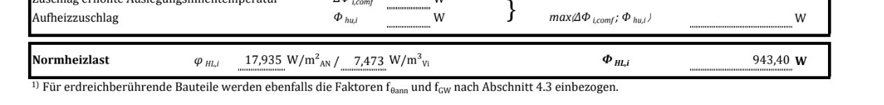

Is the heating load for your existing rooms also lower then? Partly much lower. My extension consists mostly of windows—so poor insulation values.
For example, the heating load for my living/dining area with about 50sqm (540 sq ft).
That’s exactly why you get the heating system properly sized. It might cost around €200 from the engineering office, and you receive a heating design calculated according to your wishes and specifications, including a pipe layout plan for the heating pipes (which you can specify—from 14/2 to 20/2 pipes) and the corresponding flow rates to be set.
LostWolf schrieb:
My heating load is needed at -11.6°C (11°F) (97456) It’s a bit warmer for me, but that doesn’t make much difference. My calculation was done for 22°C (72°F) room temperature, yours only for 20°C (68°F) (which I think is too cold!). That more than balances out.
