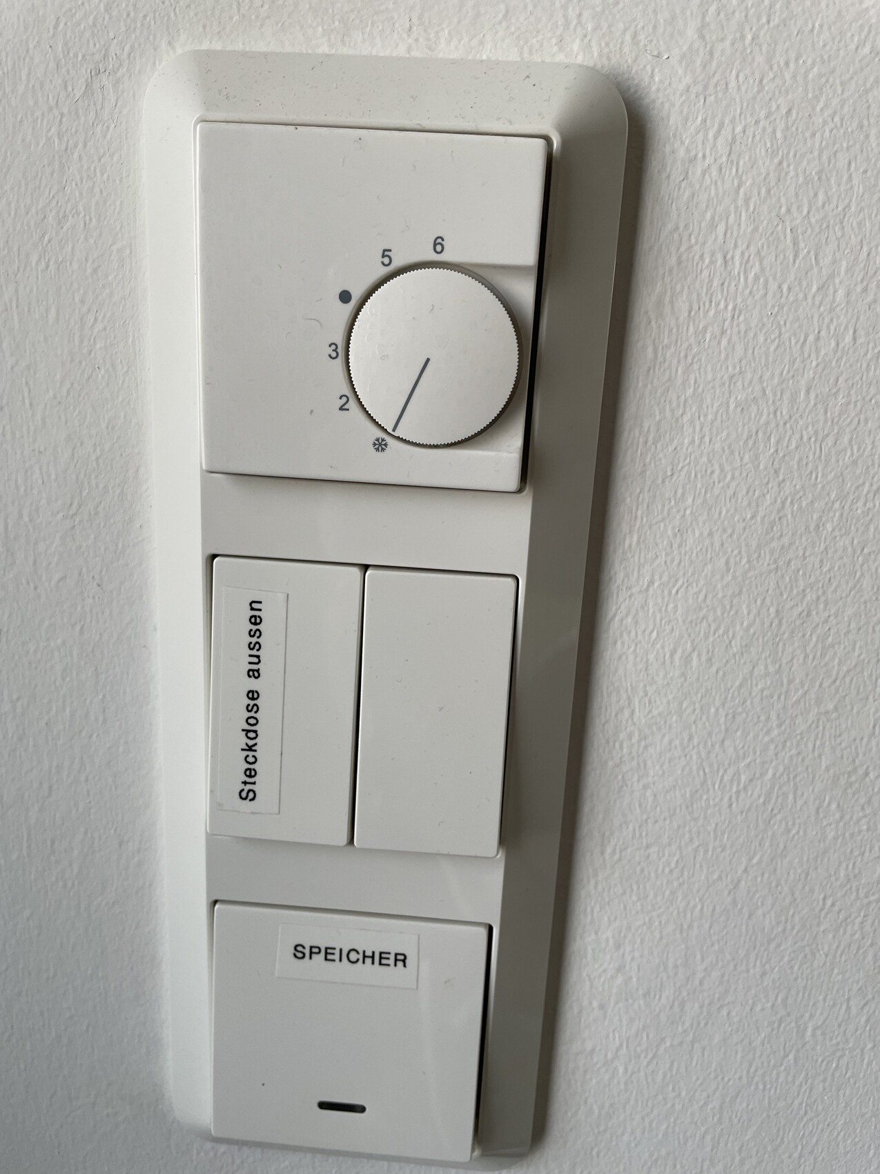

The hallway is on the ground floor, with our front door facing north. In the basement, the large terrace door is on the south side, so it gets sunlight during the day. However, the temperature stays around 22°C (72°F) overnight and in the early morning when we get up, so a little sun exposure shouldn’t be a problem. Is the sensor installed inside the controller? See photo.

The hallway on the ground floor, our front door faces north. In the basement, the large patio door faces south, so the sun shines on it during the day. Nevertheless, the temperature stays around 22°C (72°F) overnight and in the early morning when we get up, so it shouldn’t be a problem if the sun shines on it a little. Is the sensor built into the controller? See photo Unfortunately, I only understand parts of your post 😉
Basically, the sensors in the controllers are just rough estimates. One is placed on the exterior wall and one on the interior wall. So my first tip is to buy a thermometer and measure everything yourself. Be sure to measure at the same height and not directly on exterior walls.

Matthias456 Oct 2022 13:40chewbacca123 schrieb:
The hallway is on the ground floor, and our front door faces north. In the basement, the large terrace door faces south, so sunlight comes in during the day. Still, it stays at 22°C (72°F) overnight and in the early morning when we get up, so it can’t be a problem if the sun shines on it occasionally. Is the sensor built into the controller? See photo. Your controller has a bimetal switch installed. For testing, turn it to the maximum setting and check over two days whether it gets warmer in the hallway or the bathroom.
