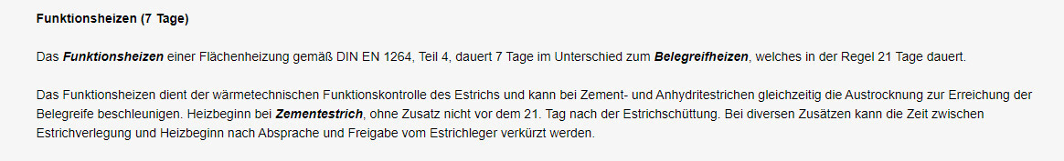

SaniererNRW12316 Sep 2022 08:31i_b_n_a_n schrieb:
In our new office, the landlord mentioned a 50° heating temperature. I think it’s about relieving stress in the screed... Yes. There are two different types of heating:
1. Functional heating
2. Drying heating / readiness heating
It’s easier than explaining it myself:
Although functional heating is often still specified at around +/- 50 degrees Celsius (122°F), it is now common not to go that high, since the maximum supply temperature is usually limited to 30 degrees Celsius (86°F), and the full 50 degrees Celsius (122°F) difference is no longer necessary.
The screed installer decides the duration and temperature of the heating.
