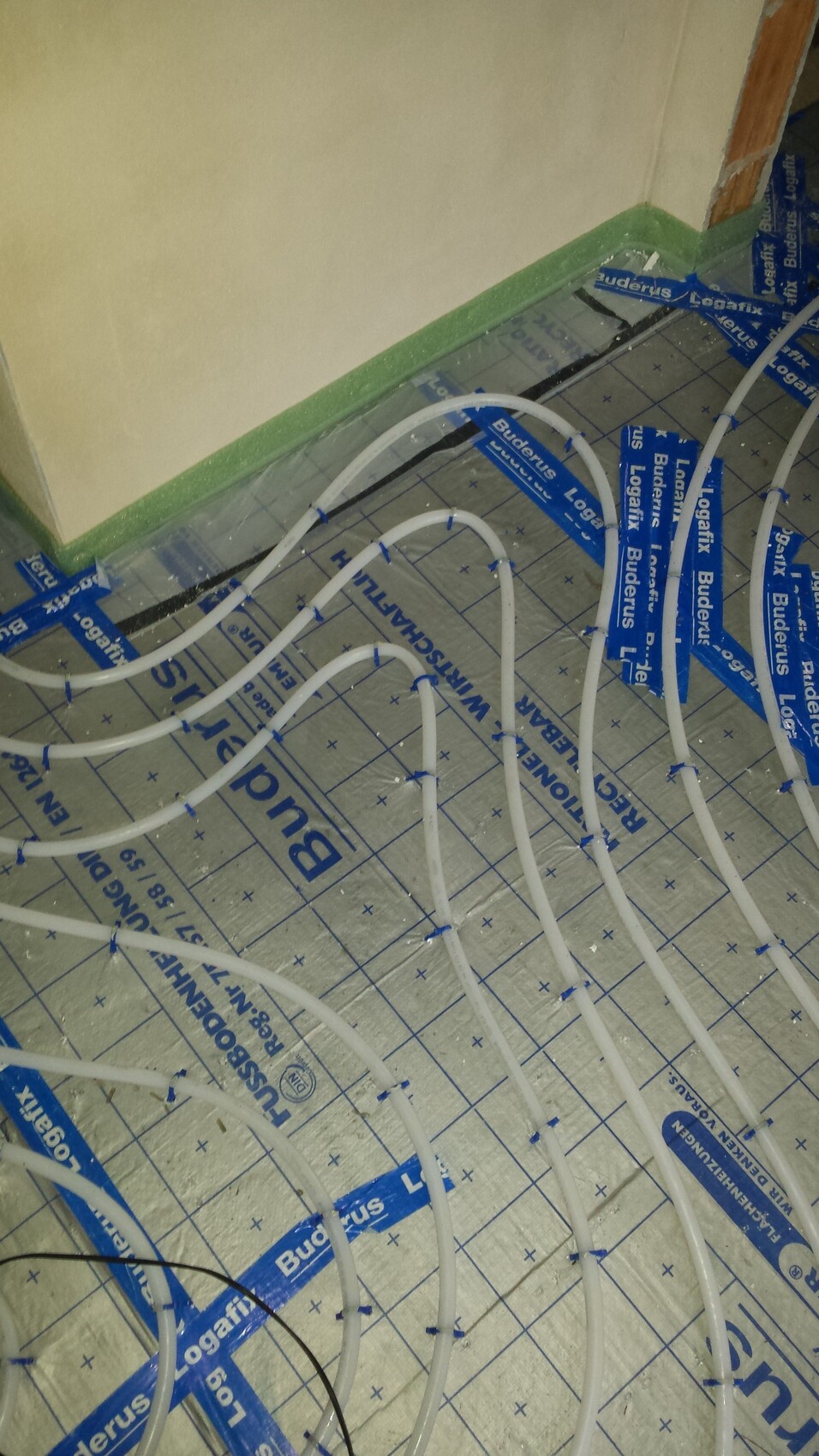

The underfloor heating is currently being installed in our new build, and I noticed this bend.
Underfloor heating: white pipes in loops on insulation foil with blue tape marking.
You can feel a narrowing when you press on it.
The architect and heating company say this is fine, but I don’t agree.
Edit: Some info about the heating pipe being used: Empur Klimapex PE-RT 17x2 millimeters (approx. 0.67x0.08 inches).
Thanks in advance.
