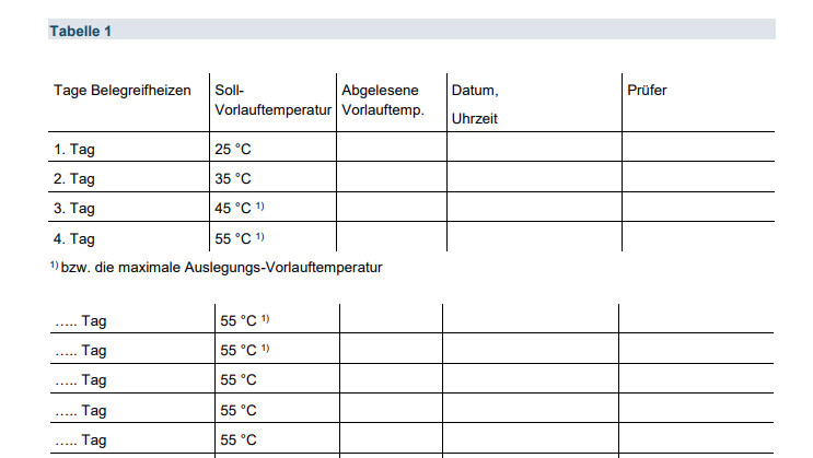

Benutzer2003 Dec 2021 09:33@KlaRa and @RotorMotor
To add: The P7 protocol for the acceptance heating of screed (Federal Association for Surface Heating and Cooling Systems) already includes that it is not necessary to heat at full capacity the entire time, but only up to the maximum design flow temperature. Not up to the maximum possible temperature.
For functional heating itself, only the maximum design temperature applies – for the heat pump, this is 30–35°C (86–95°F).
