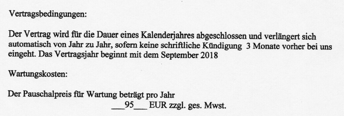

AxelH.26 Sep 2021 19:08
Fuchur schrieb:
It should not be forgotten that the BAFA subsidy for heat pumps, which was available until last year, required a maintenance contract to be signed as a mandatory condition.
That’s correct, we were also required to sign a contract and provide proof of this to BAFA. However, the price was quite reasonable:
Contract terms: automatic annual renewal; maintenance 95 EUR/year
