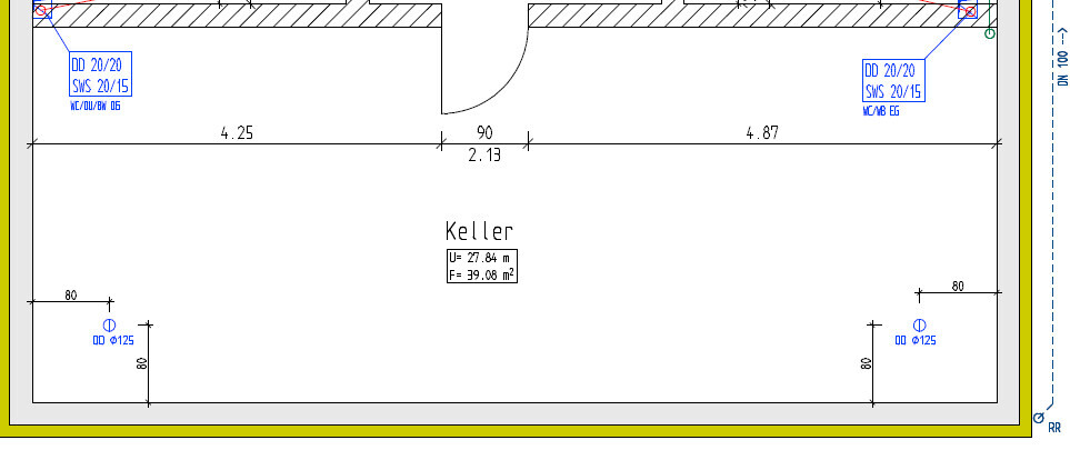

Our new build has a basement (a pure storage basement without windows) and our "pantry" with a total area of 39m² (420 ft²) is actually half pantry (some packaged food, drinks, and storage for various items) and half hobby room. The space is open and not divided.
In the hobby area, we often play darts, which is a lot of fun, but at 16°C (61°F) it is not always very comfortable. In winter, it is definitely colder than in summer.
Now to my question: What heating system would make sense for this room? Since the space is completely open, the other half will naturally also be heated, which is not necessary but certainly not a problem, as I won’t be able to quickly raise the temperature above 20°C (68°F) anyway.
The goal, however, is to quickly improve the temperature in the hobby half by 2-3°C (4-5°F) with a short lead time.
Is this basically feasible or rather difficult, and would it be better to separate the rooms? However, I currently have little time and interest in installing a drywall partition...
Attached you will find the floor plan of the room.
