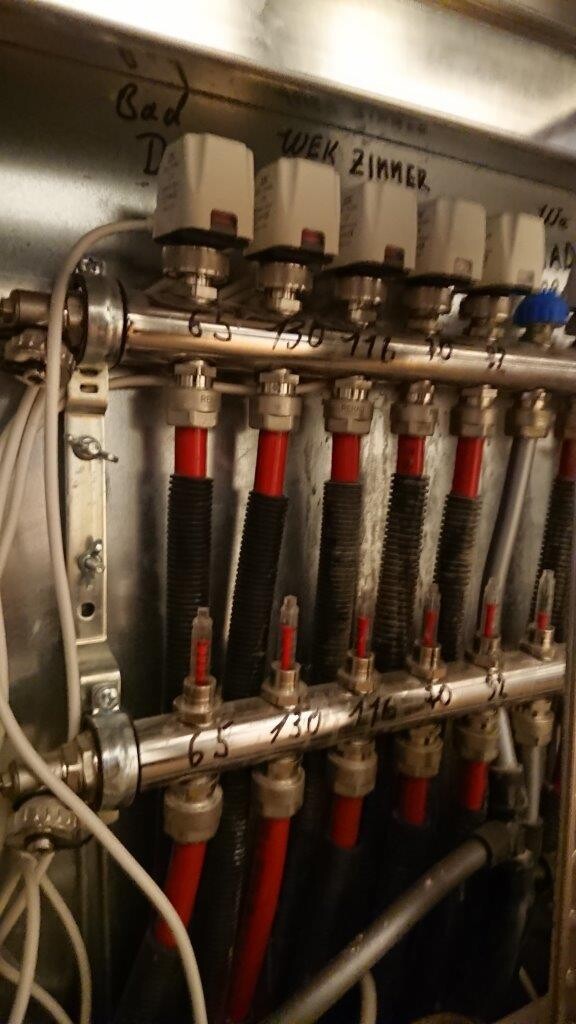

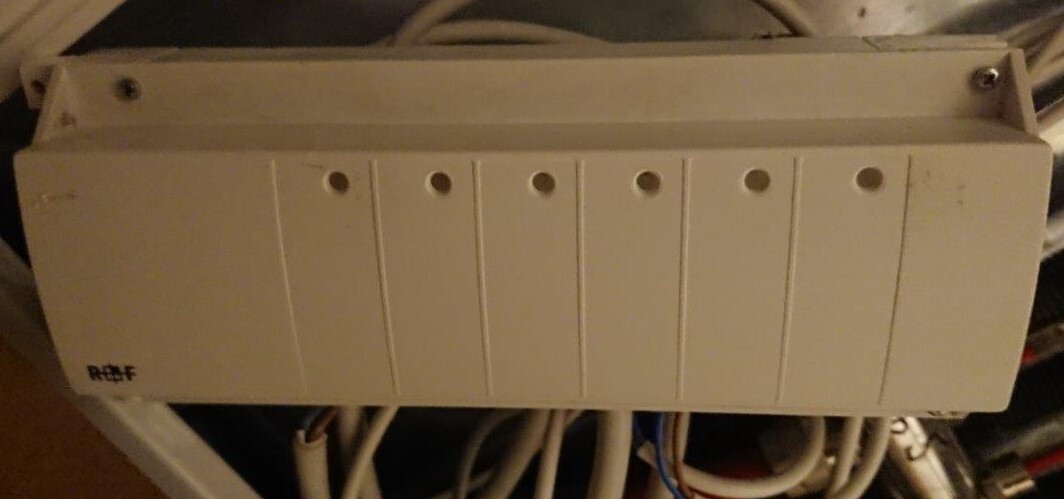

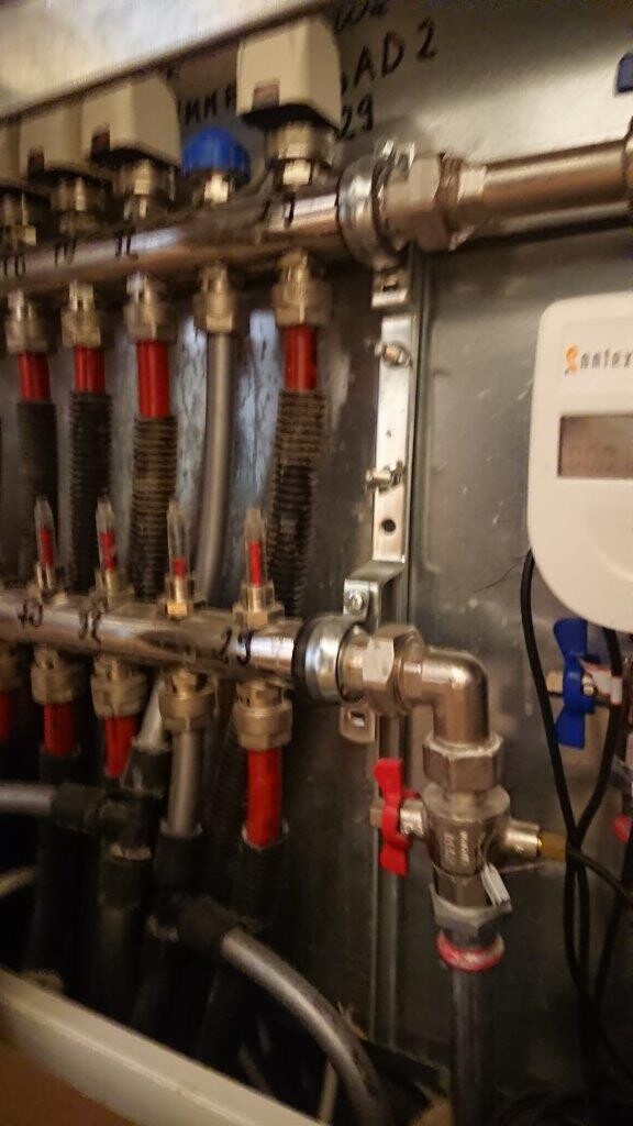

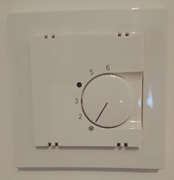

While the construction of my house (https://www.hausbau-forum.de/threads/lage-stadtvilla-oder-efh-auf-500-m2-rechteck.33505/post-442751) will soon begin, I am once again facing the question this year of how to properly control the heating in the currently occupied condominium.
The entire building is supplied with district heating, and I have a heating circuit distributor for the underfloor heating along with electronic room thermostats (ERR) in the rooms. The ERR have settings ranging from snowflake to 6, with 4 being marked by a black dot.
You can hear a small click both in the ERR and in a small white box hanging next to the heating circuit distributor, which probably controls the actuators, as soon as the setting reaches 5 or just below. After some time, this also causes a noticeable warming of the floor. Below that setting, nothing happens.
Problem: In the last four winters, it actually got too warm. The temperature does not seem to reduce automatically; it seems as if the click simply opens fully until someone turns it down again.
Questions:
1. Am I correct to assume that with district heating, no outdoor temperature (OT), supply, or return flow control can be done, since the water always arrives at around 80°C (176°F)?
2. Does this mean that a meaningful regulation is only possible by controlling the flow rates at the heating circuit distributor (indirectly via the ERR)?
3. Does anyone know how I could adjust my existing heating system differently?
4. Does anyone know of an affordable alternative system for upgrading?
Heating Circuit Distributor
Control Box
ERR

hampshire1 Nov 2020 17:35Tolentino schrieb:
1. Am I correct in assuming that with district heating you cannot control supply temperature or flow control because the water always comes in at 80°C (176°F)?
2. Does that mean a meaningful regulation is only possible via controlling the flow rates at the heat interface unit (indirectly via electronic radiator regulators)?
3. Does anyone know how I can adjust my existing heating system differently?
4. Does anyone know of an affordable alternative system for upgrading? Regarding 1: It is quite possible that you cannot make those adjustments. However, it is unlikely that it is completely impossible.
Regarding 2: Controlling the flow rates is generally sensible. It’s better to leave the electronic radiator regulators alone and disable them. They usually cause more problems.
Regarding 3: Have a hydraulic balancing carried out.
Regarding 4: This will be the last heating season for you in these rooms. I wouldn’t invest anything there.
What are your neighbors doing? Don’t they have the same issue?
