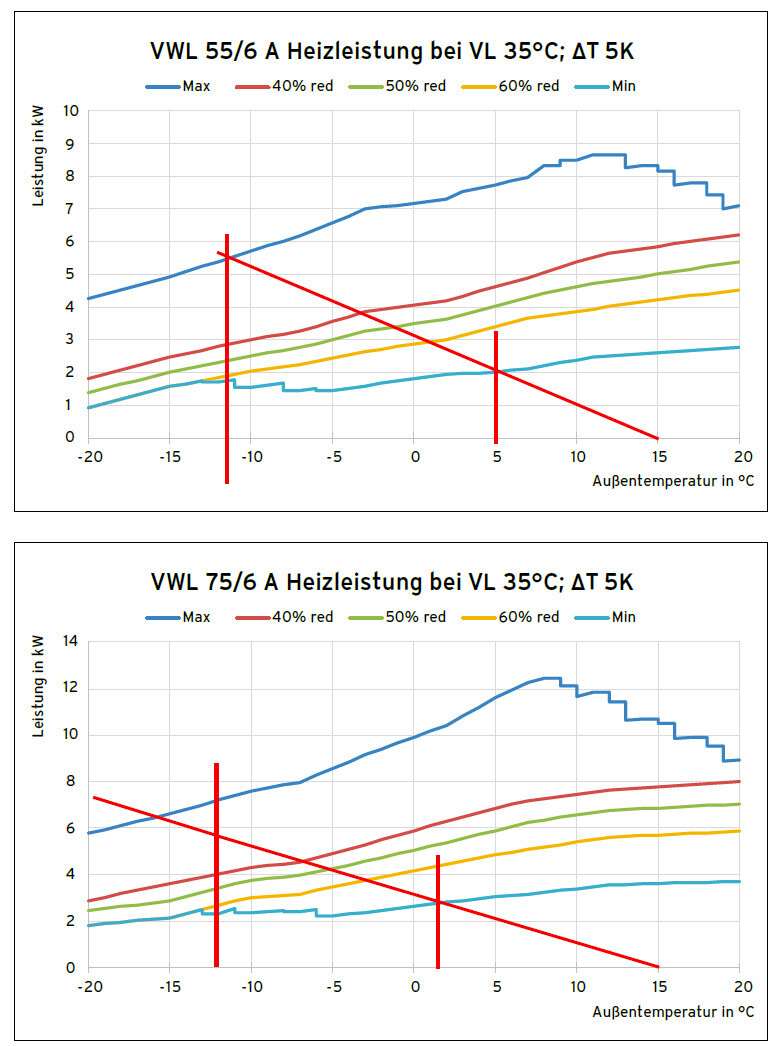

It’s me again. Today, I looked at the performance charts for the 55/6 and 75/6 models and marked the bivalence point for the electric heating element as well as the temperature at which the system starts to cycle, based on my primary energy demand (4.1 kW for heating + 1.5 kW for hot water = 5.6 kW).
Accordingly, everything really speaks in favor of the 55/6. Do you have any comments or suggestions?

since the heat pump either provides heating or domestic hot water, you can primarily base your calculations on the heating load requirement for heating.

the sizing of heat pumps is not straightforward. In the past, the common consensus was to size the heat pump slightly undersized rather than oversized. This was to avoid short cycling (frequent switching on and off of the compressor) at moderate temperatures.
However, heat pumps have since evolved. Today, modulating heat pumps—meaning variable-speed compressor models—are standard. These adjust their output to match the required heating demand. Therefore, a moderate oversizing of a heat pump is not problematic.
On the other hand, undersizing an air-to-water heat pump has a long-overlooked disadvantage. An air-to-water heat pump must defrost regularly because the compressor can ice up. This is normal and physically unavoidable. During the defrost cycle, heat energy is drawn from the heating circuit or buffer tank, and the heat pump temporarily reverses operation. Under adverse weather conditions with high humidity and outdoor temperatures around freezing, these defrost cycles can occur in short intervals. Depending on the unit, defrosting every 30 minutes is not uncommon.
To compensate for the energy loss, the heat pump must generate higher heating output between defrost cycles. A heat pump that is properly or slightly undersized may struggle here and, even at the highest modulation level, might not produce enough heat to offset the defrost losses. As a result, the house will slowly cool down. Unfortunately, this disadvantage, or this important background information, is neither considered in common sizing methods nor in manufacturers’ guidelines.

For the heating load calculation, I would use the 55/6.
