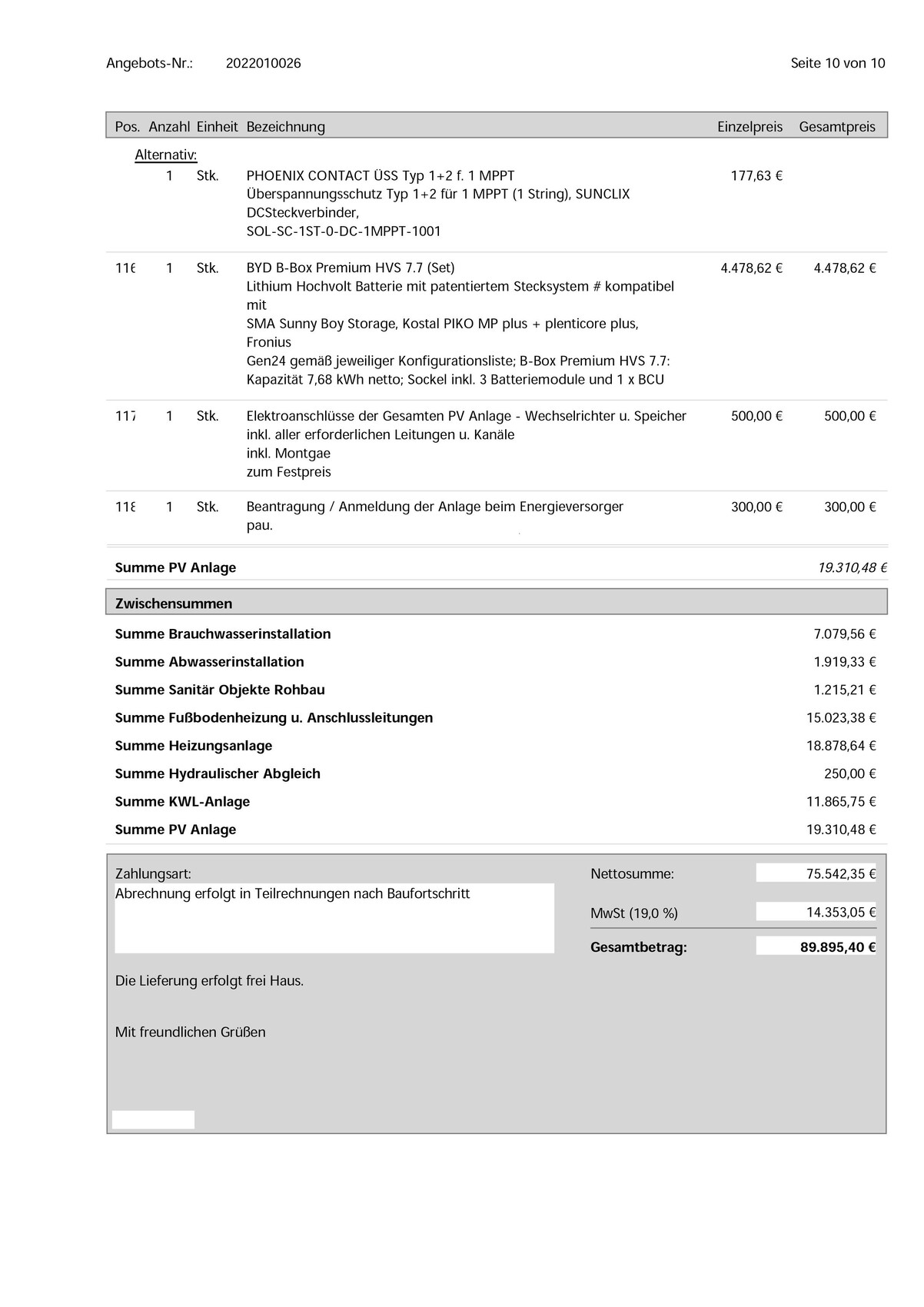

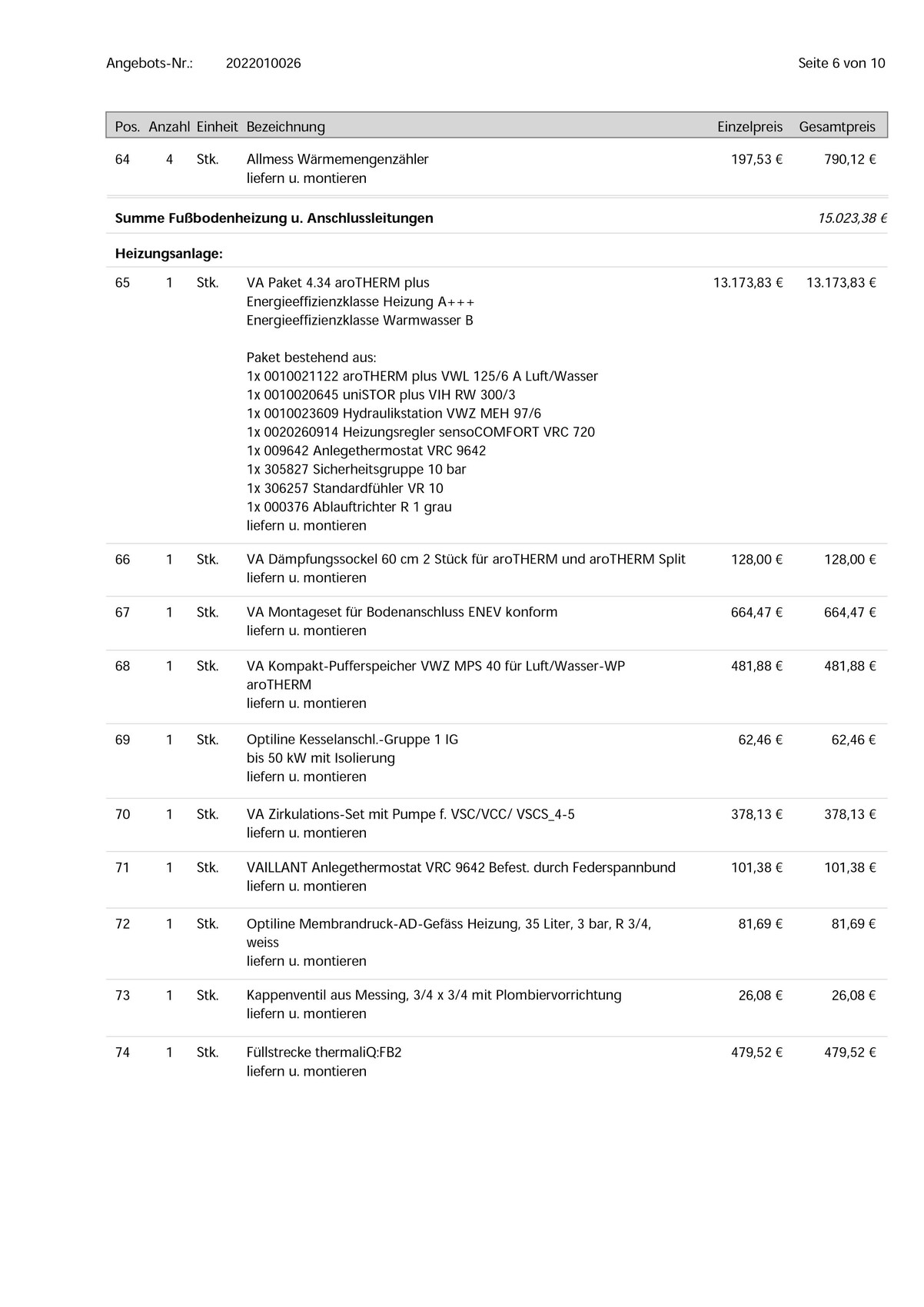

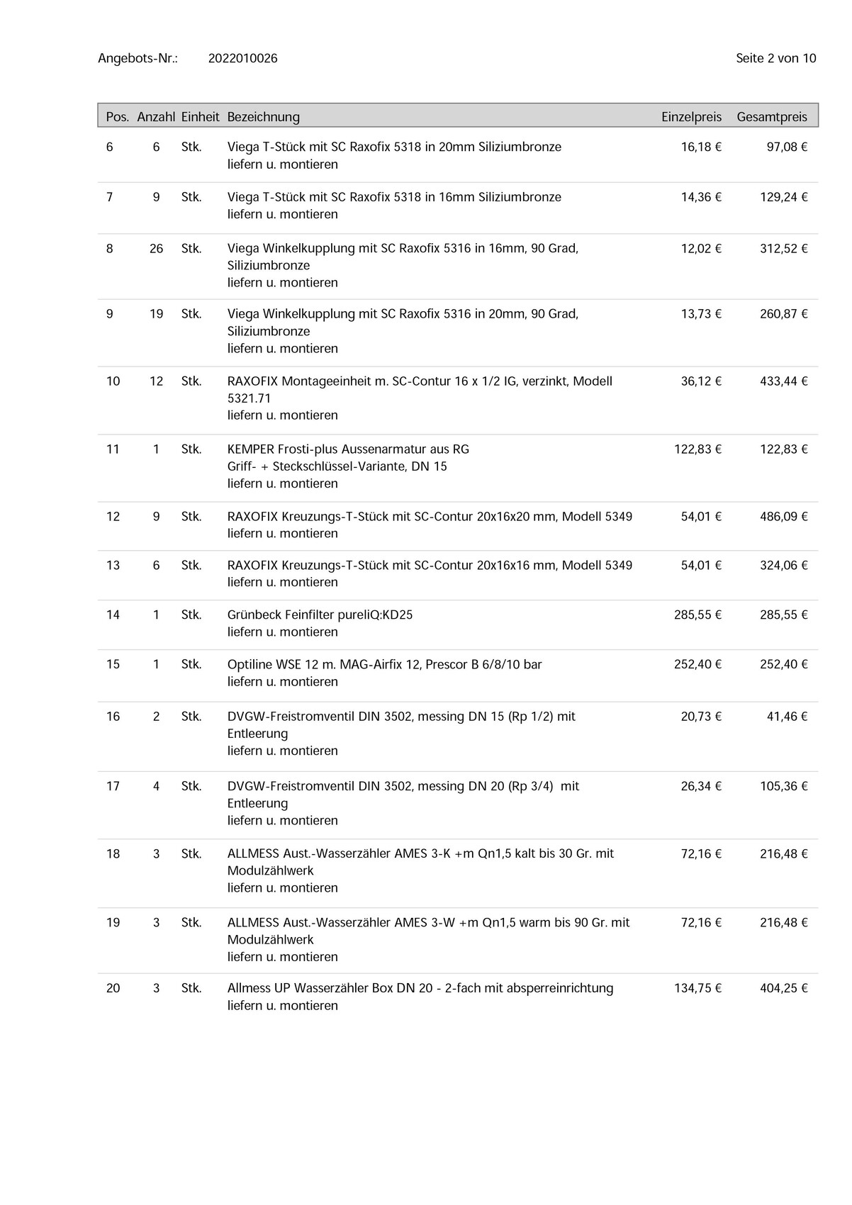

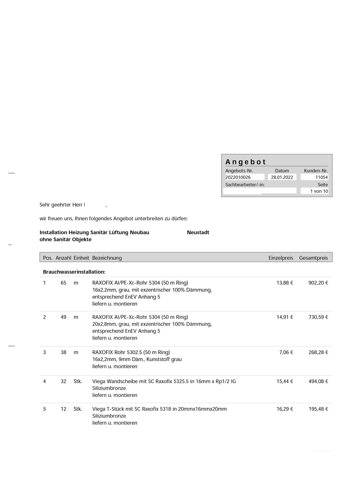

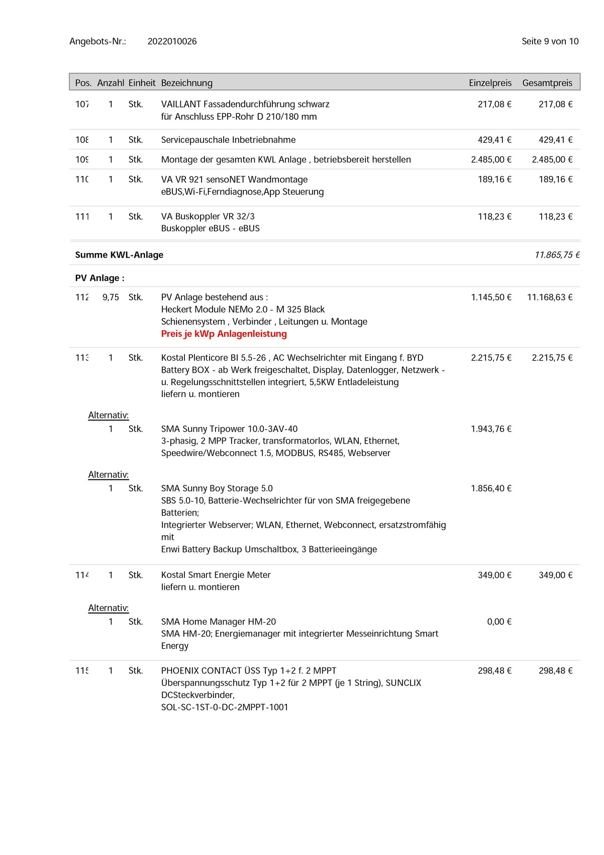

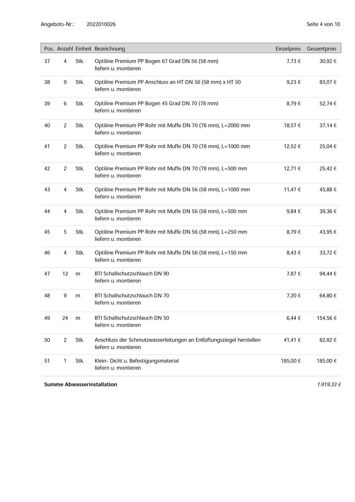

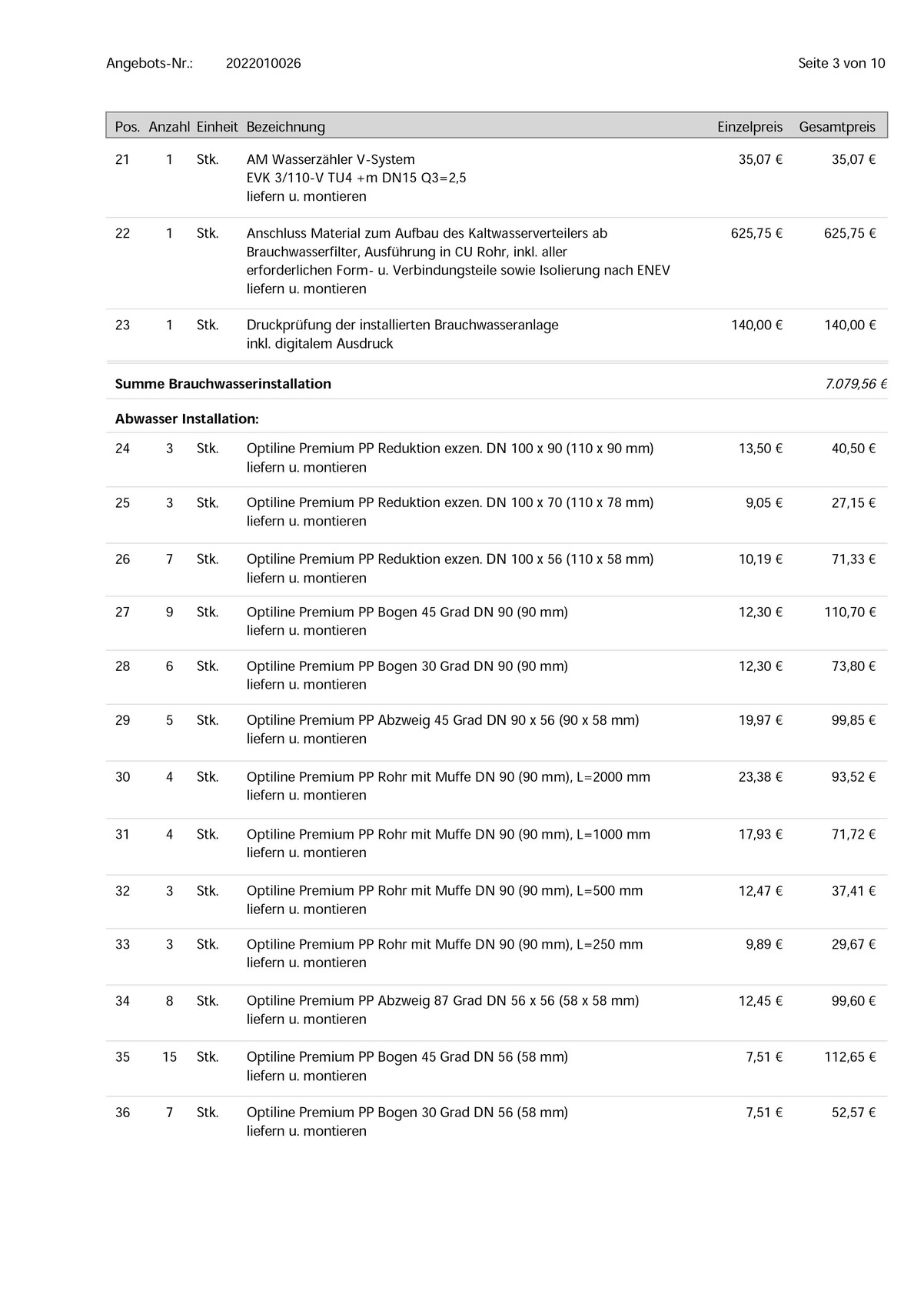

Two new houses are being built to KfW40+ standard.
I have received the following quotes for the two houses.
The quotes are based on the calculated heating load.
I noticed that only for the mechanical ventilation system the materials are listed separately, so I was only able to check the price for that part.
I quickly and easily found several companies online where the prices are about 25 percent cheaper for me as a private end customer. Now I would like a price assessment for the rest.
I would like to negotiate with the heating installer and confront him with this. He definitely will not be installing the photovoltaic system, as his price is 8,000€ higher than other offers.
The offer is for a building with 3 residential units and a basement; the other quote is similar but for 2 residential units. I actually thought I would get a good price due to synergies since two houses are being built next to each other.

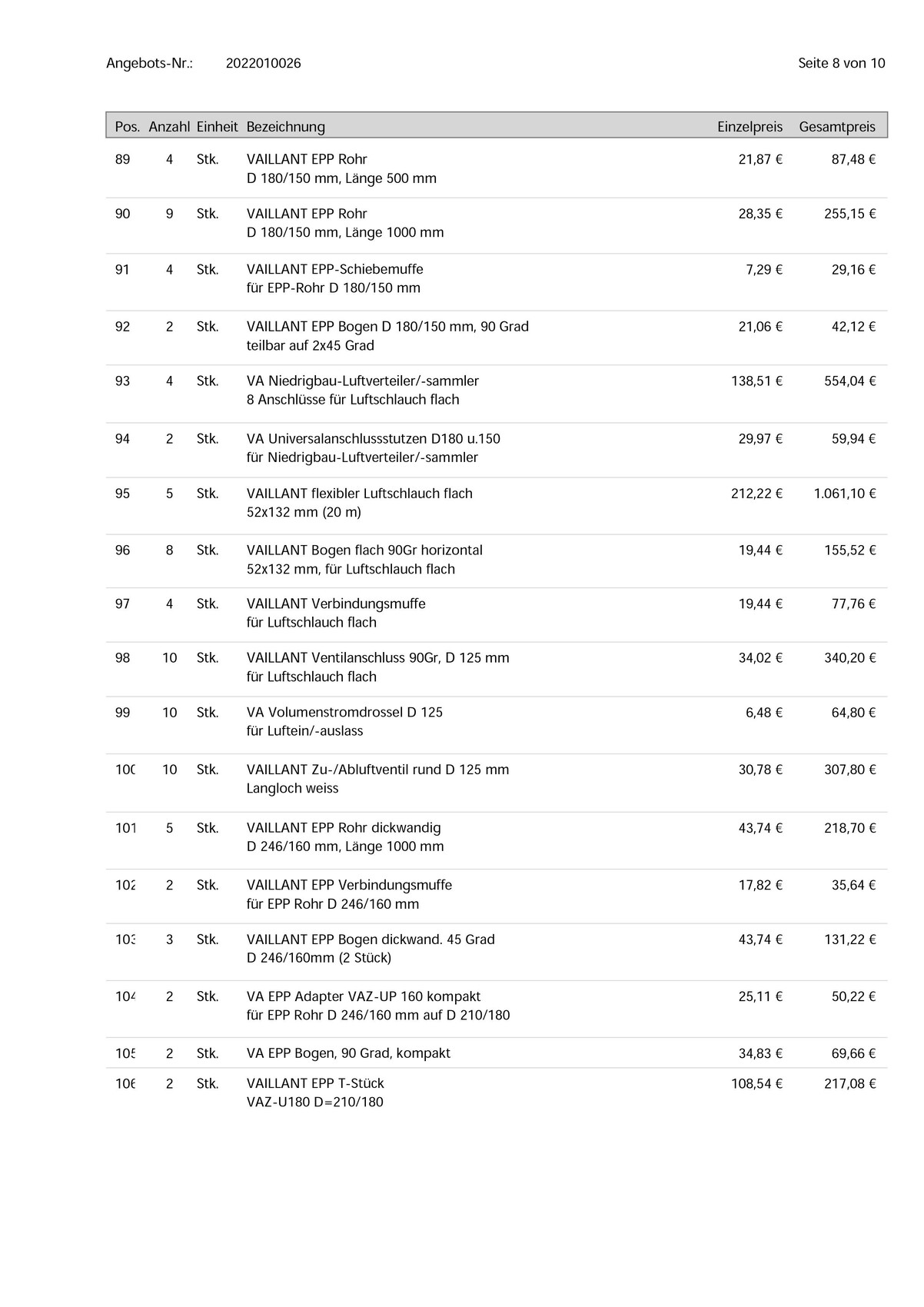

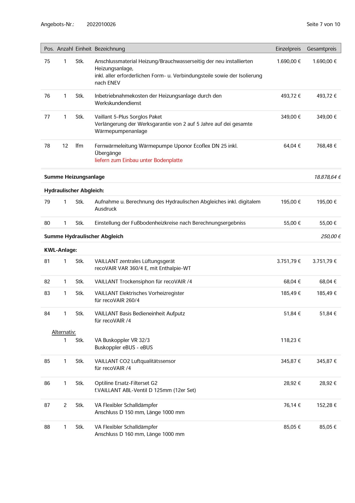

Here are a few examples of the price differences:
Vaillant recoVAIR VAR 360/4 E apartment ventilation device with heat recovery – Heating and solar at discount prices
Price in store 3359€
Price from installer 4464€
Vaillant CO2 air quality sensor – Heating and solar at discount prices
Price in store 325€
Price from installer 411€
Vaillant flexible flat air duct 52 x 132 mm (20 m) – Heating and solar at discount prices
Price in store 199€
Price from installer 252€
By the way, if anyone here can make me a competing offer and is possibly interested in carrying out the work, please feel free to get in touch.
Civil engineering has already started, heating and sanitary installation scheduled for April to May 2022.

I can only share my thoughts on the controlled residential ventilation system. If possible, switch from flat ducting to round ducting. In your offer, flat ducting is priced at 200€ for 20m (approximately 65 feet), whereas privately or through a tradesperson, you can get about 50m (165 feet) for roughly 100–120€.
You or the tradesperson can save money by choosing round ducting.
For example, 1000€ for flat ducting could be 200€ if using round ducting.
