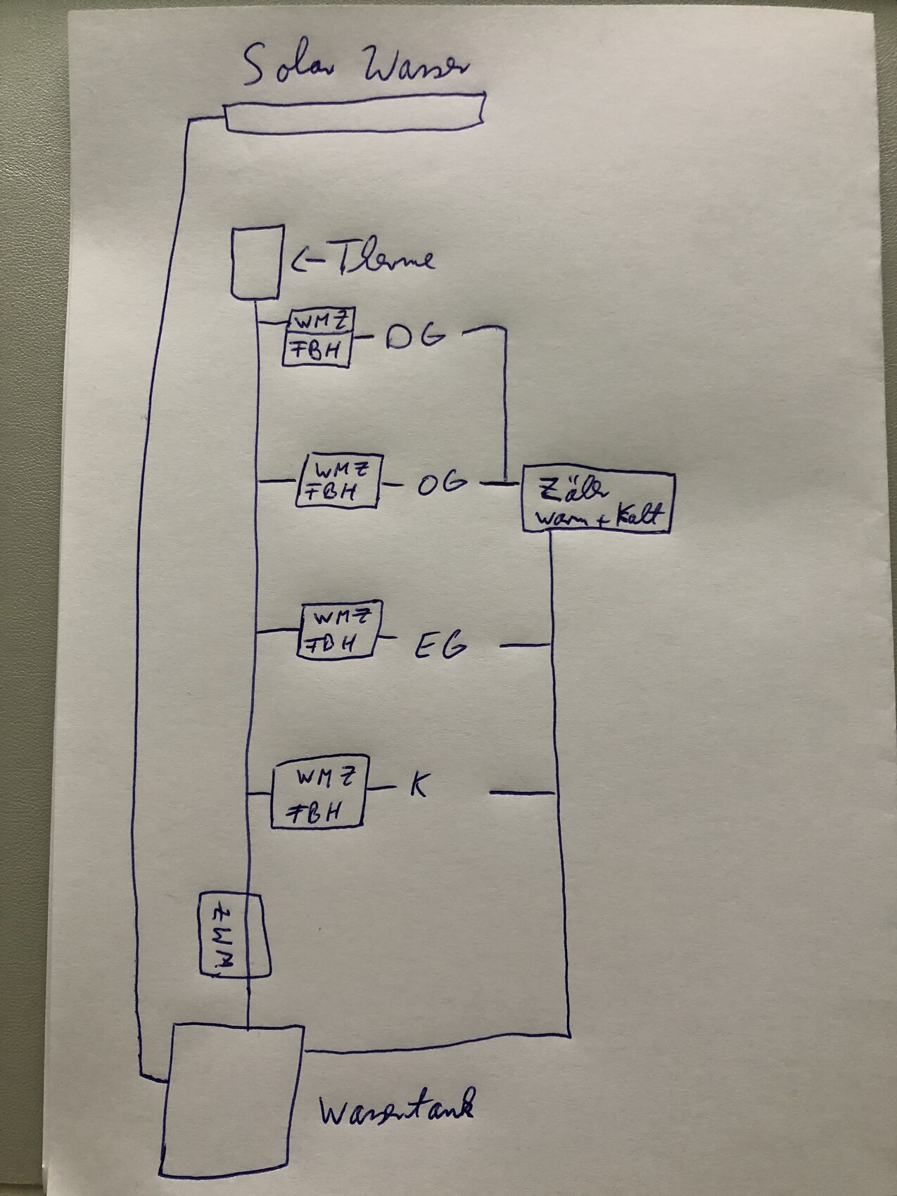

S_t_e_p_h_a_n2 Jul 2020 19:15Hello, first of all, thank you for your answers.
To explain the system on my side, I have made a sketch.
So, this means I have to install a separate meter for each consumer connected to the boiler.
I have five meters then (four underfloor heating circuits and the water tank).
Now I can calculate exactly how much gas each consumer used based on the gas consumption.
That part is clear to me.
However, I don’t have a meter for the hot water installed. It is only installed for the tenant, on the upper and top floors.
Will this cause any issues?
Also, how do I calculate the hot water consumption if the solar system heated the water?
The heated water should not be charged to me. After all, I paid for the system.
Hello
This still doesn’t work. You need a water meter for each unit.
You could also measure the solar yield using a heat meter, but this requires precision.
I wouldn’t consider it appropriate to charge tenants separately for the solar yield.
The system is part of the heat generation, and I would treat it as included in the rent.
Olli
Olli
S_t_e_p_h_a_n2 Jul 2020 22:41Can I simply multiply the volume of hot water in cubic meters by a certain factor X? There must be standard values for the amount of energy consumed per cubic meter of hot water.
S_t_e_p_h_a_n3 Jul 2020 09:03Hello, the water consumption is measured for the tenant using cold and hot water meters.
If I don’t care about heat loss, can I then skip the heat meters for my area as well as the hot water tank?
