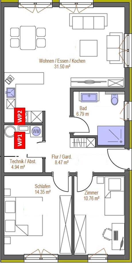

Hello everyone, we purchased a new apartment from a developer. The building has four units, two on the ground floor and two upstairs, with a flat roof timber structure featuring insulation above the rafters and a suspended hollow ceiling. Since there are no common rooms in the building, each apartment has its own heating system (heat pump) with one outdoor unit on the roof. Two of these units are located above our apartment, above the utility room (next to the bedroom) and the kitchen with living area. All interior walls of the apartment are lightweight construction walls. Since the electricity finally started working recently and the units are running, there is a loud humming and droning noise from above, as if a lawn mower is running on the roof. It is unbearable; we are relieved every time we leave the apartment.

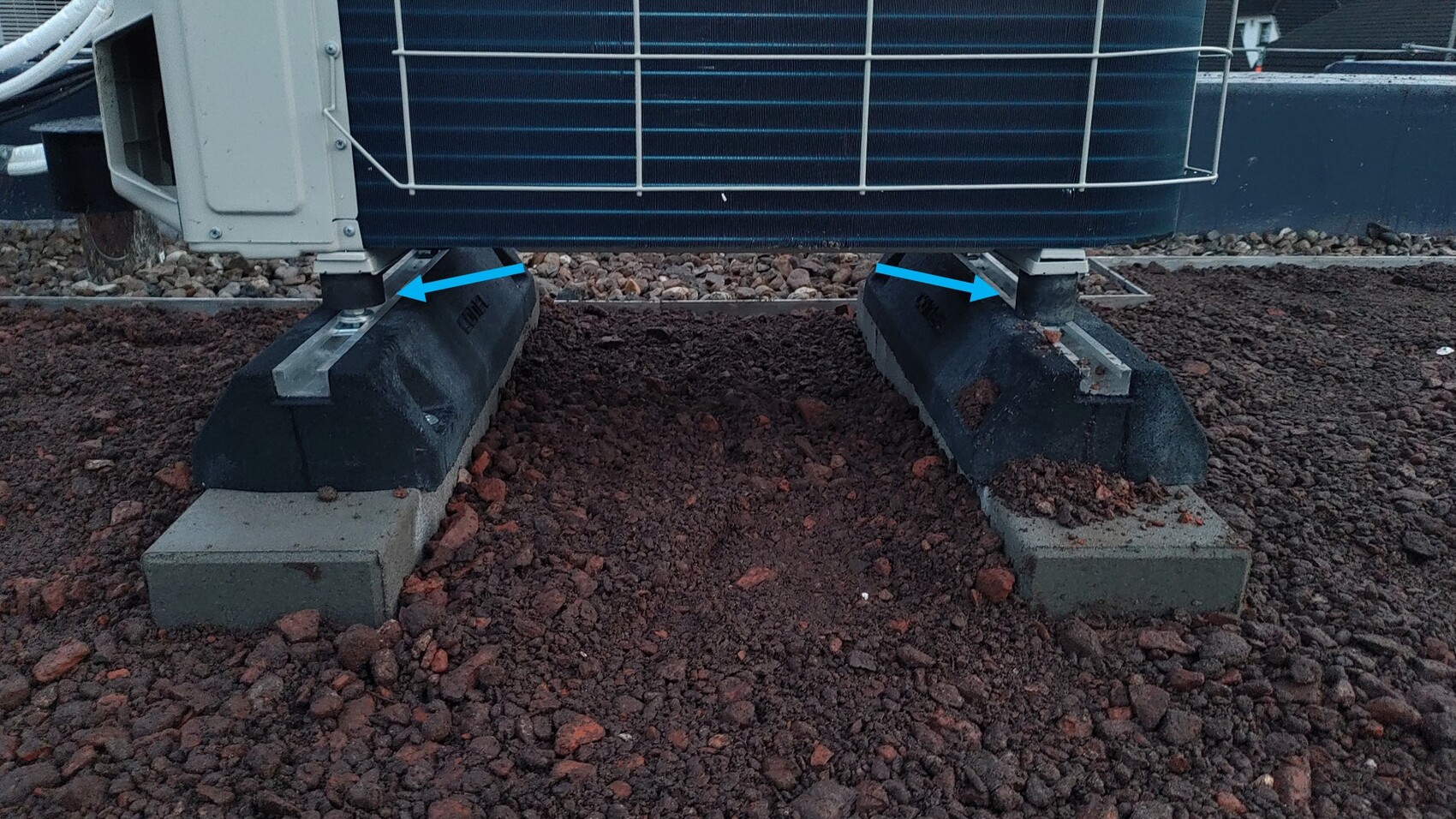

Outdoor unit model: Daikin Altherma 3R (I believe, see photos in the link below), placed on small, round vibration isolation feet on vibration dampening beams, which are mounted on concrete beams that are reportedly (I cannot see, as there is green roof substrate on top) resting on vibration isolation mats.

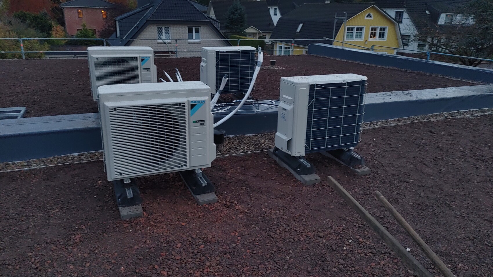

Nik_Hamburg5 Apr 2024 10:38Rübe1 schrieb:
If they were finally installed like that, there is another problem. One pump always ends up with the "cold" air forced onto it, which causes a significant loss of efficiency. How **** do you have to be...Oh yes, I hadn’t noticed that either (thanks also for Tolentino’s comment). They must have had some idea behind it, though I don’t know what. It makes sense (or not) that one device has to deliver more power because it gets the cooled air from the other. If you were to reposition them now, should two devices facing each other blow air towards one another or away from each other?

One more question: I accidentally noticed in a photo (attached) that the small, round, black feet under the unit were installed differently (once with a gap to the beam, once without). Could this be a problem?

WilderSueden5 Apr 2024 10:48Nik_Hamburg schrieb:
They must have had some idea behind it, but I just don’t know what. It looks better. Otherwise, I wouldn’t assume anyone really thought this through. In my opinion, the correct setup would be to draw air in through the middle and have both heat pumps blow away from each other. Ideally, this should also be arranged so that the adjacent heat pump is not directly in the exhaust airflow.
Oh yes, I hadn’t noticed that either (thanks also for Tolentino’s comment). They must have had some idea behind it, but I just don’t know what.They didn’t think about it at all. They’re not paid to think ahead. If (as mentioned: if) there was a plan, then the planner is responsible and the pipe fitter just carries it out. But really, he should have raised concerns at least. This photo should be sent to Daikin as a warning example of the nonsense their specialist contractors sometimes do.Either they are all lined up, which of course looks bad and might cause other issues, or at least staggered so none get the direct cold air from the others. As it is, it definitely cannot stay. I also consider turning two of them around to be suboptimal. If one runs on low speed and the other suddenly goes full power for some reason, they will interfere with each other… But since Mr. Daikin cares about the quality of his installers, he should come up with a constructive suggestion…
One more question: I accidentally noticed in a photo (see attached) that the small, round, black feet directly under the unit were installed differently (once with a gap to the beam, once without). Could this be a problem?No, they were simply leveled to make sure the unit stands straight. Just like with your washing machine.Similar topics
