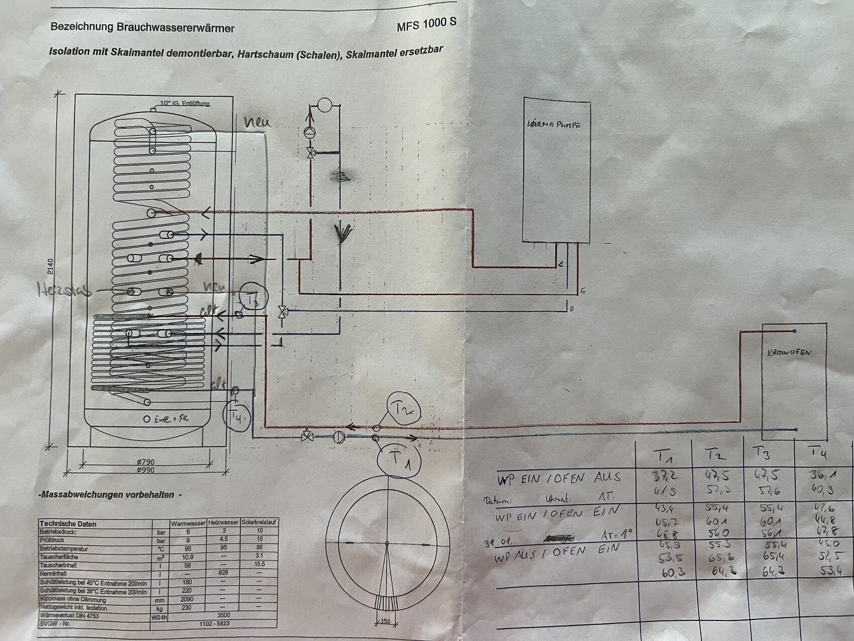

I am attaching the schematic of the storage tank layout.
The stove was initially connected under “old” and now it has been modified.
Everything works fine as long as the underfloor heating is off.
When the underfloor heating is on, our hot water temperature doesn’t exceed about 55°C (131°F).
When the underfloor heating is off, the temperature ranges between 65–75°C (149–167°F), either via the electric heating element during sunshine or by stoking the stove.
Now, however, this energy seems to be wasted. It can’t be that the underfloor heating requires 70°C (158°F) supply temperature to achieve a flow temperature of 35°C (95°F), right? The return water is only slightly cooler. So the water should only need to be heated by a maximum of 5°C (9°F).
We assume either a) something is still connected incorrectly, or b) the cold water from the underfloor heating causes such circulation that the hot water cools down within minutes.
What can be done about this?
Has anyone experienced similar problems?
Normally, we should almost run without electric power, but currently the heat pump switches on almost every hour to heat hot water…

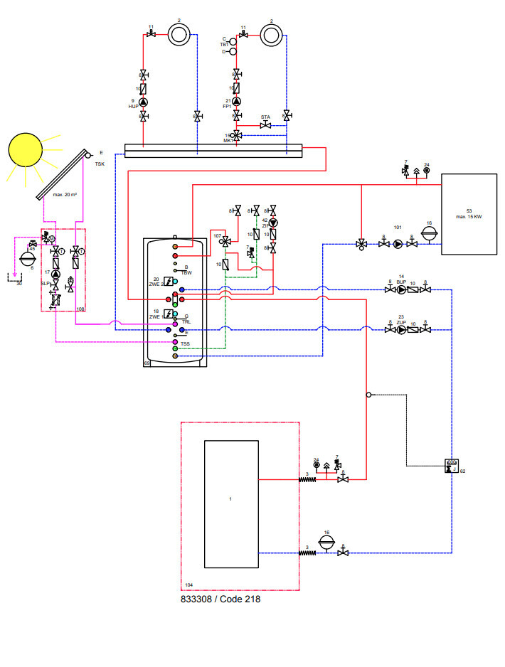

What I find much more interesting is the question of how the hydraulic integration has actually been done. Something like this, for example?

Jessica38821 Oct 2023 12:26KarstenausNRW schrieb:
No, but the optional heating element with up to 27kW (36 hp) does heat the buffer tank quite well. The 27kW (36 hp) can definitely be considered significant...
And indirectly, the domestic hot water is heated as well, since it is warmed by the heat exchangers inside the buffer tank.
I find the question more interesting how the hydraulic integration was actually done. For example like this?
Take a look. This is what we received and I have now added to it. The stove currently has 4 connections, so we can choose. At the moment, it is set to "new."
