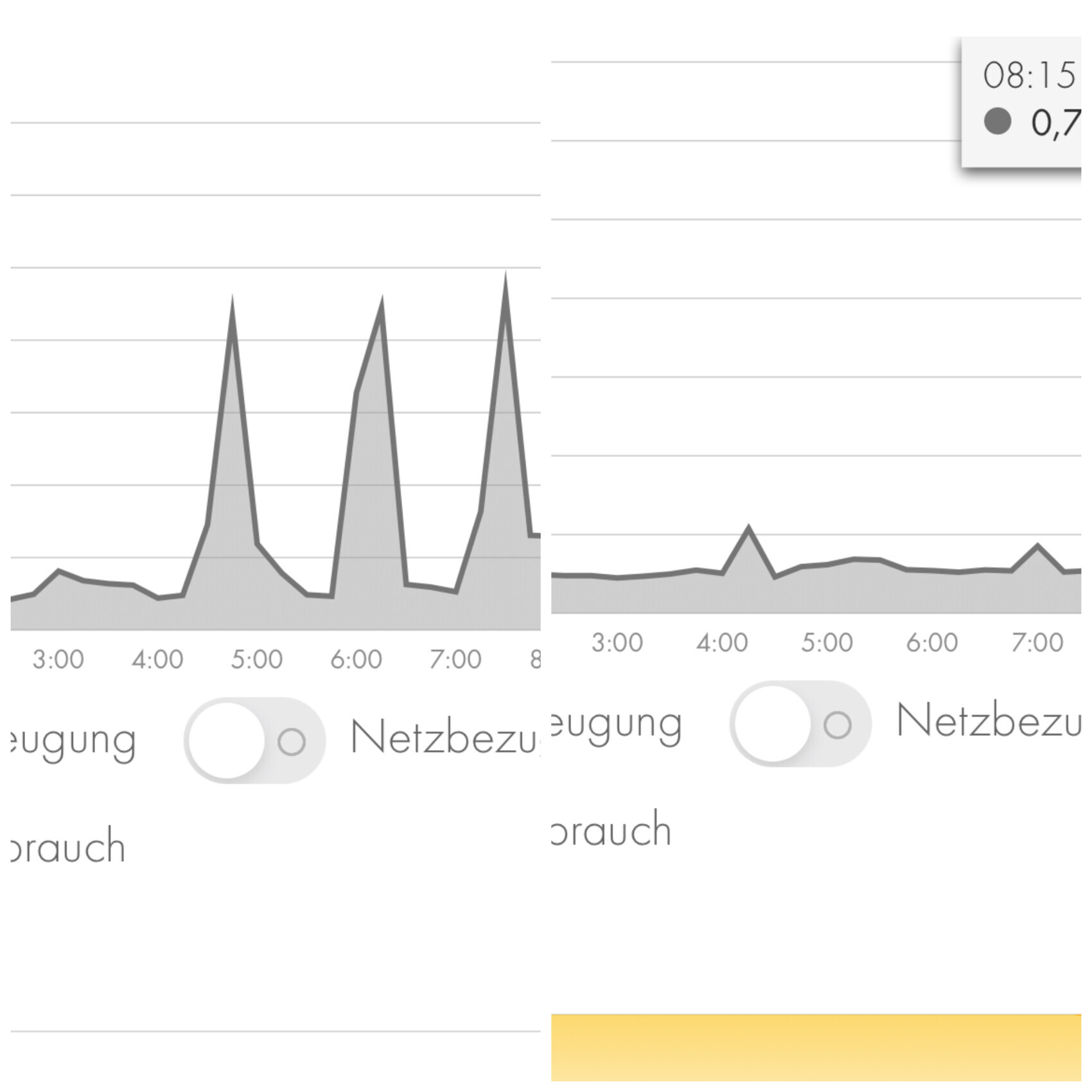

Jessica38822 Oct 2023 09:38RotorMotor schrieb:
That’s just the household electricity consumption.
Or where do you see anything showing the heat pump’s consumption?
The heat pump keeps having peaks, which is also called cycling.
It simply can’t release the heat because 90% of the rooms have their thermostatic valves almost closed.
Lower the heating curve to 0.4 and open the room thermostats, then we’ll check back in a month. ;-) @RotorMotor @Mycraft and of course good morning to everyone else!!!! Last night was great!!!! The heating engineer can hear it, and I want to thank you all sincerely.
Comparison between yesterday and last night.
We’re super satisfied, what do you think?
Any more tips?

RotorMotor22 Oct 2023 11:54Those are already some good news!
Now, it might be necessary to wait and see how the temperatures behave inside the house.
Will it become uncomfortably warm or cold in certain rooms or even throughout the entire house?
If so, adjustments will need to be made specifically to the heating manifold or the heating curve.

Jessica38822 Oct 2023 12:24RotorMotor schrieb:
That’s already good news to start with!
Now you might need to wait and see how the temperatures behave inside the house.
Will it get uncomfortably warm or cold in certain rooms or even throughout the whole house?
If so, you will need to make targeted adjustments to the heating circuit distribution or the heating curve. Understood. We are also very curious to see how it performs in colder weather and whether the stove will actually warm the water or if the energy just goes into the floor again.
When it gets cold, I can first try raising the desired room temperature, right? Because at 19°C (66°F) the setpoint was already quite low, wasn’t it?
