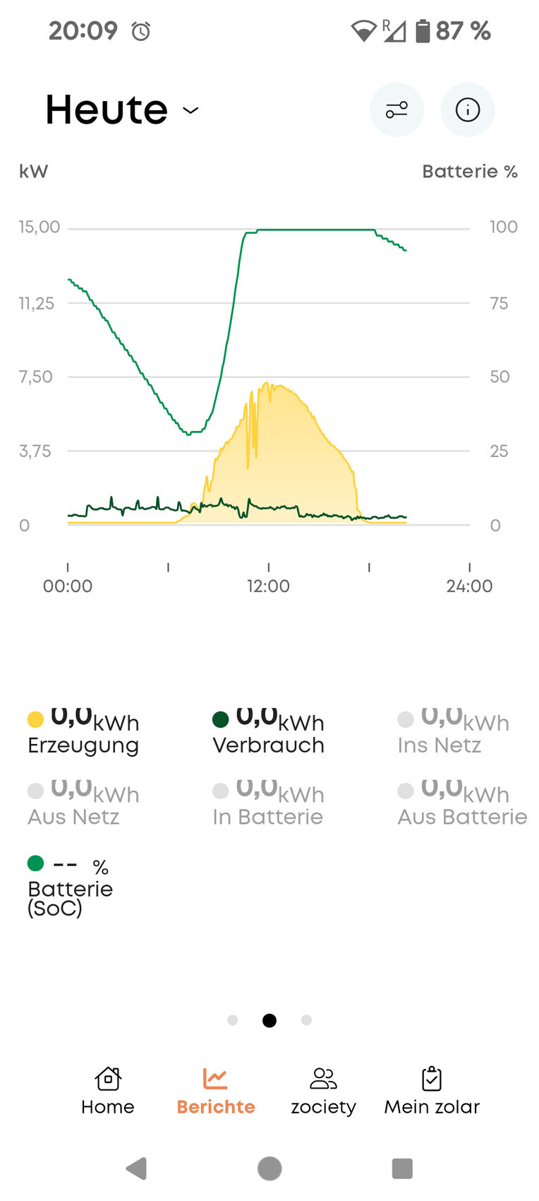

We have a heat pump and photovoltaic system with storage.
We try to shift consumption to different times of the day.
Night setback by 3 degrees,
hot water overheated to 60°C (140°F) at 4 p.m.,
otherwise automatic operation.
Our house only loses about 1 degree overnight.
Whether I supply, for example, 10 kWh heating power during the day or at night makes no difference.
The underfloor heating is simply too slow for that.

What kind of insulation does your house have that it only loses 1 degree overnight?Better than KfW 40 standard, but this applies only down to 0 degrees Celsius (32°F).
At temperatures between -10 and -20 degrees Celsius (14°F to -4°F), the heat pump runs continuously, using 0.7 to 1.5 kWh of electricity, which easily drains the battery.
For example, last night with 0 degrees Celsius (32°F) and while we are on vacation.
