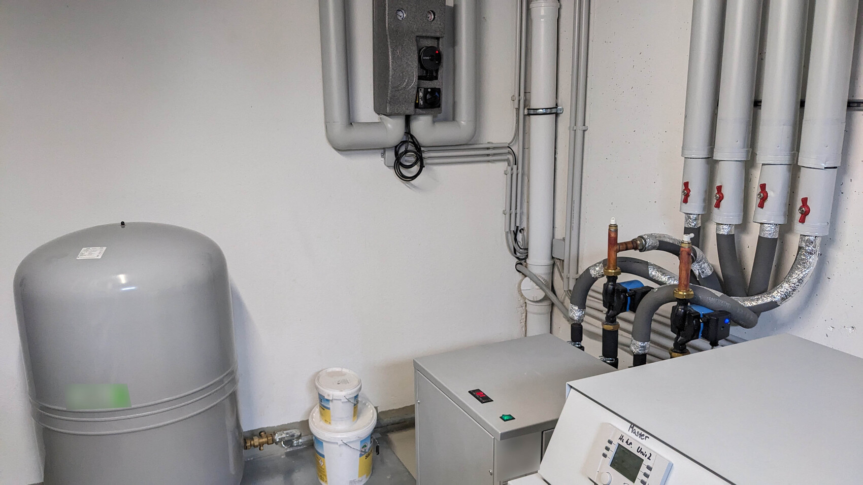

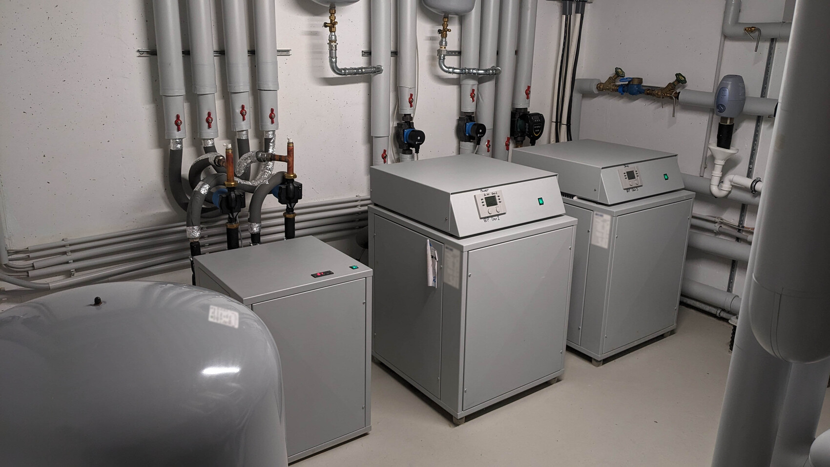

The technical room is located below our apartment, where the heat pump is installed. Inside the technical room are two large compressors and one smaller compressor, see pictures.

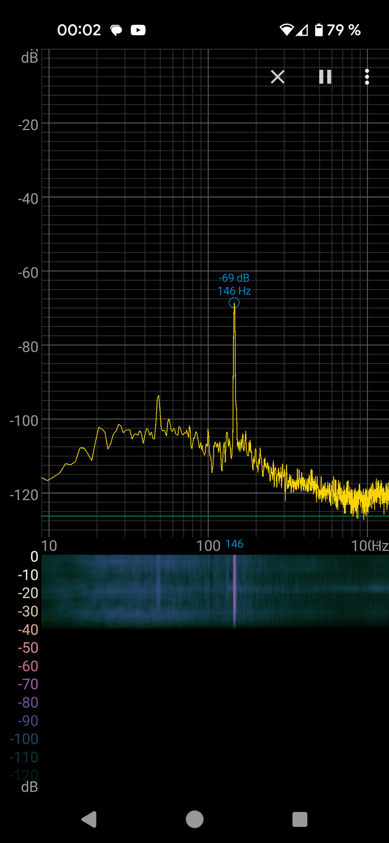

The humming always has the same frequency – 146 Hz, see pictures.

Does anyone have an idea why the humming is so dependent on temperature in this case? What exactly is causing the humming, or what could be transmitting it so well into the building, especially at such a distinctive frequency of 146 Hz?

Three industrial washing machines in a technical room with pipes, valves, and pumps
Basement room: heating system with insulated pipes, two expansion tanks, and pumps.
Spectrum diagram with peak at 146 Hz and -69 dB; noisy curve below.

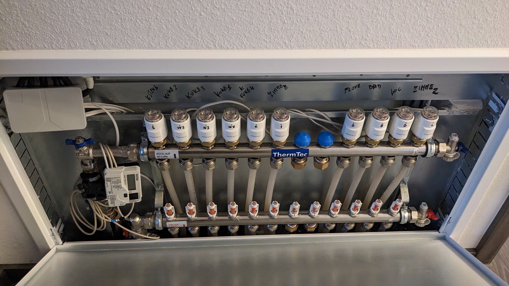

Did you also open the valves of the underfloor heating/radiators in the apartments during the measurement? What about the pumps?
Thank you for the first response! No, we have not checked the valves. Which pumps do you mean?
What is your suggestion? We also tested it earlier: there is no humming when the compressors downstairs are off, a slight humming when only one large compressor is running, and a strong humming when both run. The small compressor has very little effect.
I have also attached a picture showing how it looks inside the apartment.

sysrun80
4 Mar 2024 08:23
andriy_melnyko schrieb:
Thank you for the initial response! No, we haven’t looked at valves. Which pumps do you mean?
The heating circuit(s) have pumps that may be modulated, meaning they are controlled according to demand.

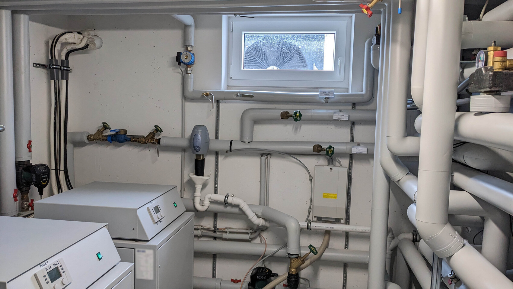

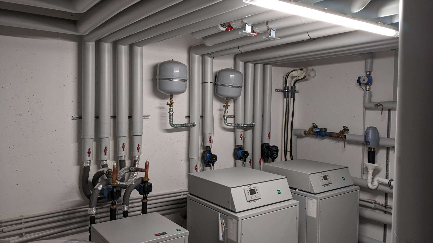

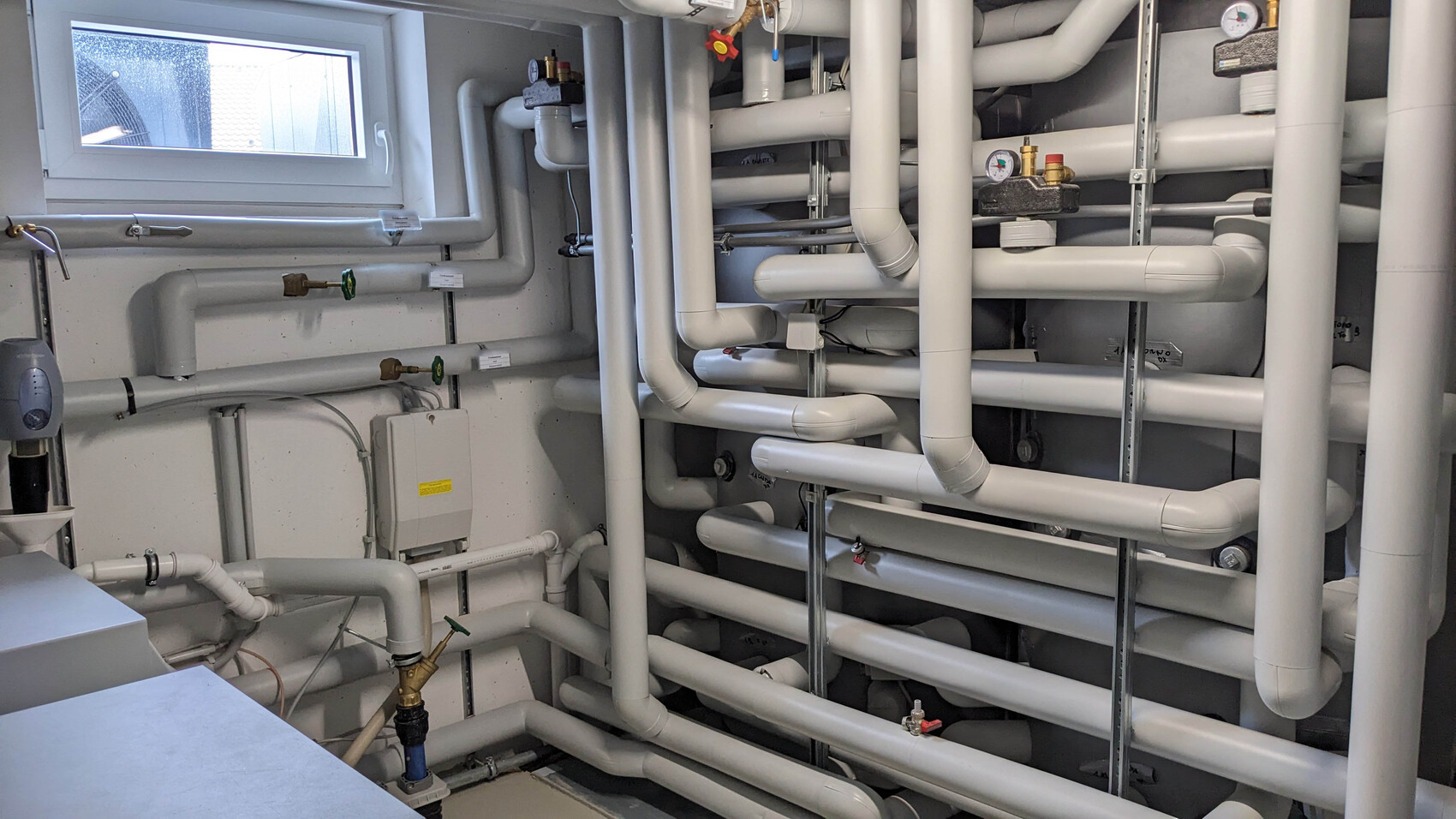

Can you see the pumps in the photos? I have attached a few new pictures.
Basement room with large pipes, valves, pumps, meters, and a window in the background.
Mechanical room with many white pipes, valves, fittings, and measuring devices.
Mechanical room with expansion tank, pipes, valves, and control unit.
