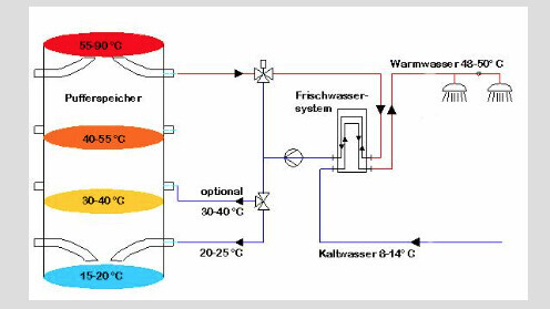

007sascha21 Nov 2025 12:14Fresh water station or domestic water storage tank? One or the other, but not both However, I still need to supply the fresh water station with hot water, and for this, a buffer tank is necessary, right? Or is the floor heating used as a buffer for the fresh water station as well? The low floor temperature alone is not sufficient. Most likely, this is just a terminology misunderstanding—I understand the fresh water station as the heat exchanger for the fresh water. If the fresh water station refers to a complete unit including the buffer tank, then clearly no additional buffer tank is needed.

nordanney21 Nov 2025 12:27007sascha schrieb:
But I still have to supply the fresh water station with hot water, and for that a buffer tank is necessary, right? A buffer tank makes sense (and therefore also the entire floor heating circuit, since everything is connected). However, a domestic hot water storage tank is something different (this stores hot water for showers, etc.).
The fresh water station (the storage tank is naturally heated by the heat pump) – the heat exchanger in the station transfers the temperature to the flowing domestic water, similar to a tankless water heater:

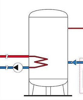

Domestic hot water storage tank:
The heat pump circulates hot water (on the left side) through a heat exchanger inside the storage tank and heats the domestic water stored inside. On the right side, you draw off hot water (at the top) while cold water enters from the main supply at the bottom.
Is that clearer now?

007sascha21 Nov 2025 12:38Now clear? Absolutely, we meant the same thing, I just called it by the wrong name. Thank you.
In your diagram, there is another optional three-way valve on the return line of the fresh water heat exchanger. Is this used to prevent turbulence in the cold water area to achieve the lowest possible inlet temperature for the heat pump?
nordanney21 Nov 2025 12:43007sascha schrieb:
In your diagram, there is another optional three-way valve on the return line of the domestic hot water heat exchanger. Is this to prevent turbulence in the cold water area in order to achieve the lowest possible inlet temperature for the heat pump? This is just a random diagram. In this case, it shows a stratified charging tank, which can have different inlets depending on the temperature.
