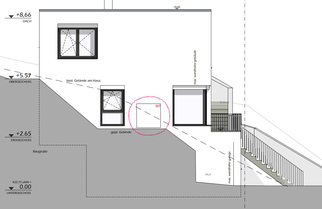

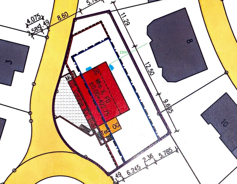

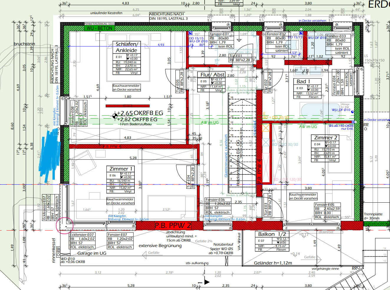

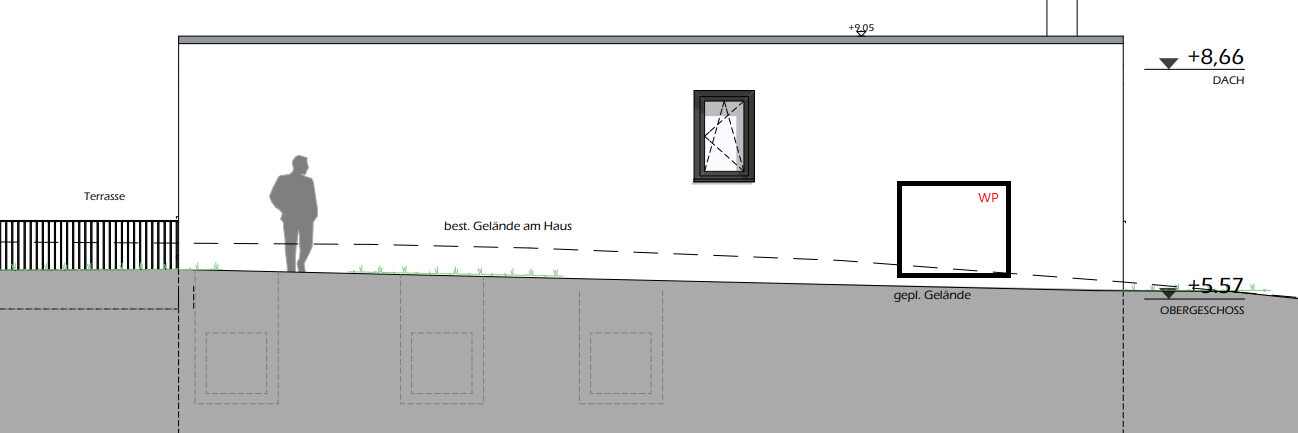

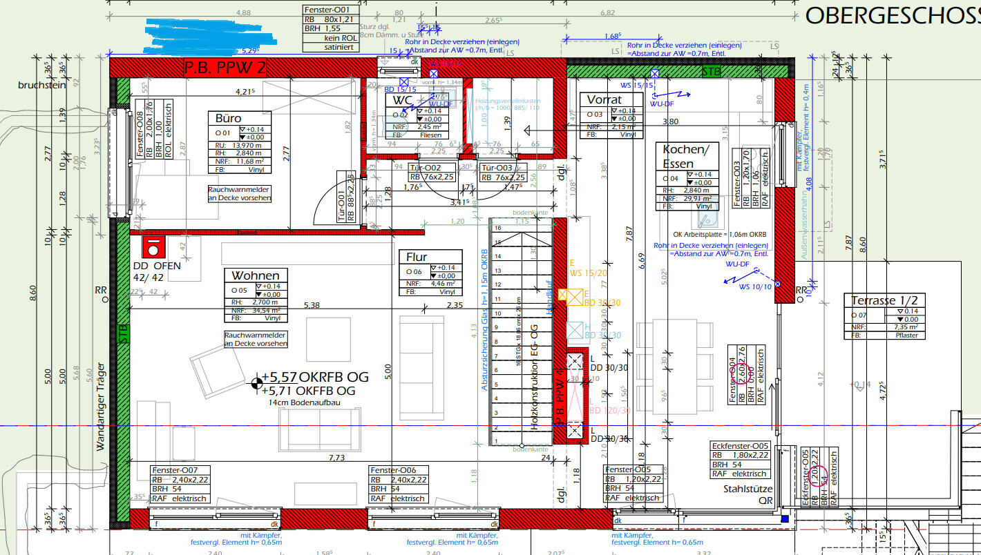

Thank you for the many opinions; that is already very helpful. Here are some plans to illustrate, with the two potential heat pump locations marked in blue. The distance to the neighbor’s building is about 13m (43 feet) (I had previously miscalculated), and the distance to the property boundary is almost 6m (20 feet). Of course, I don’t want to disturb the neighbors with noise, but I believe that at this distance it won’t be an issue, especially since there will also be walls that partly block the sound.
The heat pump piping has already been routed from the basement to the bedroom outside, and this area has been backfilled. Other locations are therefore difficult, also generally due to the very steep terrain. The question now is whether to extend the piping further and place the heat pump higher up or leave it where the piping currently ends (between the bedroom and the children’s room). When reviewing the plans, please note that our living floor, including the terrace and garden, is on the upper floor.
WilderSueden19 Jan 2023 11:21In winter, windows are usually kept closed. With 13m (43 feet), I don’t see any problem at all and definitely wouldn’t create an issue for myself out of misunderstood consideration.
