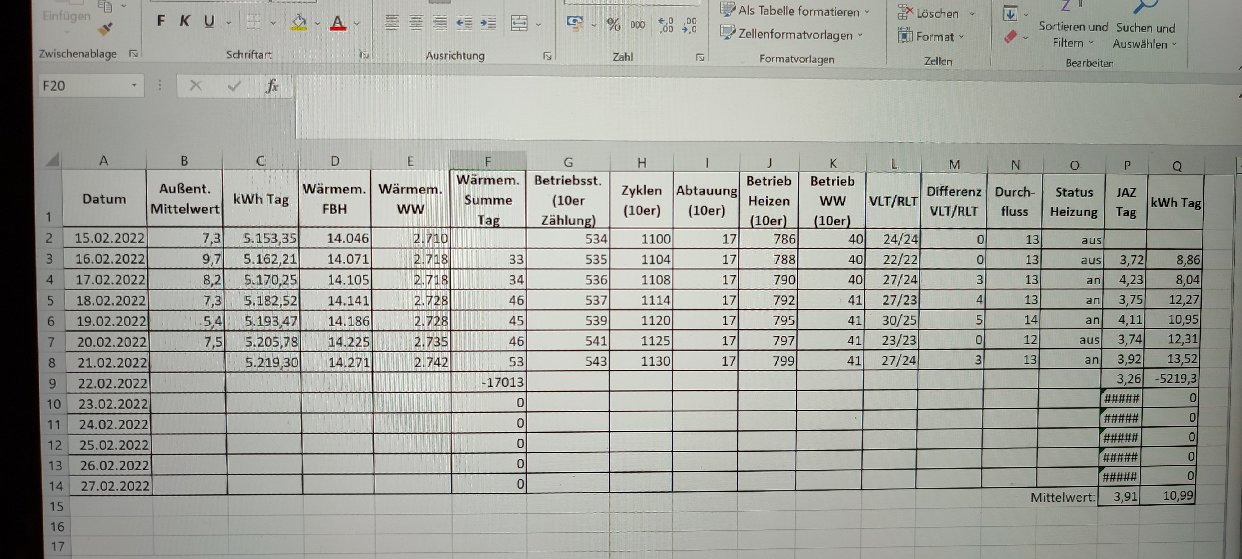

Tx-25Hello, our Elco aerotop Split 07 air-to-water heat pump cycles on and off every 30 minutes. A hydraulic balancing has been carried out. I have also disconnected all ERRs and removed the actuators. I have performed a thermal balancing to the best of my knowledge. However, the longest heating circuits were not fully opened during this process. I suspect that the heat pump is oversized, which might cause overheating, as the heating curve is already set to the minimum. I have attached a picture that logs all data from the last week. From this, I also observed that the heat pump currently cycles every 30 minutes. Additionally, the flow rate remains constant whether the pump is running or not. It must have been cycling since installation, as the unit already shows over 10,000 cycles after two years. I suspect this is all related to the settings. Therefore, I list some settings and general information below.

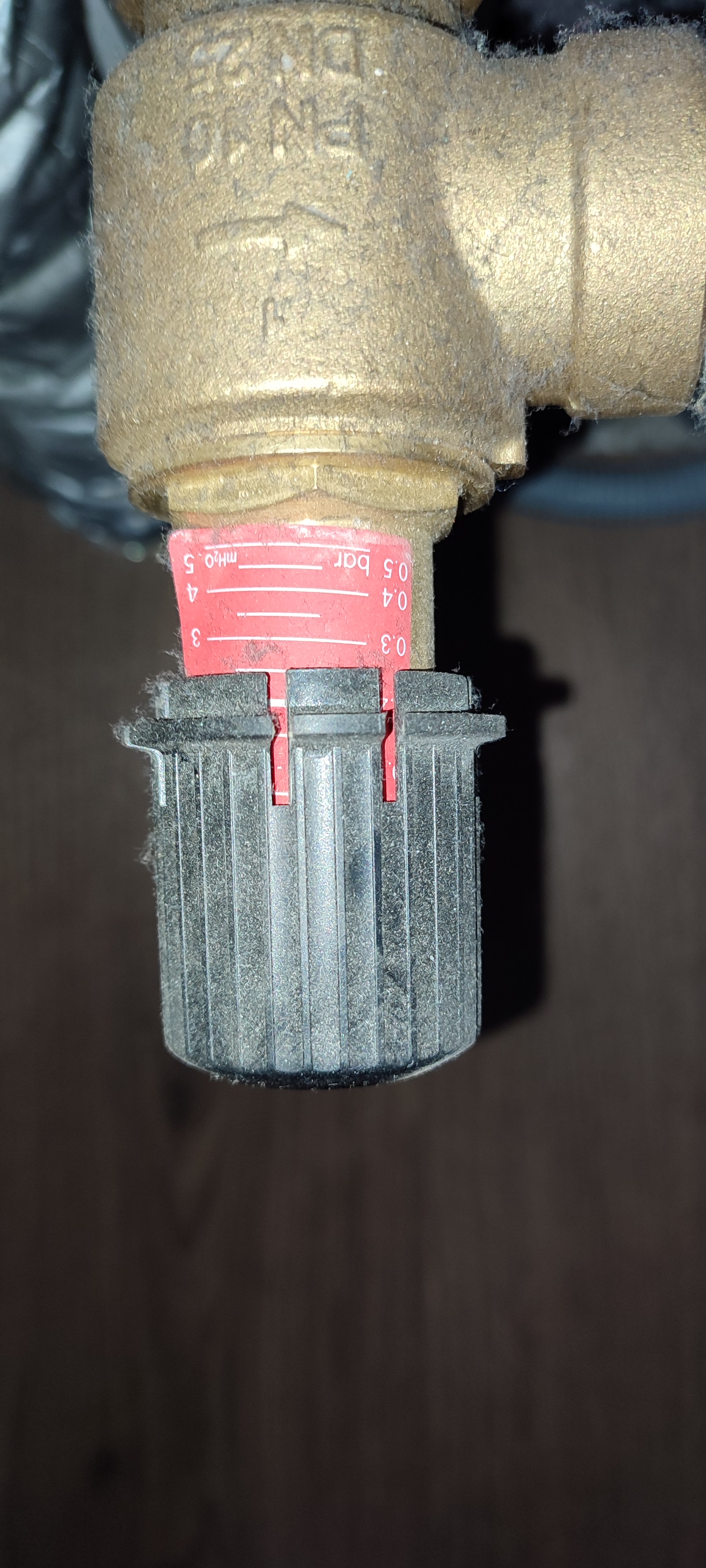

Bypass valve open, see picture
