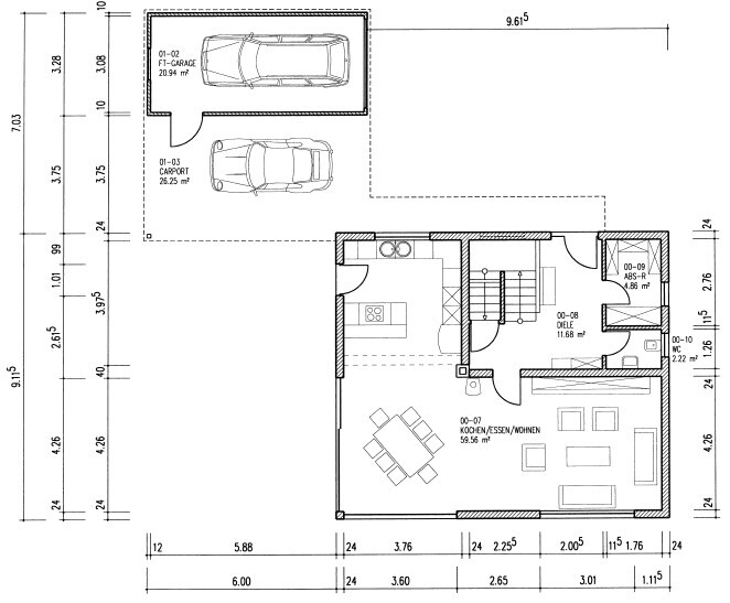

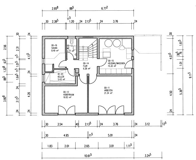

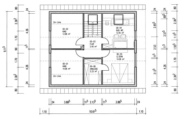

We would like to order the components for our heating system soon.
The following information is the basis:
- New detached house built according to legal standards
- Heated living area: 193 m² (2077 sq ft) (floor plans attached)
- Planned heat pump: ground source heat pump Bosch CS 7800iLW 8 F 8 kW
- Planned buffer tank: Stora WH 370 LP1B
- Drilling depth to be determined according to the system
- Designed for a household of 4 people
Questions: Do you consider the 8 kW ground source heat pump sufficient? Is the 350 L (92 gallons) buffer tank adequate? Is a second buffer tank for the heating water necessary?
Thank you very much and best regards

All I see are floor plans, not room-by-room heating load calculations. ;-) I’m not a heating engineer. I just wanted to show with the floor plans what I want to heat. These were given to the heating engineer, who then selected the storage tank mentioned above and the heat pump referenced earlier.
