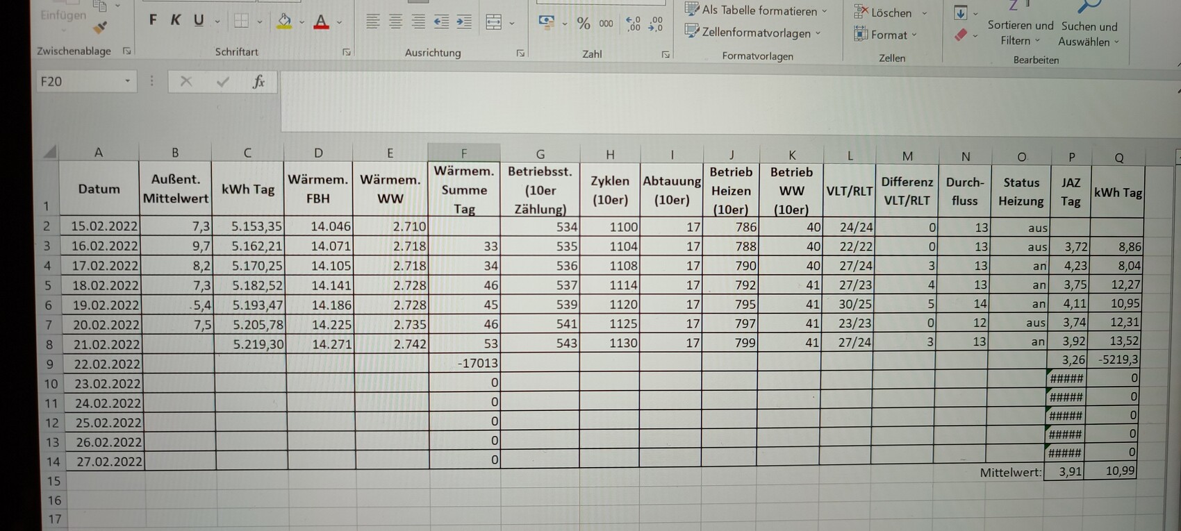

Hello, our Elco aerotop Split 07 air-to-water heat pump cycles on a 30-minute interval. A hydraulic balancing has been carried out. Additionally, I have disconnected all ERR valves and removed the actuators. I performed a thermal balancing to the best of my knowledge. However, the longest heating circuits were not fully opened during this. I suspect the heat pump is oversized, which might cause it to overheat. The heating curve is already set to the minimum. I have attached a picture noting all data from the last week. From this, I also gathered that the heat pump currently cycles every 30 minutes. Furthermore, the flow rate remains the same whether the pump is running or not. It must have been cycling since installation, as it has over 10,000 cycles recorded after 2 years. I suspect this is all related to the settings. Therefore, I list below some settings and general data.

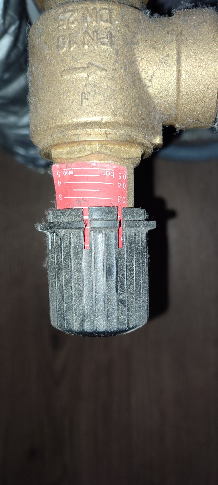

Bypass valve open as shown in the picture

During operation, the system shows the following values. As I have already been told, it is strange that the hot gas temperature is so low.
Evaporator temperature 0°C (32°F)
Suction gas temperature 2°C (36°F)
Hot gas temperature 28°C (82°F)
Condenser 24°C (75°F)
Compressor 23 Hz
Speed 625

close the main valve when you have deactivated the ERR... Today, I turned it all the way to the right to increase the triggering pressure. I will see if that helps. I have just noted the cycling rates.
