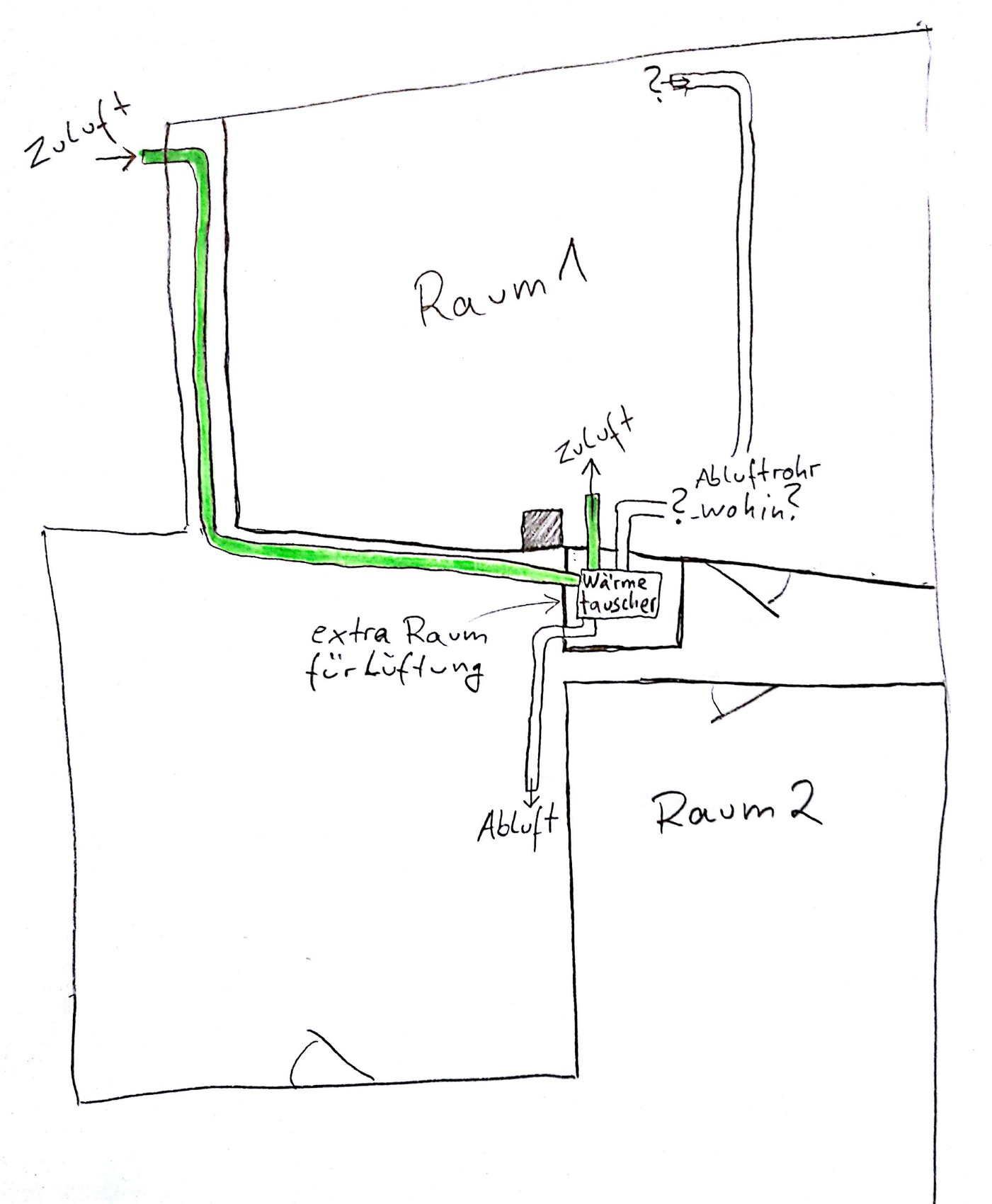

I am about to build my own recording studio. It’s not for commercial use, just for fun, so I can’t afford professional companies to design and build it for me... However, I have a friend who knows a bit about ventilation systems and will help me with the construction.
I am considering installing a cross-flow heat exchanger with silencers and a heating coil that will warm the air a few degrees after heat recovery.
A few questions:
- Rooms 1 and 2 should be acoustically as independent as possible, meaning minimal sound transmission. The ventilation openings in the wall are disadvantageous from a building acoustics point of view, but cannot be avoided. Therefore, I’m thinking about installing the ventilation unit in a separate room (e.g., 1m x 1m (3.3 ft x 3.3 ft)). This way, the spots in the wall where pipes go through are separately built-in. Does this make sense? Should I also encase the entire supply air duct (green, on the left) in this case?
- Where should the supply and exhaust air openings be placed in Room 1 for best performance?
- Air exchange rate: the room has 100 cubic meters (3,530 cubic feet) of volume. For office use, a 6 times air exchange rate is specified. Since I will mostly be alone in the room, would a lower rate suffice? Also, 20-30% of the volume will be occupied by absorbers, meaning porous material wrapped in fabric that allows little to no air circulation. Can I subtract that from the total volume? Would a central heat exchanger unit with 300 cubic meters per hour (177 cubic feet per minute) then be sufficient?
- Can you recommend a particular heat exchanger? It must be especially quiet!
- Such devices always specify a range of cubic meters per hour. Which value should I use? Again, quiet operation is the top priority here.
Thanks so much already, your help means a lot!
A few questions:
