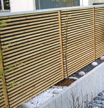

There are noise barriers made of wood, which can be designed quite nicely.
For example:
Wooden slat fence as a privacy screen in the garden next to a gravel and stone bed
or vertical slats as well.
