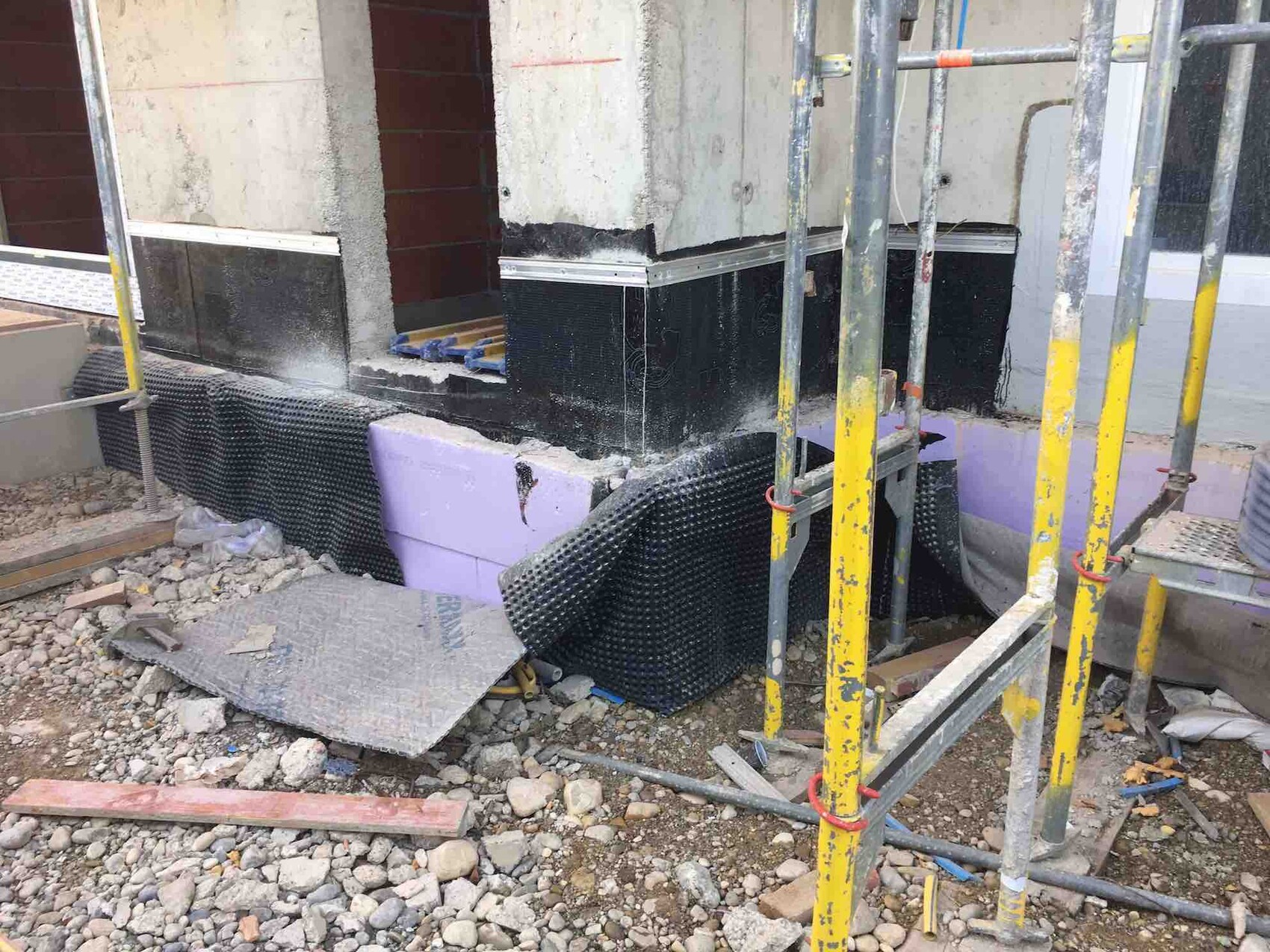

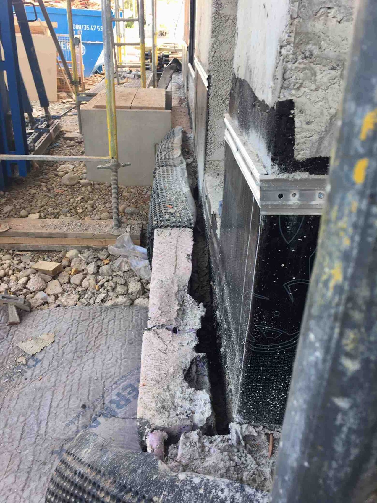

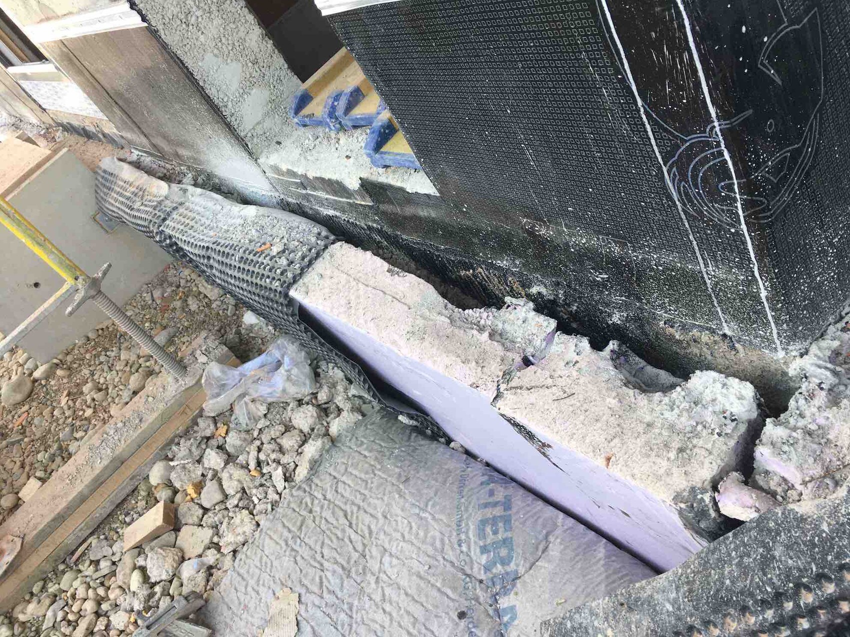

Today, we were near the construction site and managed to take a look at our future apartment from the outside. We noticed that there is quite a large gap between the insulation and the reinforced concrete wall at the top of one of the basement walls (see photos attached).
We are complete beginners when it comes to construction and, of course, still have a lot of time before we take possession of the apartment (expected move-in date is autumn 2019). Still, we would like to know whether this might be a problem, especially since the insulation will no longer be visible during final inspection. Therefore, our questions are:

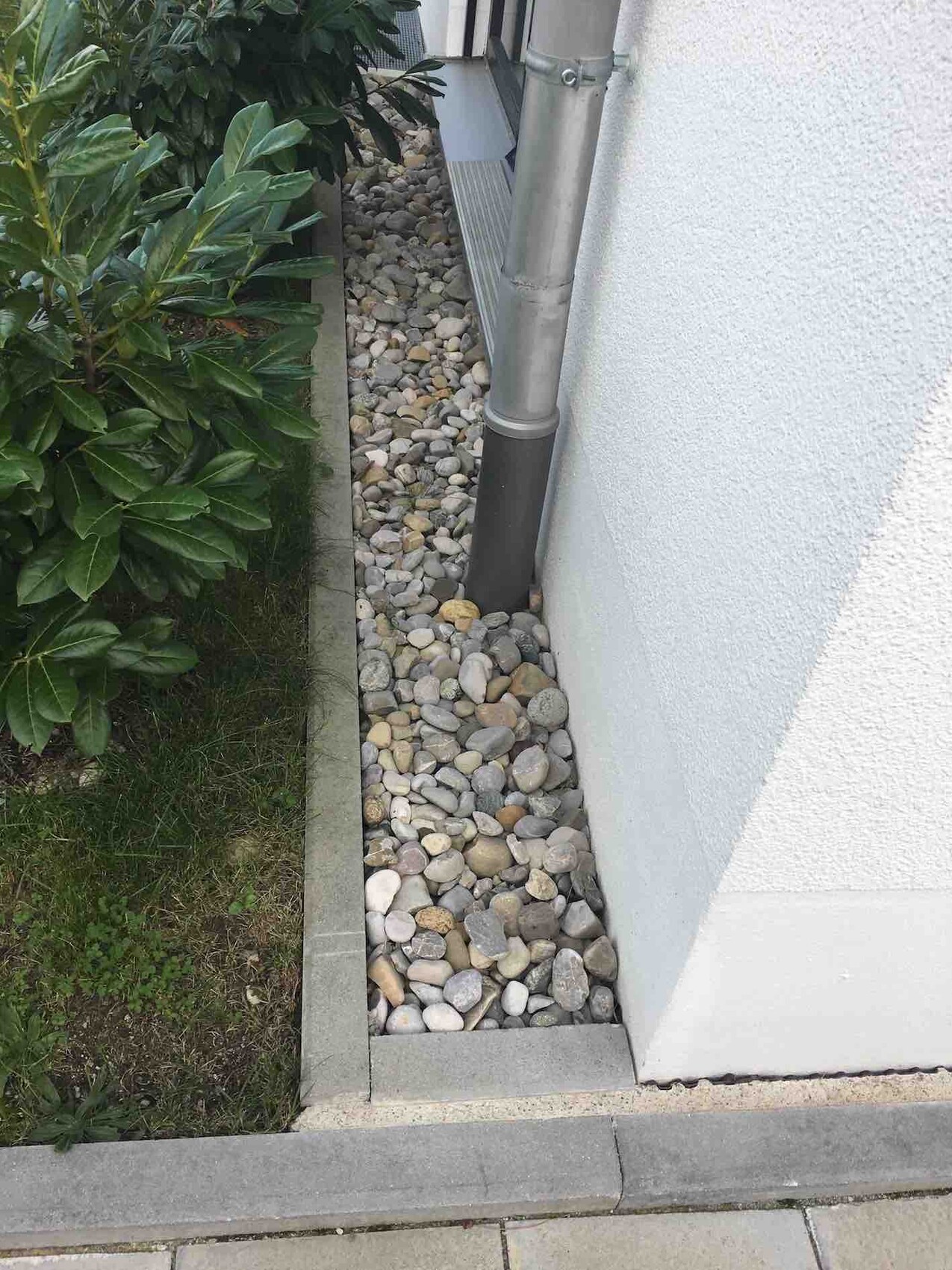

- Is this gap at the top actually an issue, or will it most likely be resolved as construction progresses? In photo 4, you can see how the transition from the wall to the lawn will look once completed (previous construction phase by the same developer).

NeuMünchner22 Sep 2018 19:04If it needs to be glued, wouldn’t they at least have to redo the part where the large gap is?
Whether to glue or not is a matter of preference; the manufacturer specifies at least spot gluing depending on the load case. However, dowels are also commonly used.
What is important, as already mentioned, is that the insulation must fit flush; there must be no gaps!
This looks terrible and definitely needs to be redone.
NeuMünchner22 Sep 2018 20:06Thank you for your feedback! I will write to our project manager and politely point out the issue.
