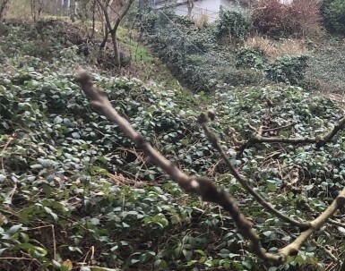

If these are the contour lines, please take a photo. The area where excavation took place must be quite steep. If contour line #4 runs along the street, then the street itself has very little slope.
How did the neighbors build? Garage inside the house? It would be a good idea to consult the building authority to see how strictly the old development plan is still enforced. There might also be a local parking space regulation. Where do you plan to park the customers’ cars? Unfortunately, I’m not very familiar with Hamburg.

As you can see in the photo, the first section is indeed very steep.

Oktopus schrieb:
As you can see in the photo, the first section is indeed very steep. As you can see in the photo, the level of complete unrecognizability is clearly higher than that of usefulness :-(
I’m out.
As you can see in the photo, the level of complete non-recognition is clearly higher than that of usefulness :-(
I'm out. You can’t see more because we don’t have better photos. This is not due to any ill intent or laziness on my part. We already had to push our way through thick bushes to get this picture. Below is not a road but a densely overgrown agricultural plot. From above, the neighbor’s entire garden is visible if you photograph the edge, and I don’t want to post such a photo without their consent. When I take pictures from the center, you can only see broccoli.
The slope is visible along the path at the top right and at the neighbor’s fence.
