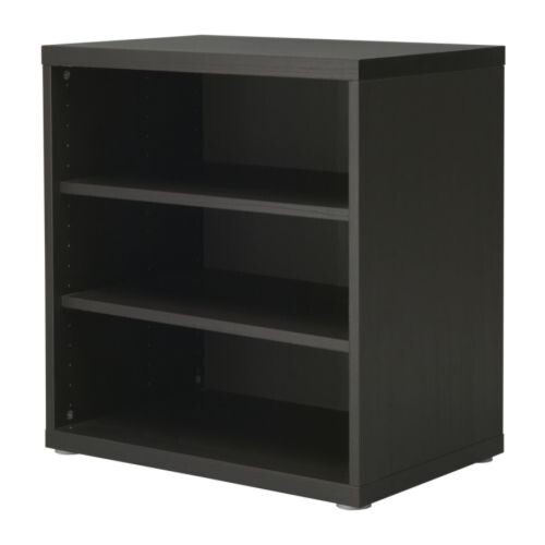

This week, I put together a wall unit from the Besta system at IKEA, but I need to hang two of the pieces on a concrete wall.
The two pieces are the following:
What kind of anchors and screws would you recommend for mounting them on the wall?
