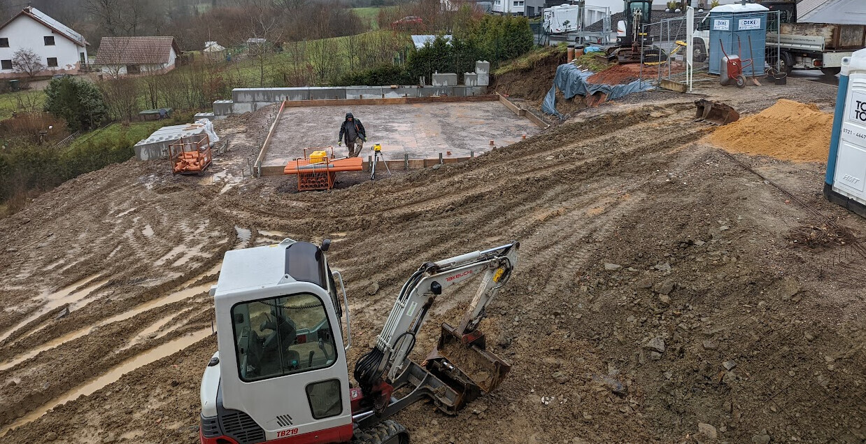

Good evening everyone
I’m starting a small collection thread here for photos and progress updates on our second building project.
We’ve already moved to the Palatinate region to be closer to the construction site. Now we’re watching eagerly and happily as our (hopefully final) dream home takes shape near family.
One big challenge still ahead of us is the facade design. I really love the Nordic style with brickwork and mullioned windows. That won’t be possible here for two reasons: firstly, no one here can do bricklaying, and secondly, it would stand out too much. We will be going with a rendered facade. How to design the colors of the facade and windows to still create some country house / cottage charm is currently still a work in progress mentally.
Otherwise, I’m sharing our plans here and how it will eventually be built.

Costruttrice8 Apr 2023 23:14I would definitely stabilize the terrace slope as a first step.
Slopes are unfortunately an expensive undertaking. We are building across the slope, and our lot also rises towards the back. We received an initial quote from the landscape contractor last week, and I was speechless—especially the costs for the stairs were quite high.
We now need to reconsider how to approach this. However, we will definitely have the terrain shaped and stabilized in the first phase so that no heavy machinery will be needed afterward.
It’s really a question of how to secure the terraces.
I find those concrete blocks that everyone is currently putting in their gardens extremely ugly. :/
In our case, the slope doesn’t lead down to a lower garden level; the property basically ends just behind the slope. I think that makes it even more challenging. So far, I like the idea of terrace beds the best. But there are a thousand different design options, and I don’t feel confident installing them myself. You would probably need to hire a landscape gardener, but I’m also worried that would exceed the budget.
