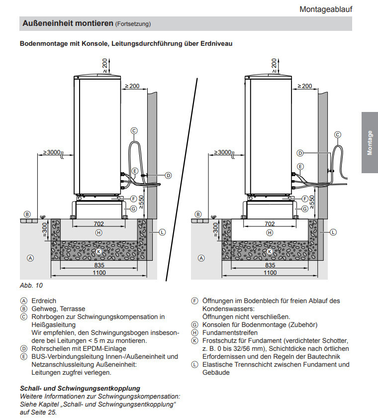

RotorMotor22 Oct 2023 20:55Why do the pipes behind the heat pump bend upwards? Shouldn't they bend downwards?
RotorMotor schrieb:
Why do the pipes behind the heat pump bend upwards? Shouldn’t they bend downwards?Upwards is what is shown in every example in the installation manual.
R
RotorMotor23 Oct 2023 08:23"Interesting" that the manufacturer illustrates it like this in the manual.
The upward slope of the floor ensures that any water (rain + condensation) flows along and into the exterior wall instead of dripping down at the lowest point of the curve.
If you’re unlucky, that won’t help. Condensation can still form and will then run freely into the wall. The loop is necessary, but I would always make sure the pipes rise slightly in the last few centimeters (inches) before reaching the wall. Otherwise, it will cause problems.
