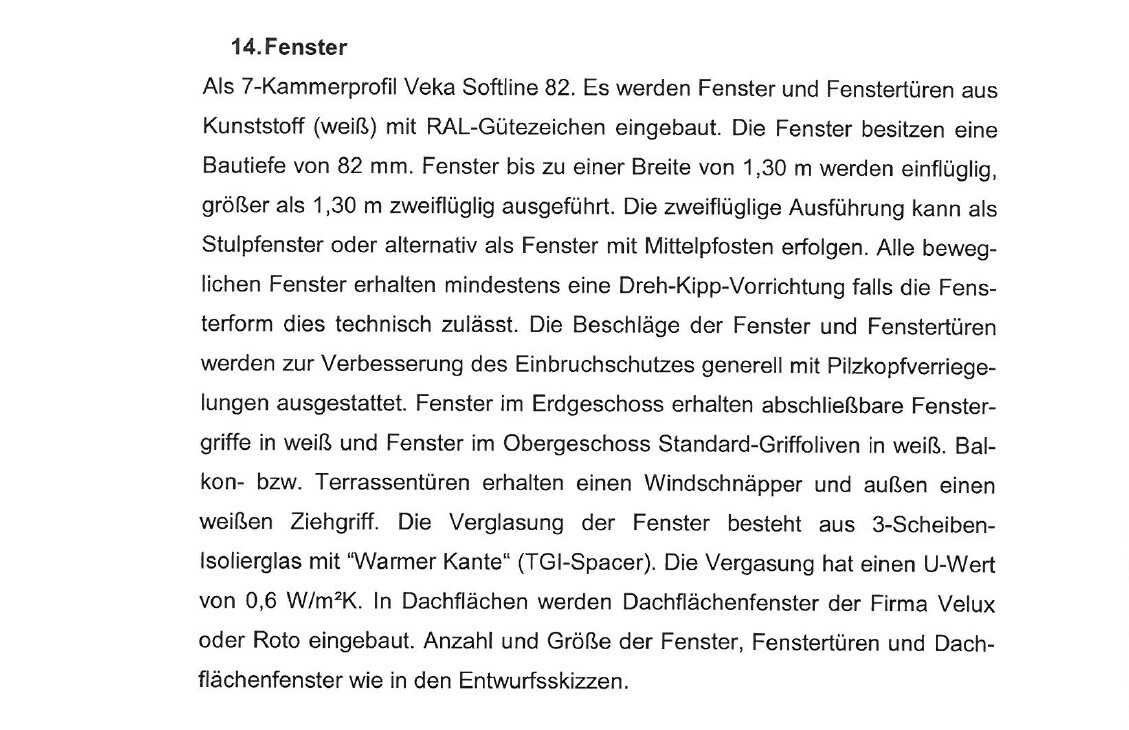

What does the offer say about the handles and fittings? Our construction contract's scope of work specifies the following regarding the windows:
In the special agreements, we have also documented the customized color.

Our construction contract’s scope of work includes the following regarding windows:Did you receive exactly what was specified in the scope of work? That was a rhetorical question – yes, you did. I don’t see anything about specially agreed handle positions.Just check it off. You really get used to it quickly.
