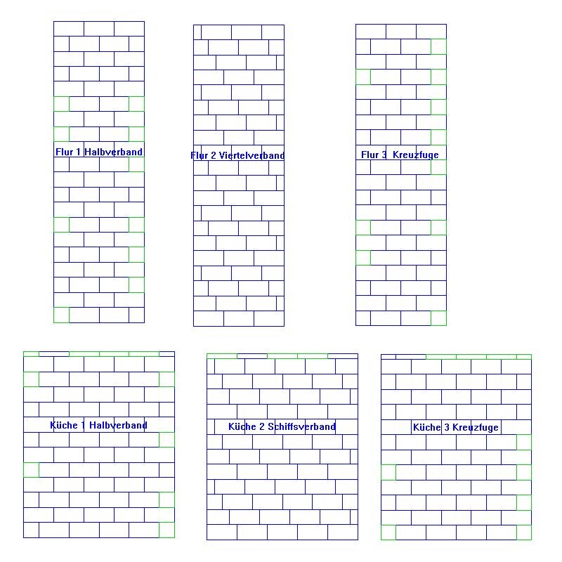

Hello questioner,
This is a difficult topic you are bringing up, as it is closely linked to the aspect of aesthetics. What looks visually appealing to one person may be rejected by another. Therefore, no answer can be given to your question, since only your personal taste will determine which tile installation pattern will be used.
I have prepared the hallway and kitchen areas based on the room and tile dimensions you provided (see attached photo). The proportions correspond largely to your living space.
Now you can decide for yourself which laying pattern you prefer.
If you are interested in my personal opinion:
The grid joint pattern gives a certain sense of order visually. The half-bond pattern creates a more dynamic overall look, while the quarter-bond and herringbone patterns make the surface appear very busy. The latter seems to me to be a way to wake up immediately in the morning when looking at the tile surface 🙂
The aspect of “extra material consumption depending on the installation pattern” is actually minimal! Since this question came up from another source, I quickly calculated it.
For “Hallway 1” and “Hallway 3,” you will need 60 tiles each; “Hallway 2” requires 65 tiles.
For “Kitchen 1” and “Kitchen 3,” I calculated 62 tiles each; “Kitchen 2” requires 65 tiles.
Wishing you a good decision: KlaRa

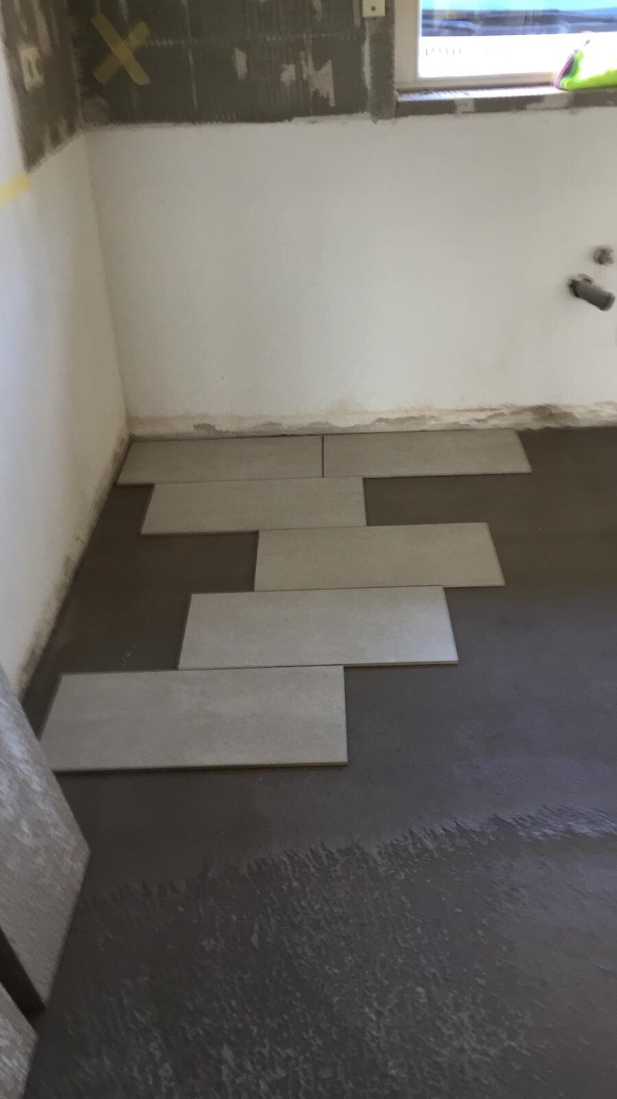

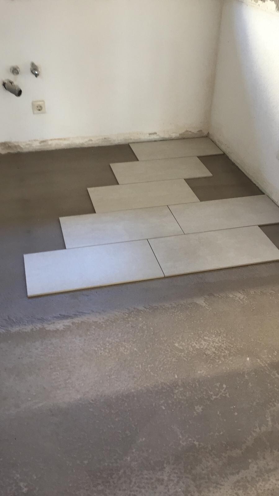

HubiTrubi4011 Feb 2022 16:23motorradsilke schrieb:
Just lay them out on a piece of floor and then decide.
I think it’s hard to give advice on this, it’s a matter of personal taste. @KlaRa Thank you so much for your response! That’s really great. And thanks also to @Tolentino, @netuser, and @motorradsilke for your replies. I spoke with the tiler today while he’s preparing, and he advised against a "random" pattern because the tiles are apparently not perfectly flat and have a slight curve. He said that a 1/3 offset pattern would also work, but the risk of interlocking (?) would be higher. I didn’t buy the tiles at a big-box store, but from a specialist tile retailer, though he said it’s quite common for tiles not to be completely flat. He sent me two pictures showing the difference between a 1/3 offset and a random pattern (see attachments). The 1/3 pattern looks more orderly, but if the installation turns out better with the random pattern, I might prefer that. In the kitchen, a good portion will be covered by kitchen units anyway. It might be different in the hallway.
